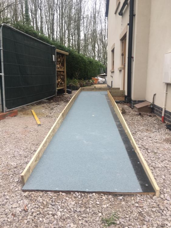

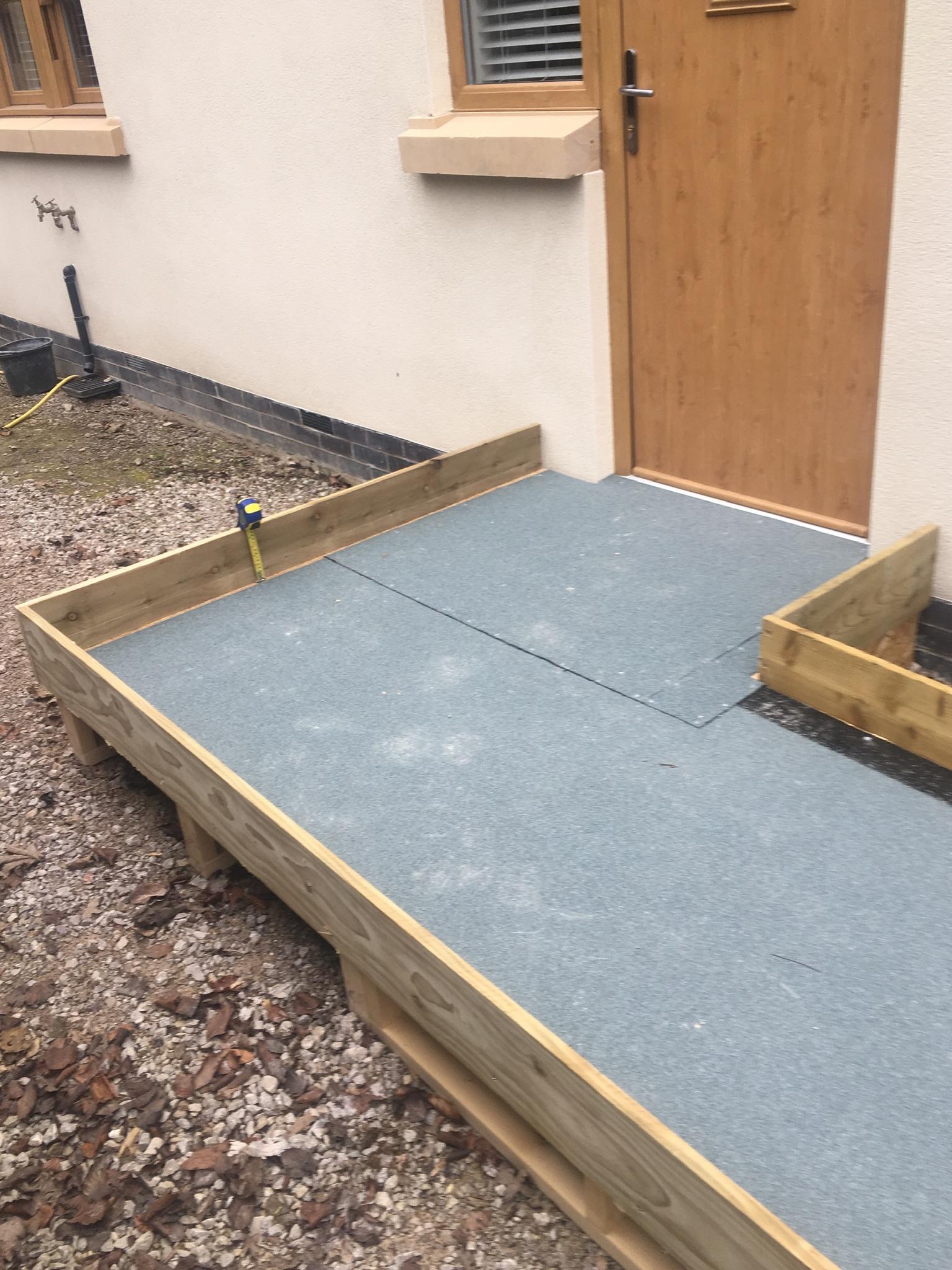

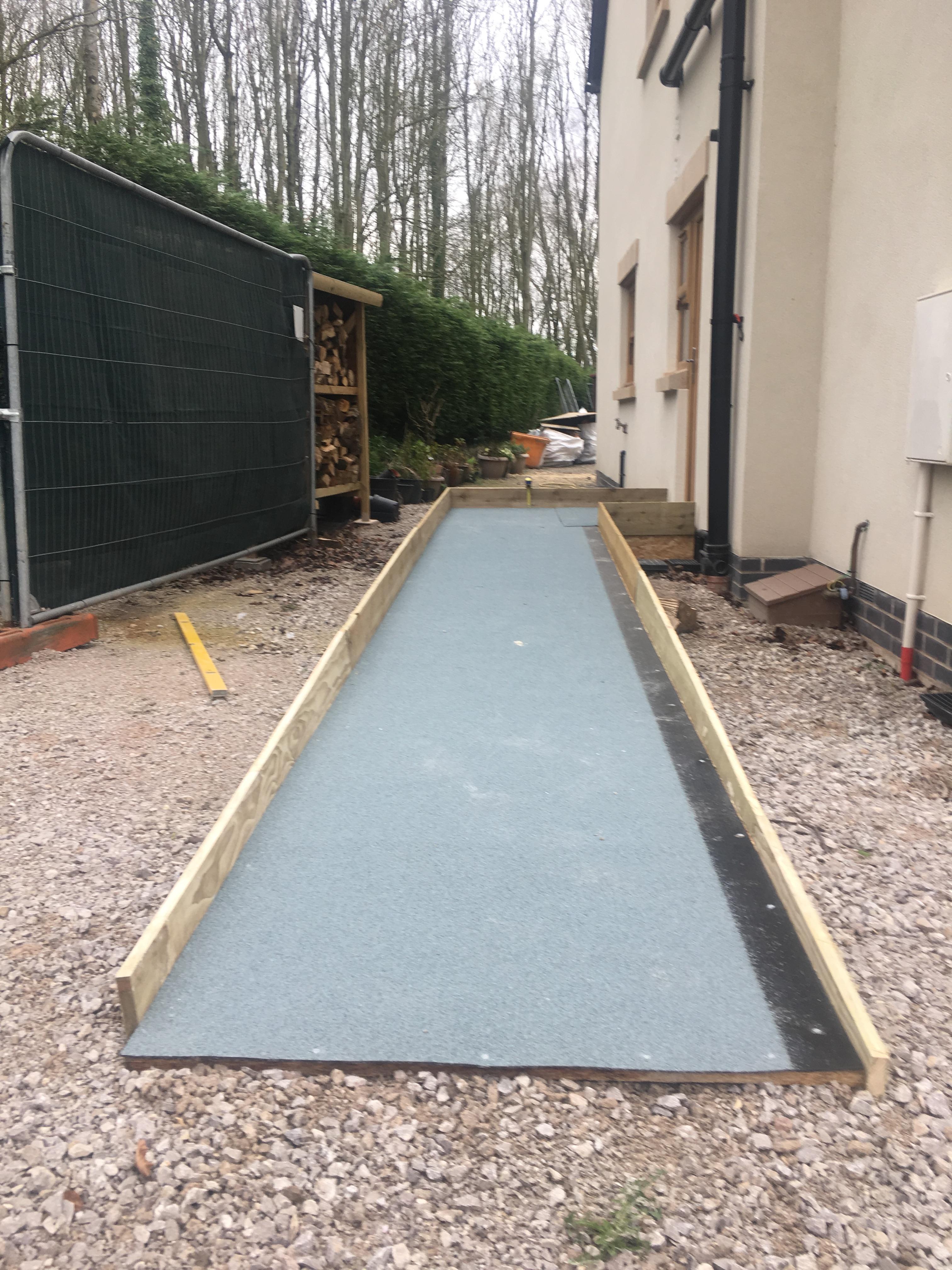

Thedreamer Posted September 1, 2020 Share Posted September 1, 2020 Our ramp construction started today! We have a suspended timber floor so a bit higher than most. Our building inspectors has okayed the use of timber for us. What he said to me was don't build a ramp that looks like you are planning to remove it as I drive away. ? I've had some Siberian Larch decking constructed this week and using the same stuff for the ramp. I'm building in Scotland where prehaps the disability access regulations might be different. Link to comment Share on other sites More sharing options...
ProDave Posted September 1, 2020 Share Posted September 1, 2020 BC up here would not pass something that is so obviously only temporary. 1 Link to comment Share on other sites More sharing options...
