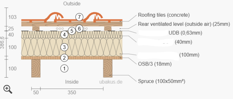

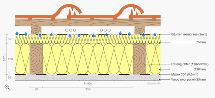

sgt_woulds Posted February 28, 2025 Posted February 28, 2025 I work for one of the woodfibre insulation manufacturers we’ve had a couple of similar questions regarding bats in the last few months – hopefully, this means there is an uptick in bat population, but it is awkward to specify a suitable breathable build-up. Below I have copied the relevant parts of some previous conversations FYI: Firstly, unlike spun fibre insulation, such as fibreglass or Rockwool, woodfibre insulation does not pose a direct threat to bats due to entanglement. However, speaking as an ex-roofer - and having seen what guano can do to structural elements, membranes, insulation and electrical cables - I’d recommend keeping them separate wherever practicable. There is a fundamental contradiction when considering the building fabric's breathability and ensuring a safe environment for bats. Breathability is critical for the building fabric, and the only way to achieve this in a risk-free scenario is to use an external layer that ensures water vapour can escape. So a breather membrane or vapour open board. However, the risks associated with long-term exposure to guano should not be underestimated. In volume, it can also pose a significant risk to the wood fibre and the structural timber. The use of a bituminous felt is therefore the recommended approach when roofing to ensure no potential trapping of the bats and to protect the structure. Of course, bituminous felt is non-breathable and hence not ideal for the building fabric. Creating a fully vented cavity below the felt can solve the breathability issues but you also need to vent this at the eaves, and ridge which is not straightforward when trying to ensure that bats can’t access this ventilation space. You could use TLX ‘Bat Safe’ breathable membrane as an alternative to Bitumen F1, but I’d be guided by the bat experts on this. I remember speaking to an ecologist on a job 15-20 years ago and they were critical of the testing procedures used to validate the membranes. This is not a fault of TLX, more that it is hard to test without using real bats! Hopefully, they’ve resolved any issues by now and I'd hope that they have some long-term monitoring data to confirm it's real world performance. You certainly shouldn’t use a standard breather membrane -I’ve stripped it off a roof where it was killing bats that got tangled in the threads and it was a sad sight. I’d still rather use the felt though. My gut feeling is it will stand up to the acid in the droppings better, but I only have personal experience to go on. I have, (unfortunately) dealt with many pigeon infestations where good old F1 felt stood up well to the muck, but on the job I had with bats and the breather membrane you could poke your finger through the membrane where the guano was removed. Going down the ventilated void route would sort breathability, but reduce available insulation depth. In addition, we always recommend a secondary water removal layer below felt as it can degrade over time, which makes the build-up more complicated. A more holistic approach may be to consider a non-vented build-up which allows breathability back to the inside. In this scenario, external ventilation is not critical, but overall performance should always be justified by a long-term hygrothermal analysis of the fabric, (via software such as WUFI which also considers external exposure, rain, shading, occupation and use, etc on a project-specific basis). As an example of a vapour closed approach, please see the build-up below, which may be an option with suitable analysis. This uses a woodfibre sarking board externally and woodfibre flex insulation between the rafters: In this simplified example, the U-value, based on an existing 120mm rafter, is 0.26W/m2K. You will see that there is condensation shown by the software, (U-bakus) - but, with full WUFI analysis, this may well be at a level that is not critical. SIGA, (and other manufacturers who produce moisture vapour-variable control membranes) will undertake a WUFI assessment if their membrane is used, so we have shown their Majrex 200 and would recommend this as an alternative approach which addresses some of the factors discussed above. [not shown in the diagram is the lime or clay plaster on the woodwool panels] Felt does degrade over time, (so do breather membranes) but in my experience, this is exacerbated by their own weight stretching the reinforcing fibres over time and under summer heat. Fully supported over a sarking board this should be less of an issue. Even if the felt does fail in 50-odd years time, then, (if you choose the right product) the woodfibre sarking can act as an additional weatherproofing layer with its hydrophobic surface coating. Using an external sarking board and counter battens as in this example will only raise the overall roof by 60mm which really only shows at the gable ends, and can again be ameliorated with architectural detailing. A conservation officer probably wouldn't even notice it on the finished roof from the ground unless you pointed it out to them. A practicable modification to the existing roof profile that allows for lowering CO2 emissions, protects the building structure, and allows a safe habitat for wildlife it is a compelling argument to use with planning and conservation officers, and ensures the building will be fit for use for many more years with minimal visual difference. Surely this is all they can ask for. In terms of ultimate U-values, this isn't the be-all and end-all in terms of thermal comfort, and building regs with older properties. For existing elements in existing buildings, Part L of the Building regs defines a threshold value of 0.35W/m2K for Roofs in certain conditions where it's not practical to achieve the modern requirements. Worth discussing with your BCO; for an older building, most BCOs are now sympathetic to the argument that breathability is more important than the insulation value. Woodfibre will also provide more decrement delay than unnatural insulations; summer heat protection is probably just as important these days as keeping warm in the short winter months. I suggest speaking to advisors at: Home | spab.org.uk and Historic England - Championing England's heritage | Historic England as they have experience with upgrading the thermal performance of old buildings whilst maintaining their architectural features and may have some case studies you can use. Can you provide links to the information about Batsafe membrane being unsafe for bats? I can only find historic 'concerns'.
Wil Posted February 28, 2025 Posted February 28, 2025 @sgt_woulds What an excellent and in-depth response, thank you. I take it the 35mm in your build up above is the wood fibre sarking board? The label appears to be missing. What stops condensation forming on the internal side of the felt membrane in your example above? This was an issue in my old loft when I pulled back the glass fibre insulation that had been stuffed between the rafters (badly)? I guess I need to understand the WUFI calculations properly. And my rafters are only 100mm to play with. Given the felt barrier, a cheaper way could be to use celotex over the rafters in place of the sarking boards- making the whole roof warmer? I’d happily have open rafters inside if it made things better! Sorry to answer with a whole raft of questions, I’m just fighting with the concept of mixing breatheable and non-breatheable materials on the roof and the horror stories you read on condensation. My only real references to TLX not being suitable are above in the thread, but I had read it elsewhere too. No recent or real worked experience, so if people are now happy that TLX isn’t murdering the flying squeakers, then all good and I’ll have to dip in for the expensive stuff! £16/m2 🤦

sgt_woulds Posted March 4, 2025 Posted March 4, 2025 It may be possible to use all insulation above the rafters - with a WUFI assessment to confirm that it works. I cannot stress that enough. Also, using woodfibre above the rafters would require a significant depth of insulation to achieve similar U-values to the example shown above - you would be using dense insulation boards throughout and these do not provide as good a U-value as the flexible woodfibre used between the rafters. Shown below is a build-up with U-value of 0.248 W/m2K: Here, the 18mm OSB3 is used without a VCL membrane and a UDB breathable membrane is used above the insulation. Ubakus doesn't have the TLX Batsafe listed, but this should provide a similar performance. Two layers of woodfibre are shown, 100mm of better U-value, and a layer of 40mm which has a hydrophobic coating to provide additional weatherproofing. In this case, the breather membrane is used as protection from the bats, otherwise it would not be required. If you can find the correct quality of OSB3, (unfortunately, not easy in the UK) it can be taped and sealed to provide both airtightness and vapour control. You could also use a VCL over the ply if required. Points to consider: Fixing Length – with this thickness of build-up the fixings would be a minimum of 220mm long. The fixing process needs to be exact to make sure that the fixing penetrates the centre of the supporting rafters. This can be difficult to achieve consistently with such long lengths. If a lower U-value is required then the overall build-up increases as does the screw length. Counter batten size – the counter batten and screw hold all the insulation in place and need to be designed to withstand any wind & snow loads and carry the weight of the external finishes. The counter batten width needs to be sufficient so that when the fixings pull into the structural frame, the batten doesn’t pull into the insulation layer; the woodfibre is relatively dense but this needs to be accounted for. Hence the fixing manufacturer, (e.g. HECO Topix Screws) must design a fixing methodology to consider all the following factors – wind load, snow load, exposure, insulation type, batten size etc. The same build-up using F1 felt and a V-VCL membrane will show moisture issues in Ubakus, but again, if you have it assessed by a WUFI expert you may find this is within acceptable levels. I suggest speaking to 'Mike Wye' or 'Back to Earth' as they have more real-world experience in their technical teams and will be able to advise accordingly. 1
