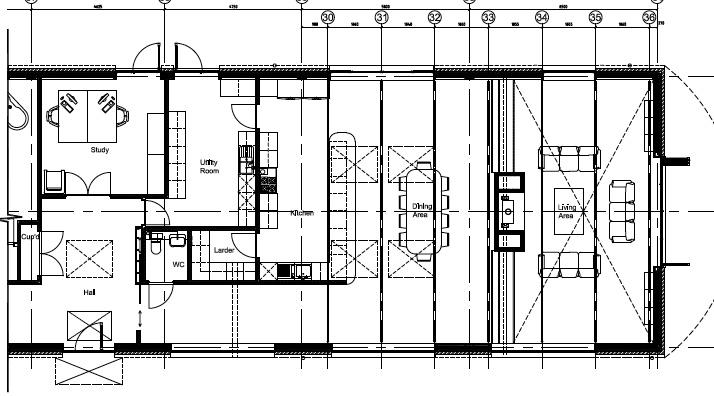

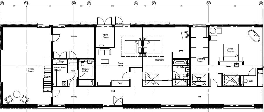

Wil Posted August 26, 2020 Share Posted August 26, 2020 (edited) Given the size of the property, what's the size of the heat pump? a 20kW heat pump will be using 5kW of electricity on full steam and if you run it with all the doors open (as per pics), it could easily be doing that. A HP is more efficient than chucking direct electric at the problem, but not if just left on. I'm tracking my consumption and our 5 bed farmhouse is currently averaging around 30kWh a day without any heating on! But we do charge an electric vehicle most nights which accounts for a decent chunk of that. Immersion for water and electric cooking account for most of the rest. The instantaneous and daily readings (particularly when it peaks and troughs) would be really helpful to understand where you're using the energy. Edit- sorry I meant to ask- does the business/ retreat form a separate meter from the house or is it all one property? Edited August 26, 2020 by Wil Link to comment Share on other sites More sharing options...

Claire B Posted August 26, 2020 Author Share Posted August 26, 2020 36 minutes ago, Wil said: Given the size of the property, what's the size of the heat pump? a 20kW heat pump will be using 5kW of electricity on full steam and if you run it with all the doors open (as per pics), it could easily be doing that. A HP is more efficient than chucking direct electric at the problem, but not if just left on. I'm tracking my consumption and our 5 bed farmhouse is currently averaging around 30kWh a day without any heating on! But we do charge an electric vehicle most nights which accounts for a decent chunk of that. Immersion for water and electric cooking account for most of the rest. The instantaneous and daily readings (particularly when it peaks and troughs) would be really helpful to understand where you're using the energy. Edit- sorry I meant to ask- does the business/ retreat form a separate meter from the house or is it all one property? Thanks for your reply. Yes its a 20kw heat pump. I don't run it with doors open! Heating is switched off in the summer, it will only be heating water. I am aware of possible issues with the design and configuration of the UFH system and have had 2 people round to look at it as it doesn't get the house up to temperature in the winter "the system appears to be consuming approx 3 times the amount of energy it should whilst failing to deliver the required space heating". Maybe I'll do a separate thread about this issue as time is running out if I'm going to sue, which I have been advised to do but I've had enough after years of battling to get to the end product. I don't have an immersion heater. I have been turning AGA off and then on daily to see if that helps but I'm not sure its more cost effective as it has to heat back up to temperature rather than just maintaining one constant temp. In the winter it will stay on all the time anyway and it helps heat the room (once the room is up to temperature the thermostat will stop calling for heat). Yoga studio is all part of the same property, only a couple of classes a day so really doesn't add much to electric cost and by renting the space out to teachers I'm getting a bit of income to help towards the bills. I'll start tracking daily usage again and see where we're at. Link to comment Share on other sites More sharing options...
