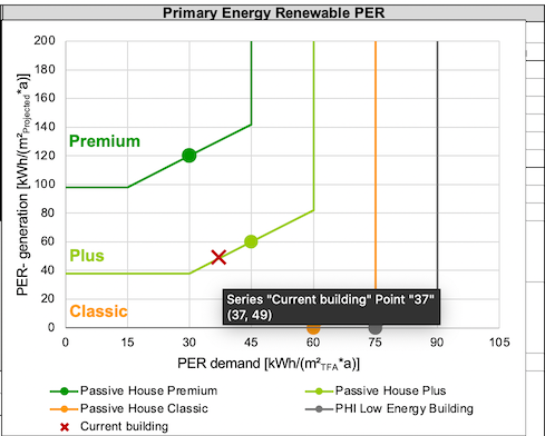

markharro Posted August 17, 2020 Posted August 17, 2020 We are in the early stages of planning to build a new house to the PH + standard. At the moment I am researching various incidental technical matters.
markc Posted August 17, 2020 Posted August 17, 2020 Good morning and welcome, Looks like we are in pretty much the same situation, do you have the plot already? what area? hopefully i will have a plot in the not too distant future and design can start properly
markharro Posted August 17, 2020 Author Posted August 17, 2020 Thanks. Yes we have the plot (and existing house) in Edinburgh. How much research have you done so far? I am still trying to get my head around the issues surrounding the massive PV installation needed and how you confer with your local grid company to a) check they can deal with the export and b) find out how costly any upgrade to the infrastructure might be - which presumably the house-owner would have to deal with?
A_L Posted August 17, 2020 Posted August 17, 2020 (edited) On 17/08/2020 at 09:22, markharro said: I am still trying to get my head around the issues surrounding the massive PV installation needed Expand IIRC Passivhaus Plus uses footprint (not floor area) to calculate energy generation requirement. So a 100m2 footprint would require 6000kWh/annum. Even in sunny Edinburgh that is only 7-8kWp. You would probably only fit an inverter of 6kW anyway. The greater part load efficiency more than makes up for the slight loss on rare perfect days. Inverters which limit export are now available. If you could arrange for the panels to have two orientations this would further limit peak output. If your requirement is considerably larger then 3-phase, when 11.04kW can be exported without concern might be an option. You might find this discussion informative - https://www.navitron.org.uk/forum/index.php?topic=29370.0 Edited August 17, 2020 by A_L minor typos

Dan F Posted August 17, 2020 Posted August 17, 2020 It's projected footprint of rooms within thermal envelope. This means an integral garage with no room above is excluded, but any first floor overhangs have to be included. The exact amount of PV you need is based on PER. If your PER is less than 45 kWh/(m²a) you don't actually need a full 60 kWh/m²AProjected*a. We are also targeting PH+ and these are our numbers: Heating Demand: 11kW Treated Floor Area: 305m2 Projected footprint: 208m2 PER: 30 kWh/(m²a) PV required: 38 kWh/m²AProjected*a.) = 7904kWh/yr In our case (south-east england) and ignoring shading (which is minimal anyway) this requires 27 x 360W panels split over east/south/west roofs. Regarding DNO and export, this really comes down to what you grid is like locally. For 10kW in our area we have the option to use single phase or three phase, but we've decided to go with a three-phase inverter because the bungalow we knocked down already had a three phase supply. You can apply for what you'd ideally want to do and then work backwards from there with most DNO's. Also some DNO's have a online map which will give you a rough idea. e.g. https://www.ssen.co.uk/generationavailability/ 1

markharro Posted August 22, 2020 Author Posted August 22, 2020 Wow first of all thanks for all the contributions to my post. I had no idea this forum would be so active or knowledgeable. My problem is that I can see that my own knowledge is totally rudimentary reading through some of the replies. I need much simpler explanations. If it helps our internal floor area is planned to be around 180 m2. PH+ was my idea rather than our architect's and I have modelled my thinking on this built project in England - https://www.bere.co.uk/architecture/lark-rise/?acceptCookies=5f40eb7ebbf92 There is lots of data on this on the architect's website. Its further south than us but from memory about the same sort of size we hope to build; it has a 12.4 kWp PV array and a Tesla Powerwall battery. Given our more northern latitude I assumed that we may need a bigger array eg 14kw or so? I have to say that I am now a bit puzzled by Dan F's comments that he is planning on 27 x 360W panels ie around 10kW for a substantially bigger house! Can anyone comment in simple terms on how my logic might be out? On a separate point, my thinking was that to make things affordable sourcing used or budget panels might be the only way we could afford the 50/60 that would be needed for an array totalling around 14kW. Has anyone experience of using this (German) site to source used panels - https://www.secondsol.com/en/index.htm - as it seems possible to buy very cheap panels by the palletload from them! thanks
A_L Posted August 22, 2020 Posted August 22, 2020 On 22/08/2020 at 10:05, markharro said: Can anyone comment in simple terms on how my logic might be out? Expand 1) PH uses external dimensions, so if your house is a regular detached house with 90m2 of internal floor area per floor it is likely to have a footprint of around 105m2 which implies a maximum generation of 6300kWh per year which is easily achievable with 7.5kW of PV. 2) This for a PH+ house with the maximum energy use allowed (PER of 45kWh/m2 /yr). IIRC if it has a lower value the energy generated can be proportionately reduced. 3) There are panels in the U.K. for 30p per Watt e.g. https://midsummerwholesale.co.uk/

Dan F Posted August 23, 2020 Posted August 23, 2020 (edited) On 22/08/2020 at 10:05, markharro said: have to say that I am now a bit puzzled by Dan F's comments that he is planning on 27 x 360W panels ie around 10kW for a substantially bigger house! Can anyone comment in simple terms on how my logic might be out? Expand How much generation you need to meet PH+ depends on your PER, and isn't fixed. Lark Rise has a PER of 37kWh/m2.yr so needs 48 Wh/m2.yr in generation (see below). That said, they installed 79kWh/m2.yr, so around 60% more than they needed for certification. How the PH+ requirement translates into a PV array size will depend on area of country, orientation of roof, pitch and any shading though. So you know what you projected area will be, your roof area/type or any of this yet? Also, you should think about array size based on expected usage and not just certification if possible. Edited August 23, 2020 by Dan F
