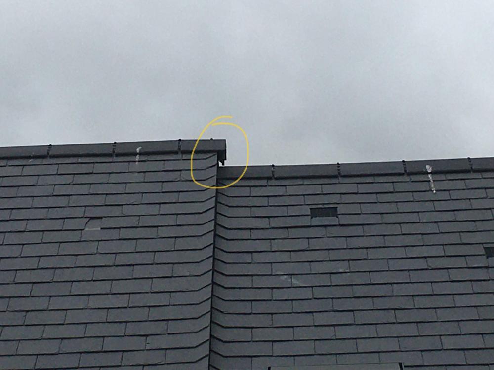

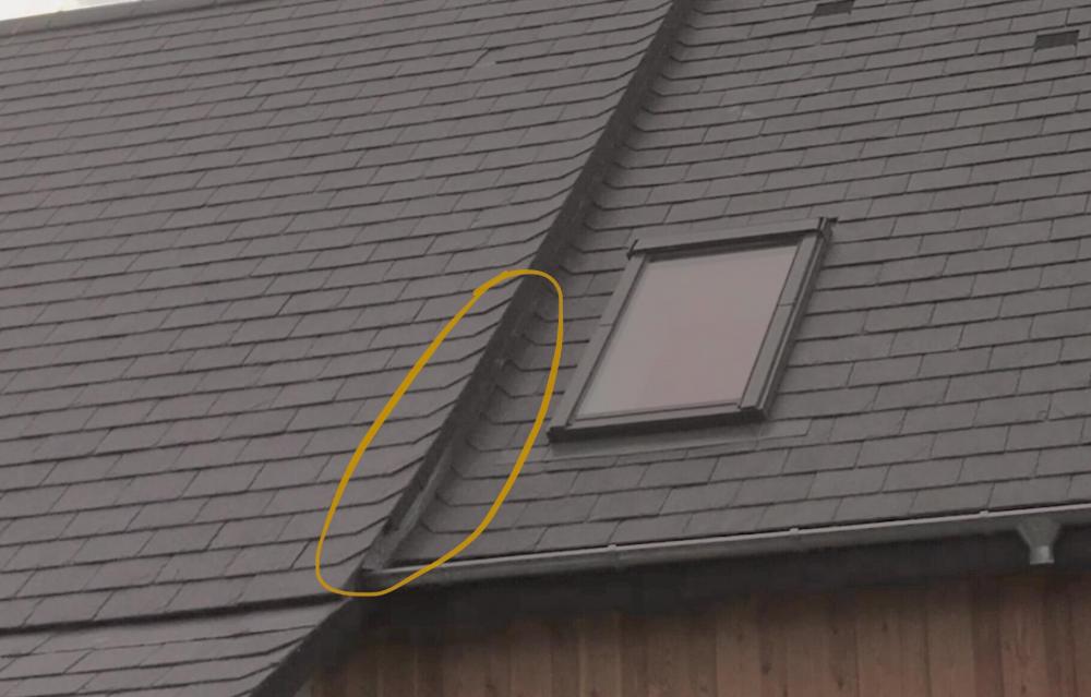

Bozza Posted August 14, 2020 Posted August 14, 2020 The scaffolding is just coming down on my self build. I’ve noticed the roofer has clipped the end roof slates at 45 degrees. Has anyone seen this before or know any reason for doing it? It creates an optical illusion that makes the rook look like it curves up at the end. The site is quite exposed (NE Scotland) to wind so just wondering if it’s something to do with that. pic attached.
nod Posted August 14, 2020 Posted August 14, 2020 I’ve seen this before and wondered why Looks ok though
Bozza Posted August 14, 2020 Author Posted August 14, 2020 My best guess would be that un clipped corners would be susceptible to snapping In high winds, but I’ve seen loads of slate roofs without this feature. I’m sure someone here will know for sure. The slaters were subbied by my builder and awaiting their response but that may take a while.
joe90 Posted August 14, 2020 Posted August 14, 2020 I was told this is to stop water tracking down the edge and on to the gable end. 1
Bozza Posted August 14, 2020 Author Posted August 14, 2020 7 minutes ago, joe90 said: I was told this is to stop water tracking down the edge and on to the gable end. Ahhhh I see, that would make sense, drips would run down the 45 cut corner back toward the roof. But wonder why this is not done on all slate roofs.
joe90 Posted August 14, 2020 Posted August 14, 2020 1 hour ago, Bozza said: But wonder why this is not done on all slate roofs. some roofs tilt the end tiles up a little to have the same effect, my slate roof is a hip roof so not done, next time I see my roofer I will ask him.
makie Posted August 14, 2020 Posted August 14, 2020 1 hour ago, Bozza said: Ahhhh I see, that would make sense, drips would run down the 45 cut corner back toward the roof. But wonder why this is not done on all slate roofs. I've only done it on a few jobs and it's usually when requested by the client or architect
Bozza Posted August 14, 2020 Author Posted August 14, 2020 (edited) 6 minutes ago, makie said: I've only done it on a few jobs and it's usually when requested by the client or architect ok Makie so is it for water tracking as Joe90 was told, or some other practical purpose, or is it purely a style / look thing ? Edited August 14, 2020 by Bozza
makie Posted August 14, 2020 Posted August 14, 2020 15 minutes ago, Bozza said: ok Makie so is it for water tracking as Joe90 was told, or some other practical purpose, or is it purely a style / look thing ? Water tracking was what we were taught during my apprenticeship. Looks nicer to me tbf

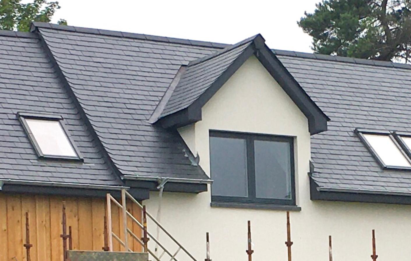

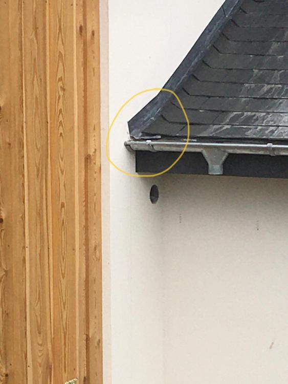

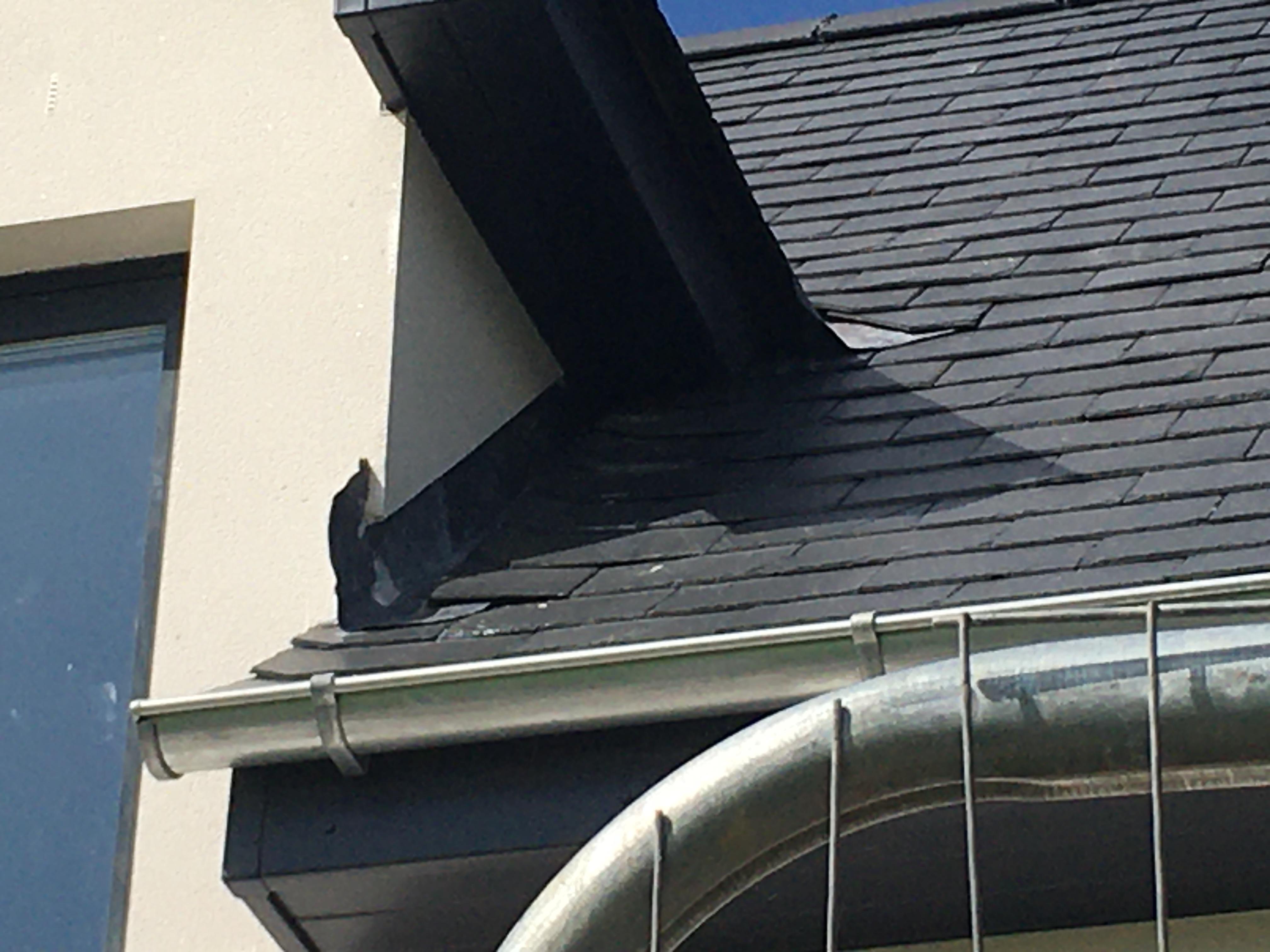

Bozza Posted August 17, 2020 Author Posted August 17, 2020 On 14/08/2020 at 22:44, makie said: Water tracking was what we were taught during my apprenticeship. Looks nicer to me tbf Makie, you said earlier that clipping the end tiles was when asked for by client / architect and also explained about water tracking. Is it the case that When it’s asked for, It’s for tracking, or just for how it looks and it helps tracking. Just trying to understand why it was done on my house by the roofers, when not asked for to be done. Namely would they do it automatically for functionality. also your opinion kind sir of the attached flashing detail at the dormer.

makie Posted August 17, 2020 Posted August 17, 2020 3 hours ago, Bozza said: Makie, you said earlier that clipping the end tiles was when asked for by client / architect and also explained about water tracking. Is it the case that When it’s asked for, It’s for tracking, or just for how it looks and it helps tracking. Just trying to understand why it was done on my house by the roofers, when not asked for to be done. Namely would they do it automatically for functionality. also your opinion kind sir of the attached flashing detail at the dormer. It might just be the way the roofers were taught. Lead should be dressed around the corner and under the slate at the bottom of the watergate to allow it to sit down more.
Bozza Posted August 17, 2020 Author Posted August 17, 2020 (edited) Roofing / slating is one of a number of things I definitely don’t know too much about so Thanks for your replies folks. So it seems the consensus is that clipping slate is something that is done by some roofers mainly as a design thing but perhaps more likely in Scotland as it has a function benefit (Though not essential) for water tracking. And that they’ve done a good slating job on my house. But that the lead work at the dormer needs remedial action. Wonder why if the slating has been done to a good standard, why the lead work hasn’t. Doesn’t make sense. Edited August 17, 2020 by Bozza
makie Posted August 18, 2020 Posted August 18, 2020 16 hours ago, Bozza said: Roofing / slating is one of a number of things I definitely don’t know too much about so Thanks for your replies folks. So it seems the consensus is that clipping slate is something that is done by some roofers mainly as a design thing but perhaps more likely in Scotland as it has a function benefit (Though not essential) for water tracking. And that they’ve done a good slating job on my house. But that the lead work at the dormer needs remedial action. Wonder why if the slating has been done to a good standard, why the lead work hasn’t. Doesn’t make sense. Lead work was always a plumbers job, then roofers started doing it on sites so they could get the job done without waiting for a plumber. Most roofers aren't very good when it comes to lead.

Bozza Posted August 21, 2020 Author Posted August 21, 2020 For those who contributed to this I spoke to my project manager re this today. So regarding the dormer flashing /lead work he said it’s not finished and will be flattened and squared, nothing to worry about. Re the clipped tiles he said it was purely a design thing and because I never asked for it No bother to change it back to unclipped tiles if I’d prefer. He said it takes quite a bit of time to clip them like that but ultimately I’m the client and if I want them replaced no bother at all. He reassured me that they weren’t cutting corners or anything, I replied that’s literally exactly what they were doing. I was chuffed with that gag and so was he. Luckily I have a good pm / building company. 1
