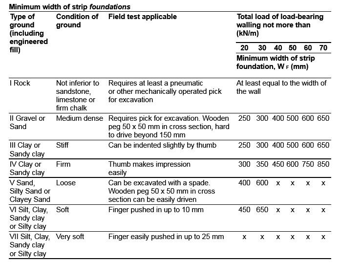

A_L Posted August 10, 2020 Share Posted August 10, 2020 @SuperJohnG, is this any help? - Small Building Structural Guidance (1.C.6) - https://www.gov.scot/binaries/content/documents/govscot/publications/advice-and-guidance/2020/02/the-small-buildings-structural-guidance/documents/small-buildings-structural-guidance/small-buildings-structural-guidance/govscot%3Adocument/Small%2BBuildings%2BStructural%2BGuidance%2B%2B.pdf 1 Link to comment Share on other sites More sharing options...
SuperJohnG Posted August 10, 2020 Author Share Posted August 10, 2020 2 hours ago, A_L said: @SuperJohnG, is this any help? - Small Building Structural Guidance (1.C.6) - https://www.gov.scot/binaries/content/documents/govscot/publications/advice-and-guidance/2020/02/the-small-buildings-structural-guidance/documents/small-buildings-structural-guidance/small-buildings-structural-guidance/govscot%3Adocument/Small%2BBuildings%2BStructural%2BGuidance%2B%2B.pdf Thats definitely helpful. Thanks @A_L Helps me define the conditions. Link to comment Share on other sites More sharing options...
the_r_sole Posted August 10, 2020 Share Posted August 10, 2020 8 minutes ago, SuperJohnG said: Thats definitely helpful. Thanks @A_L Helps me define the conditions. You can't really use the small buildings guidance any more tbh, you'll need an SER cert to accompany your warrant application and its only the se who can tell you what si is required - the original question about soil testing isn't addressed in the small buildings guidance... Link to comment Share on other sites More sharing options...
SuperJohnG Posted August 10, 2020 Author Share Posted August 10, 2020 30 minutes ago, the_r_sole said: You can't really use the small buildings guidance any more tbh, you'll need an SER cert to accompany your warrant application and its only the se who can tell you what si is required - the original question about soil testing isn't addressed in the small buildings guidance... But it gives me an idea of what soli beating pressures are whichnis really what I want to know. Ultimately if I have to give someone 1k I want to knkw what they are undertaking and how technical it is to warrant the money. Sticking your thumb in some mud shouldn't need someone to charge 2k. In reality ill get the SI done to get an input for tanners to design the foundation system. Then as you say the SER SE will include it. I should maybe xheck what they require as its a different engineer (likely the one doing the superstructure) It's, as many things I have found in the housebuilding, a very wooly process where there is no defined rules. Which ours me somehwat out my comfort zone, I'm a Chartered Mech engineer and driven by process and value add. So if there is a need for soemthing I like to know its justified and why it is required. Link to comment Share on other sites More sharing options...
