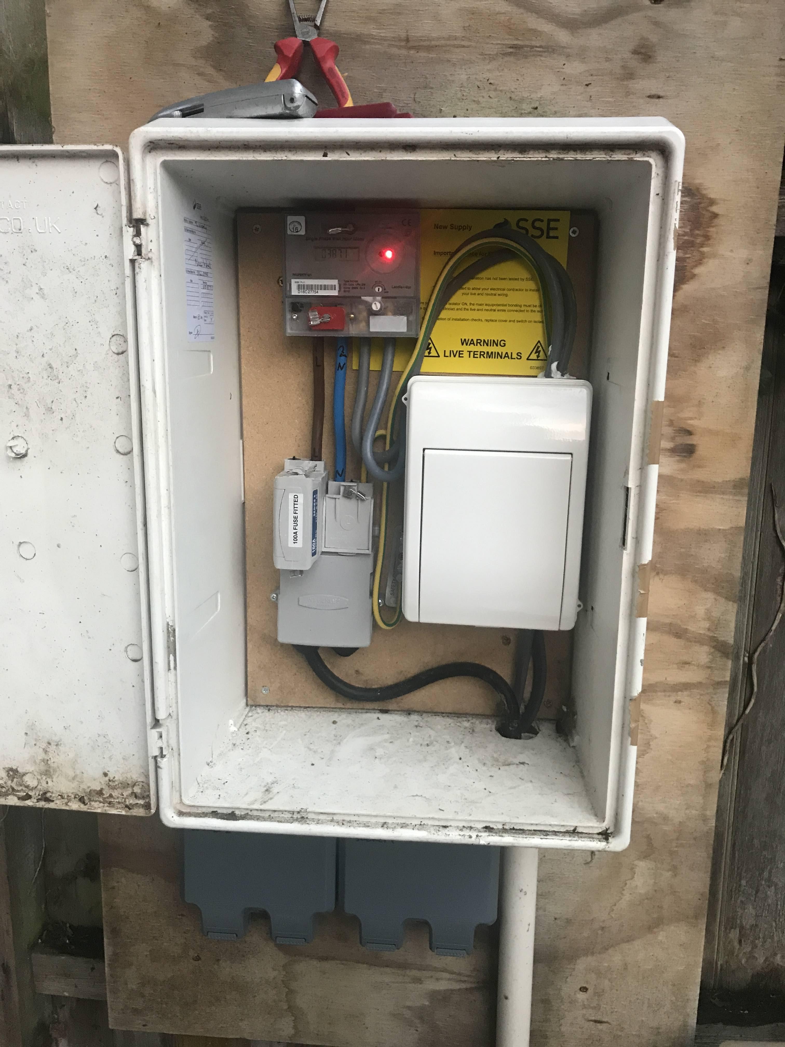

Dreadnaught Posted September 14, 2020 Author Posted September 14, 2020 Just now, soapstar said: Perhaps I have read it wrong however do you mean to have your meter installed in this box with your consumer unit in your house? Is this allowed? Yes, I now have a meter installed in the meter box shown in the photo (and two pairs of all-weather sockets beneath). When I have built my house, I will add a 80A fuse and run a cable underground about 15 metres to the plant room in my house, which will contain a second CU for the electrical distribution around the house. I believe it is OK, yes, but I am no expert and am following advice from this forum. I believe it is the 80A fuse that is key in this set up. 1

Dreadnaught Posted September 14, 2020 Author Posted September 14, 2020 @soapstar, here is a photo of the meter box with the meter, mini CU, and all-weather sockets beneath. 1
PeterW Posted September 14, 2020 Posted September 14, 2020 2 minutes ago, Dreadnaught said: @soapstar, here is a photo of the meter box with the meter, mini CU, and all-weather sockets beneath. Is that only temporary ..? Or will the main house run off that sub main board ..??
soapstar Posted September 14, 2020 Posted September 14, 2020 4 minutes ago, BotusBuild said: Soapstar, that is a very common setup - some have two meter boxes, one as above plus the meter in it and the other with the CU and feeds off to other locations. 3 minutes ago, Dreadnaught said: @soapstar, here is a photo of the meter box with the meter, mini CU, and all-weather sockets beneath. Thats interesting thanks. It must be an old fashioned thing to have the entire meter box on the house now! So regarding our setup does this mean then that we don't actually need SSE to extend our supply cable given the meter can be housed in the box 20 metres away? Obviously fused as you say then running the cable under the ground and into the garage? Any advice on the gauge of cable?
Dreadnaught Posted September 14, 2020 Author Posted September 14, 2020 (edited) 6 minutes ago, PeterW said: Is that only temporary ..? Or will the main house run off that sub main board ..?? The meter box is temporary but the location will be the permanent location for the meter and the "main" CU. At the end of the build, I intend to replace this unsightly plastic meter box with something rather more attractive, perhaps one of those green metal kiosks or perhaps a brick cabinet. At this location, I also intend to be a EV charging point too. 2 minutes ago, soapstar said: So regarding our setup does this mean then that we don't actually need SSE to extend our supply cable given the meter can be housed in the box 20 metres away? Obviously fused as you say then running the cable under the ground and into the garage? Any advice on the gauge of cable? Wisely, I will let those more knowledgeable than me answer that. Edited September 14, 2020 by Dreadnaught

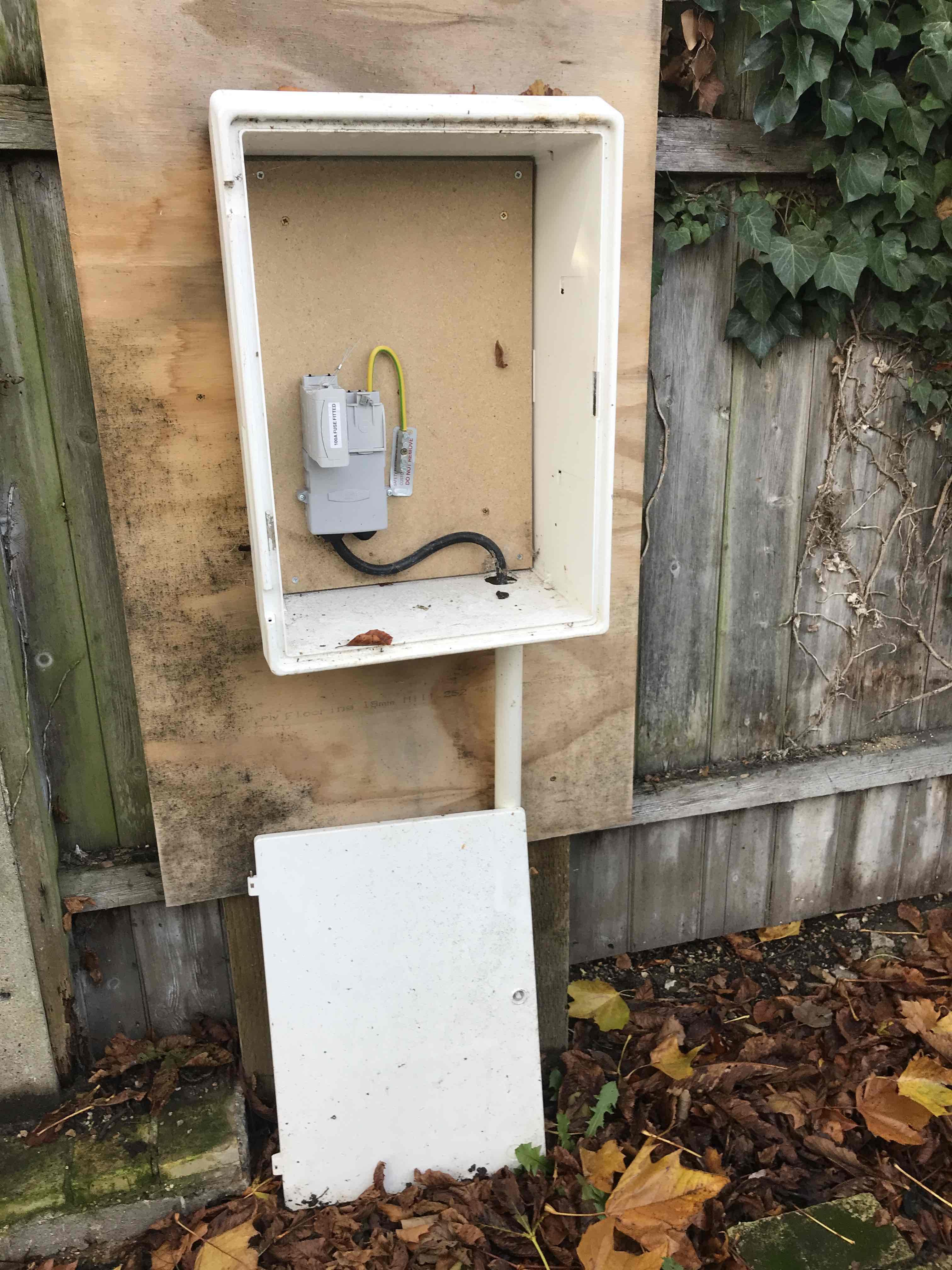

soapstar Posted September 14, 2020 Posted September 14, 2020 @Dreadnaught yes we would definitely go down the route of building a more permanent box. As like yours our door has also fallen off ? Will have to investigate further regarding who moves the fuse - but hopefully this isn’t required! Fingers crossed
