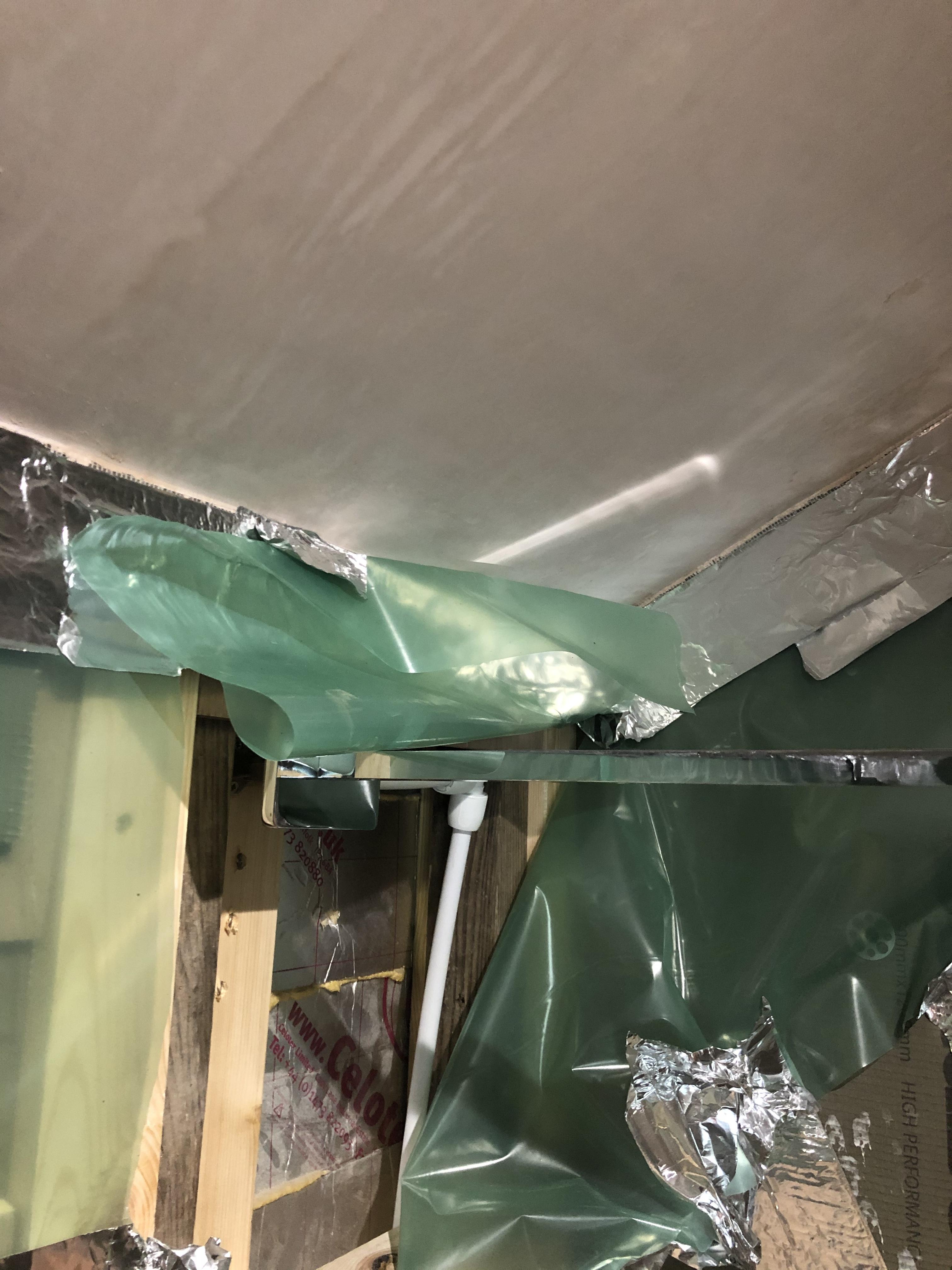

Onoff Posted August 4, 2020 Posted August 4, 2020 2 minutes ago, pocster said: Put water through on the cold feed only . Lots of knocking - assume air in pipe ? Have a leak on one of the brass fittings - so will fix that first . Does the mixer need hot and cold simultaneously ? I.e prevent the knocking ? . I have no hot available but could stick cold on the hot feed ... I have a feeling that the more "right angle" bends you have and less sweeping curves, the more knocking you are prone to.
PeterW Posted August 4, 2020 Posted August 4, 2020 Is your hot pipework not connected ..? Or do you mean you have it all connected but it’s not hot ..?
Russell griffiths Posted August 4, 2020 Posted August 4, 2020 You need to flush it through take off the capped ends and run it for a while, don’t cap them first or your just testing if it’s air proof. I think you should change that pipe work it looks proper shit (sorry) dont rush and bodge at the last leg. If the shower head head is too low stick one on the ceiling. C,mon lad do it right.
Pocster Posted August 4, 2020 Author Posted August 4, 2020 15 minutes ago, PeterW said: Is your hot pipework not connected ..? Or do you mean you have it all connected but it’s not hot ..? Hot not connected
Pocster Posted August 4, 2020 Author Posted August 4, 2020 3 minutes ago, Russell griffiths said: You need to flush it through take off the capped ends and run it for a while, don’t cap them first or your just testing if it’s air proof. I think you should change that pipe work it looks proper shit (sorry) dont rush and bodge at the last leg. If the shower head head is too low stick one on the ceiling. C,mon lad do it right. You mean the nasty 2 90 tees ? Can’t see another way of doing it . Runs too short . Pipe not flexible enough
Pocster Posted August 4, 2020 Author Posted August 4, 2020 24 minutes ago, Onoff said: I have a feeling that the more "right angle" bends you have and less sweeping curves, the more knocking you are prone to. It’s all curves up until the mixer as it’s a single run per feed with no joints .
Pocster Posted August 4, 2020 Author Posted August 4, 2020 Just vaguely remember @Nickfromwales saying not to attenuate flow with the manifold . Not on site at the mo - but possible manifold tap not completely open ...
PeterW Posted August 4, 2020 Posted August 4, 2020 That last pipework to the outlet is a bit crap and will cause air to get trapped. You can get a straight Hep2O to BSP connector, then use a couple of elbows downward.
Pocster Posted August 4, 2020 Author Posted August 4, 2020 27 minutes ago, PeterW said: That last pipework to the outlet is a bit crap and will cause air to get trapped. You can get a straight Hep2O to BSP connector, then use a couple of elbows downward. Sorry you’ve lost me . The fitting on the mixer is bsp to hep20
Pocster Posted August 4, 2020 Author Posted August 4, 2020 I’ll order some 135 see if that helps Shower head can’t be ceiling mounted as ceiling on an incline
Pocster Posted August 4, 2020 Author Posted August 4, 2020 Decided therefore to test the shower head . Indeed opening the manifold did seem to alleviate the knocking . One thing I noticed is that with the shower set to fully off a small trickle still runs through the shower head . Can’t see any obvious adjustment for this ...

Nickfromwales Posted August 4, 2020 Posted August 4, 2020 1 hour ago, pocster said: Just vaguely remember @Nickfromwales saying not to attenuate flow with the manifold . Not on site at the mo - but possible manifold tap not completely open ... Yup. Open 100% or shut 100%. 1

Pocster Posted August 4, 2020 Author Posted August 4, 2020 10 minutes ago, Nickfromwales said: Yup. Open 100% or shut 100%. See ! I do listen and retain sometimes . 1

Pocster Posted August 4, 2020 Author Posted August 4, 2020 (edited) I forgot how much brass fittings like to leak . Each fitting should come with its own roll of ptf tape . Maybe in the distant future all mixers / taps etc. are hep20 ready ... ? Edited August 4, 2020 by pocster
Onoff Posted August 4, 2020 Posted August 4, 2020 Just now, pocster said: I forgot how much brass fittings like to leak . Each fitting should come with its own roll of ptf tape . Maybe in the distance future all mixers / taps etc. are hep20 ready ... ? Not enough turns of tape then, simples. I was amazed when @Nickfromwales said to put 25 odd turns on a bib tap back plate. Works like a dream. 1
Pocster Posted August 4, 2020 Author Posted August 4, 2020 Just now, Onoff said: Not enough turns of tape then, simples. I was amazed when @Nickfromwales said to put 25 odd turns on a bib tap back plate. Works like a dream. Yeah . I got to 10 and thought that was ridiculous. Seems ok now - will leave overnight and see .

PeterW Posted August 4, 2020 Posted August 4, 2020 14 minutes ago, pocster said: I forgot how much brass fittings like to leak . Each fitting should come with its own roll of ptf tape . Maybe in the distant future all mixers / taps etc. are hep20 ready ... ? Shouldn't need that much unless it’s a poor quality brass fitting ..?? If you’re desperate you could always make them off with a smear of LSX too. Have you used a stem elbow into the shower fitting then once you’ve converted it to a Hep2O socket ..??
