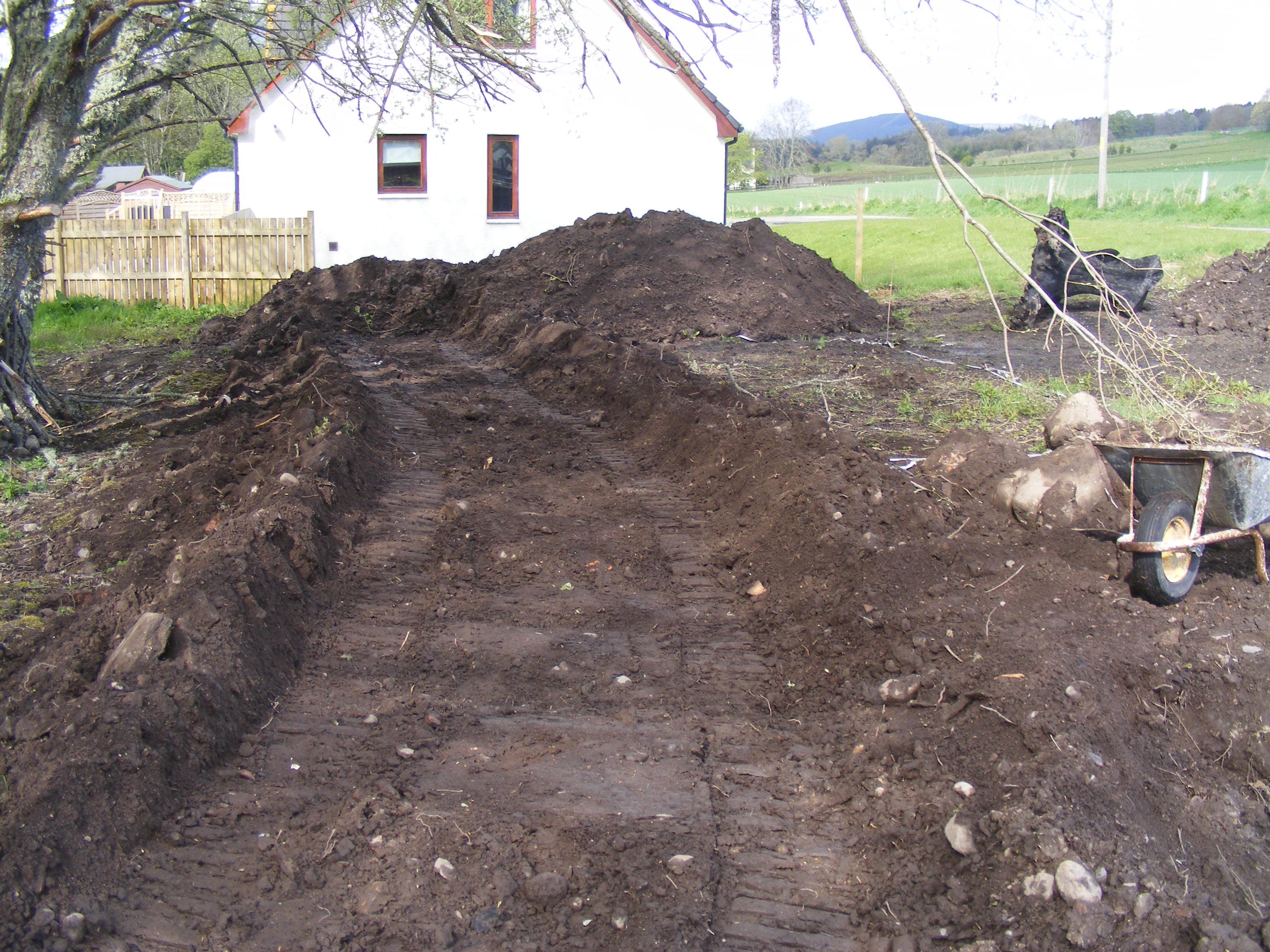

Tony K Posted July 26, 2020 Share Posted July 26, 2020 Hi My plot is 15m x 12m and I need to reduce it by about 60cm. Access is tight so I will be using a mini digger, but I can get the muck lifted away from a corner of the site. I've used a digger before but not for this purpose. Is there a best way to reduce the level whilst piling the spoil in one corner? I've considered digging the whole site down 20cm at a time so I can use the little bulldozer thing on the front of the mini digger to push the spoil into the corner. Alternatively, I could dig down 60cm at a time and pile up the spoil next to where I'm digging. Whether I could push that much spoil into the far corner of the site or not I don't know. Other options include hiring a skid steer or a track dumper. Any insights into how an experienced driver would approach the task? Link to comment Share on other sites More sharing options...

Tony K Posted July 27, 2020 Author Share Posted July 27, 2020 The actual access to the site is via an 80m long, 1m wide footpath. The attached photo shows where small muckaway trucks can get down to the far end of the adjacent private cul de sac to collect muck from the edge of my site. The muck will be piled up where the shed is in the photo. I doubt the little muckaway trucks could deliver a big digger or dumper over the fence so I'll use the long footpath to get a mini digger and dumper to site. Link to comment Share on other sites More sharing options...
scottishjohn Posted July 27, 2020 Share Posted July 27, 2020 (edited) plan with dimensions ? so this house will have no vehicular access when finished?-just a foot path of 1m wide. that is shared access. and surrounded by neighbours good luck with that -- you can forget working at weekends or at night --they will be complaining and getting you stopped by council and having you restricted to normal working hours for making noise not really trying to upset you have you had a valuation by estate agent of value of this house when built and ease of selling it you may want to do that now and see if it is worth doing ? Edited July 27, 2020 by scottishjohn Link to comment Share on other sites More sharing options...
Thedreamer Posted July 27, 2020 Share Posted July 27, 2020 7 hours ago, Tony K said: The actual access to the site is via an 80m long, 1m wide footpath. The attached photo shows where small muckaway trucks can get down to the far end of the adjacent private cul de sac to collect muck from the edge of my site. The muck will be piled up where the shed is in the photo. I doubt the little muckaway trucks could deliver a big digger or dumper over the fence so I'll use the long footpath to get a mini digger and dumper to site. Are you on good terms with the neighbours? I would imagine as well as the noise, tight access and distance to the road you will have to keep that pretty clean if used by others. It might also need to be tarred when finished from damage during the build. Link to comment Share on other sites More sharing options...
