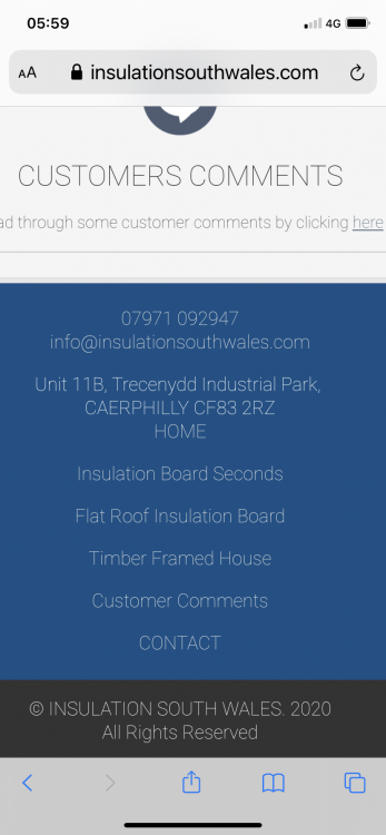

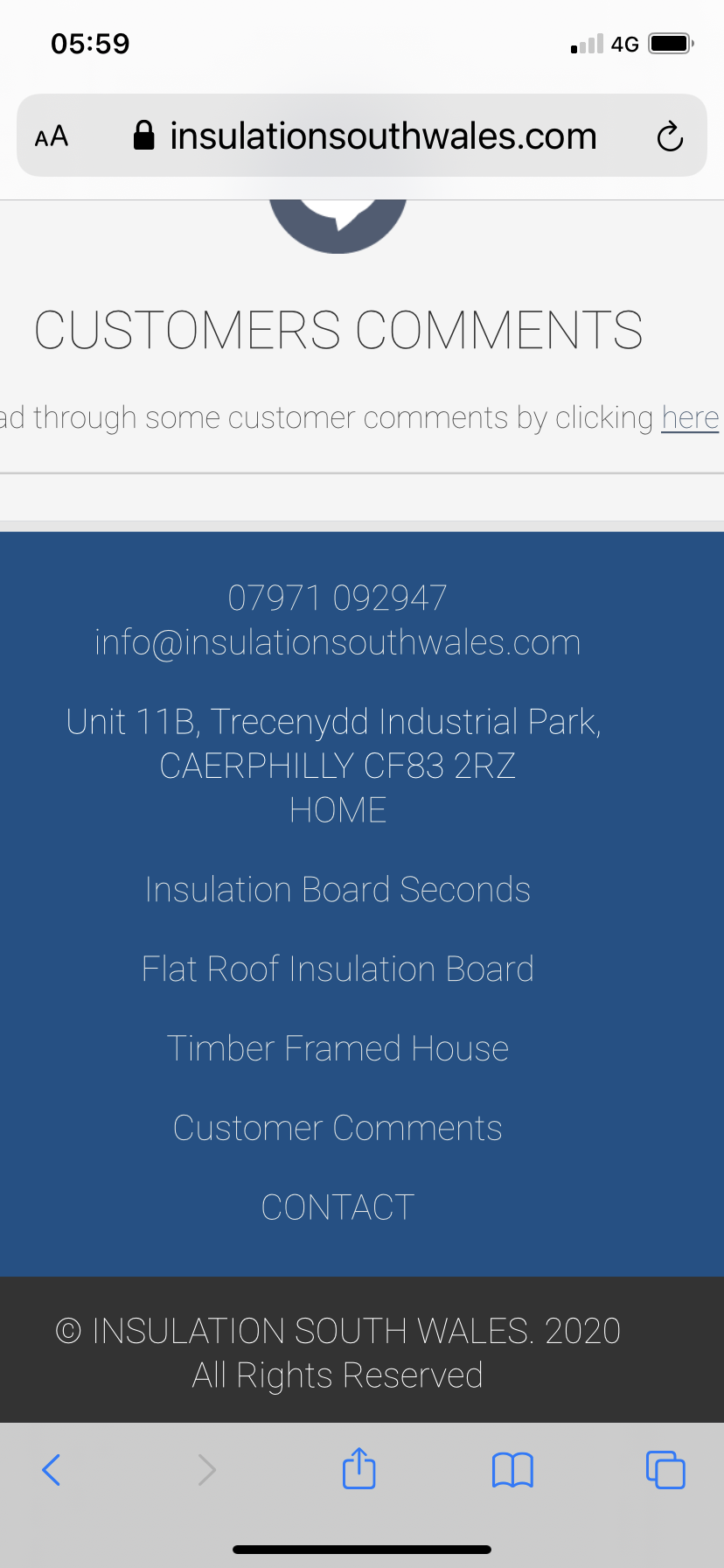

Patrick Posted August 6, 2020 Posted August 6, 2020 19 hours ago, dnb said: Hence my original comments about an HGV to Wales! I didn't know about the seconds place near Cardiff. Please could you share the name? A & A Insulation Service Ltd Unit G4, 5 The Willowford, Treforest, Pontypridd CF37 5YL 01443 209585 https://maps.app.goo.gl/U8NUvPn2R1jRg3mB8 I think it's the place. Huge warehouse full of seconds. 1
ADLIan Posted August 6, 2020 Posted August 6, 2020 A&A in liquidation. Now morphed into Insulation South Wales with same owner. Draw your own conclusions. Not sure why anyone would use seconds in a floor (or elsewhere) especially in a self build, life time home. Variation in thickness may give voids in a floor system, made worse if used in multiple layers. What if the reason for being second quality is low compressive strength???? Worth noting also that if second quality product it will not be covered by BBA certificate or comply with Relevant BS.
