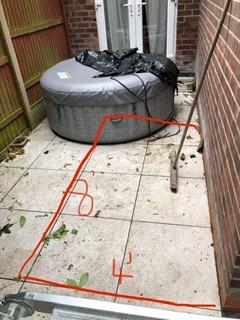

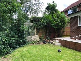

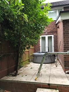

daiking Posted July 26, 2020 Author Posted July 26, 2020 This is the space I have. (The hot tub doesn’t usually live there, I’m waiting for a dry day to clean it and put it away) There’s room for a 8’x4’ shed (tiles are 600 x 600) with plenty of space to open the french doors and approx 800mm down the side. I won’t be able to use the French doors for access - that’s my wife’s treatment room but that’s where power will be coming from. The Laurel is in the way and to be honest not doing anything for us. It’s run away in height and covered in a neighbour’s climber of some sort. It just got left and we worked around it. I’m tempted to chop it down and put something else there. We’d love a Ceanothus in the garden but it’s too shady there.
Onoff Posted July 26, 2020 Posted July 26, 2020 26 minutes ago, daiking said: The Laurel is in the way and to be honest not doing anything for us. I believe they're quite hardy? 1
daiking Posted July 26, 2020 Author Posted July 26, 2020 5 minutes ago, Onoff said: I believe they're quite hardy?
