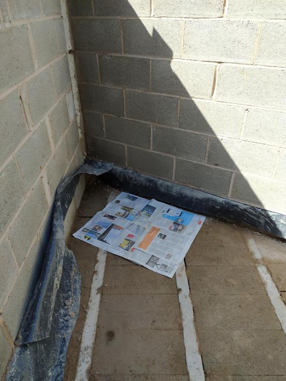

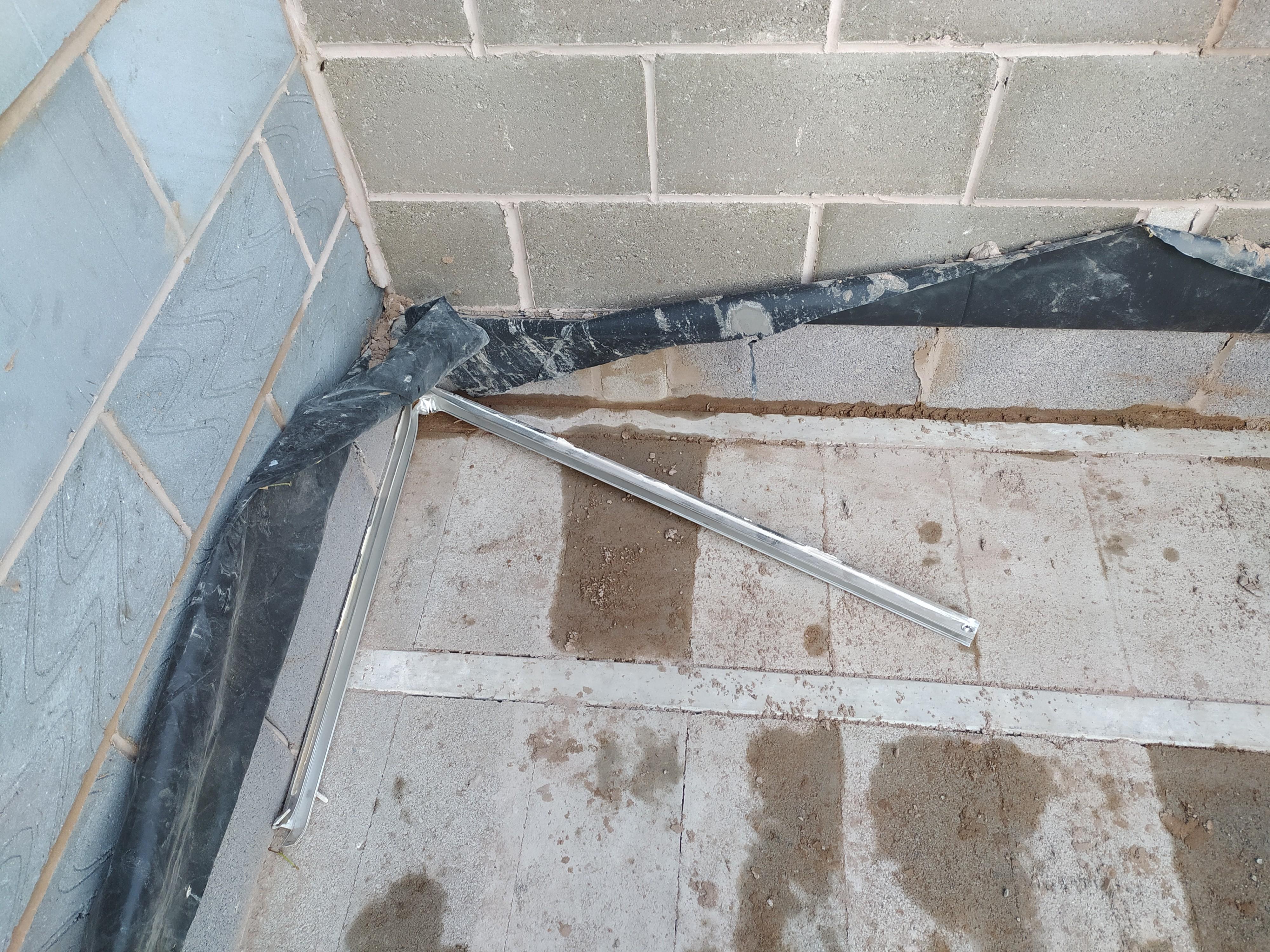

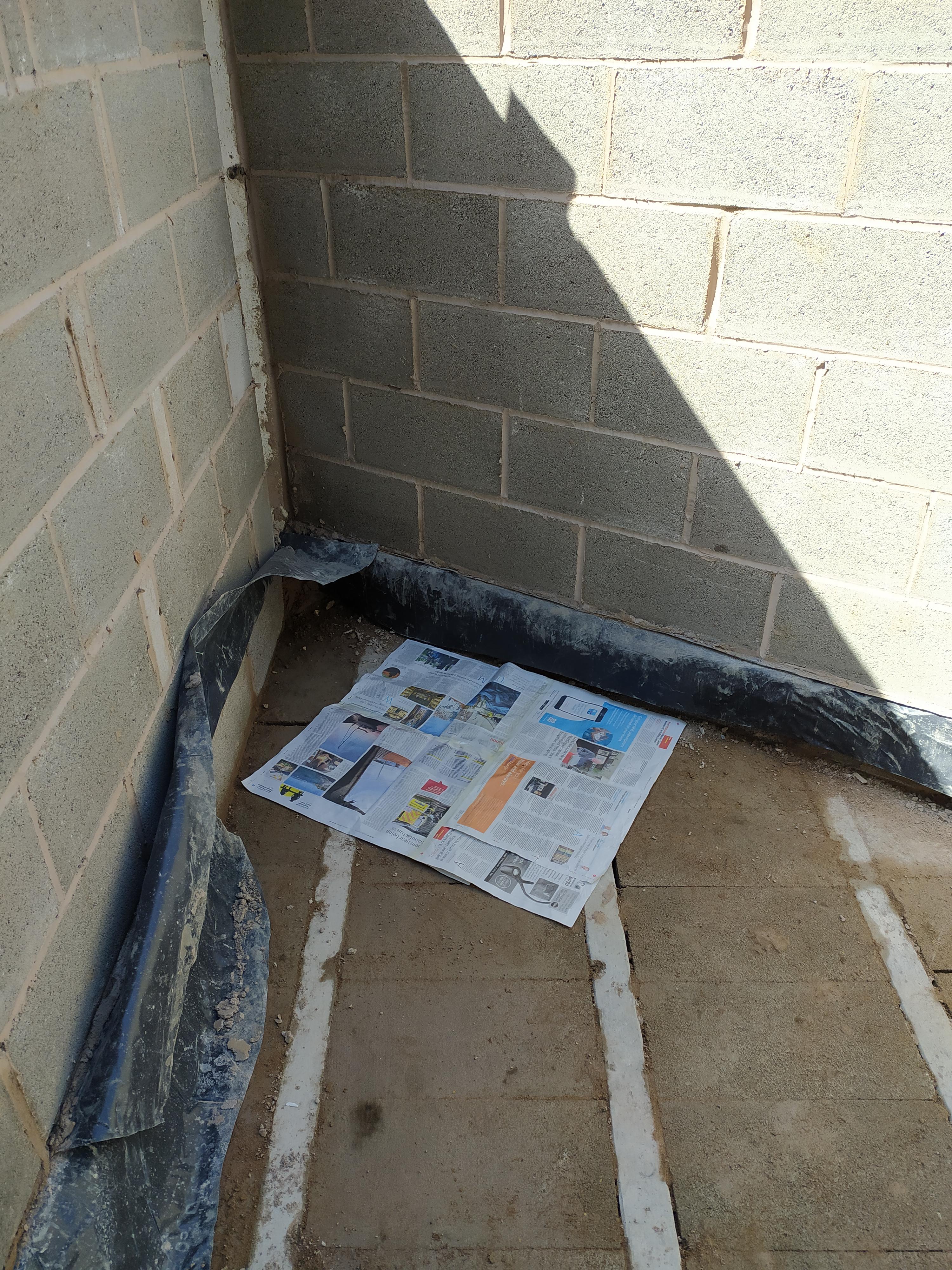

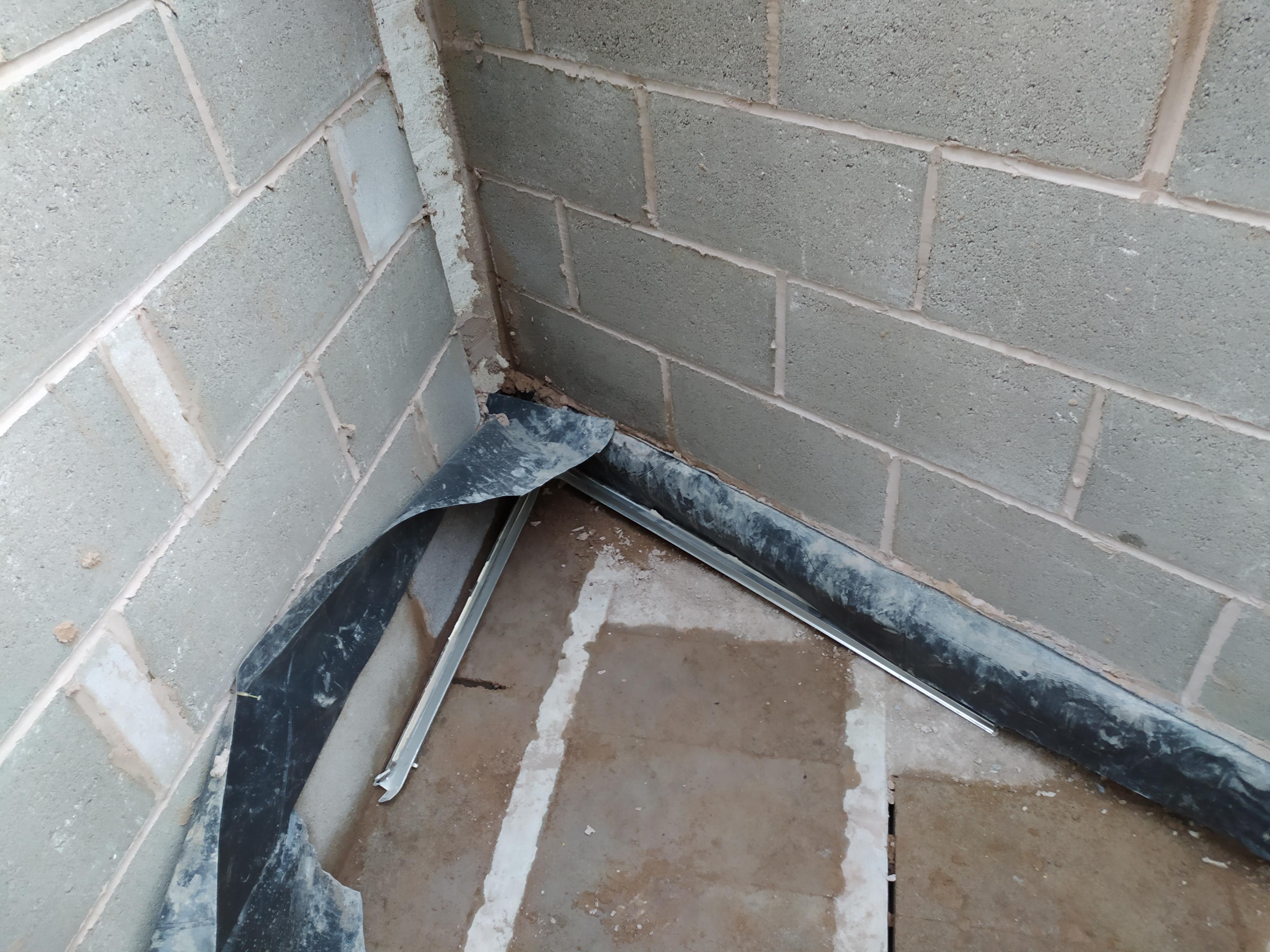

canalsiderenovation Posted July 11, 2020 Posted July 11, 2020 In our second ensuite we have quite a small space and are trying to find a suitable shower tray/cubicle we could make work in tn space. The first pic shows the angle we have (see bent piece of metal) against a 90 degree wall and the second pic is the a metal against the esuite wall.

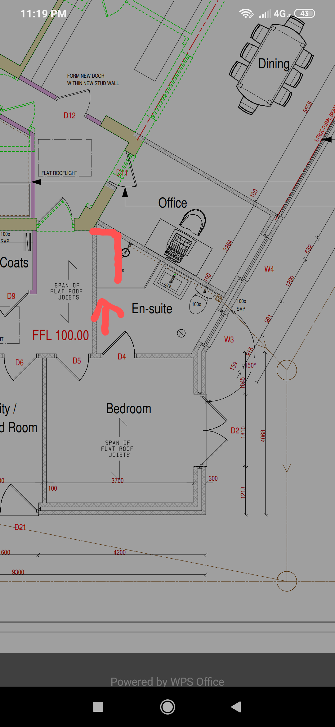

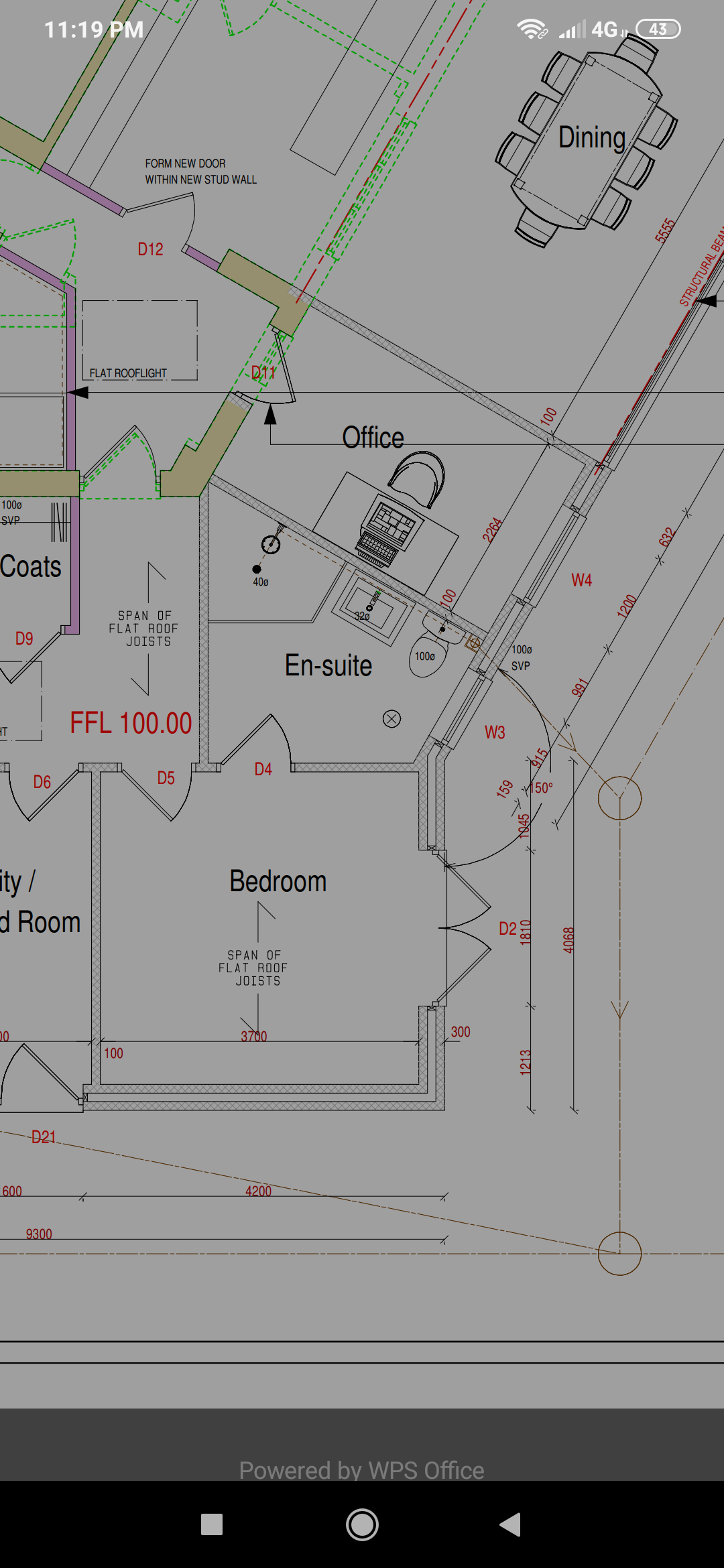

canalsiderenovation Posted July 11, 2020 Author Posted July 11, 2020 (edited) This is what is on the plans and we have the foundations/walls. It's the only real logical place but don't really want tiles but the tray shape on the plans doesn't exist! Hopefully @Nickfromwales will be along too with some advice. Edited July 11, 2020 by canalsiderenovation
PeterW Posted July 11, 2020 Posted July 11, 2020 Square the corner off, put the toilet on the squared off wall (could use a back to wall frame) and then put the shower where the WC should be and move the basin left ... 1
Onoff Posted July 11, 2020 Posted July 11, 2020 22 minutes ago, PeterW said: Square the corner off, put the toilet on the squared off wall (could use a back to wall frame) and then put the shower where the WC should be and move the basin left ... Best idea ? That V shaped internal corner is going to be a really useless space.
canalsiderenovation Posted July 11, 2020 Author Posted July 11, 2020 Hmmm I don't really want the shower close to the window and it could end up blocking it. I guess the corner could be squared off and then a D or U shaped shower.

Onoff Posted July 12, 2020 Posted July 12, 2020 (edited) Could you move door D4 to the right so it opens towards the window? That'd free up a square corner in the bathroom for a decent sized shower. I'd still square off that V though. With hindsight I might have had the wc on my squared off corner and had a walk in shower in the adjacent corridor through the old doorway! Edited July 12, 2020 by Onoff 1

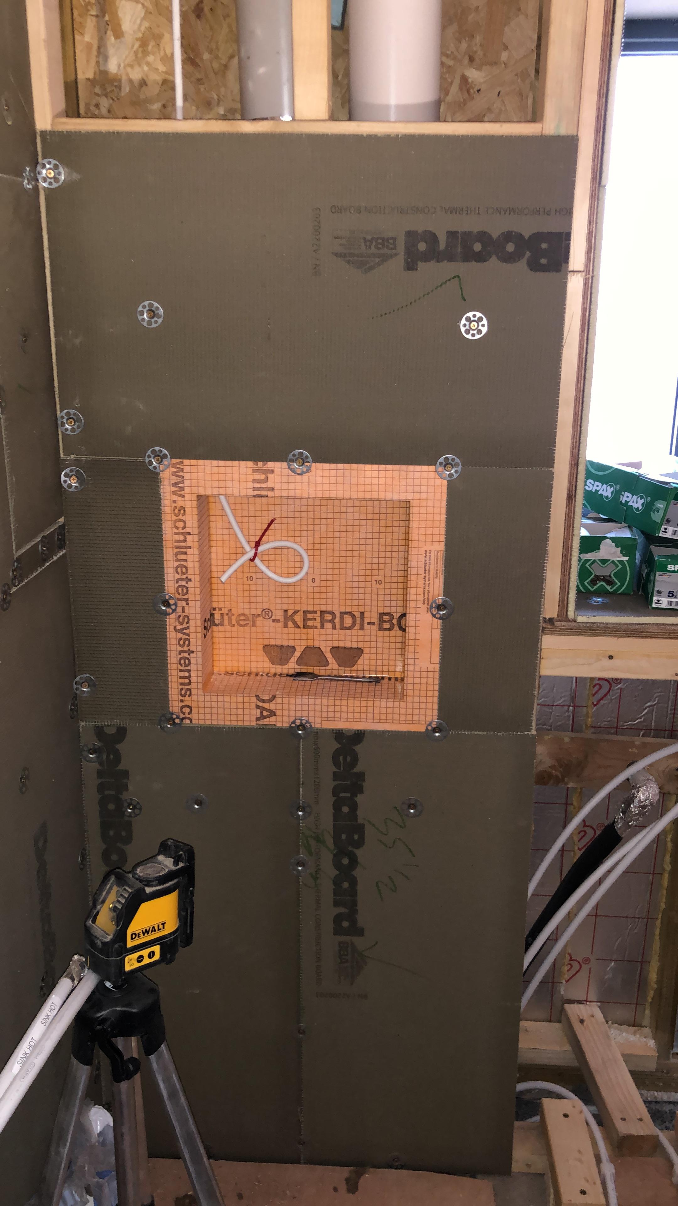

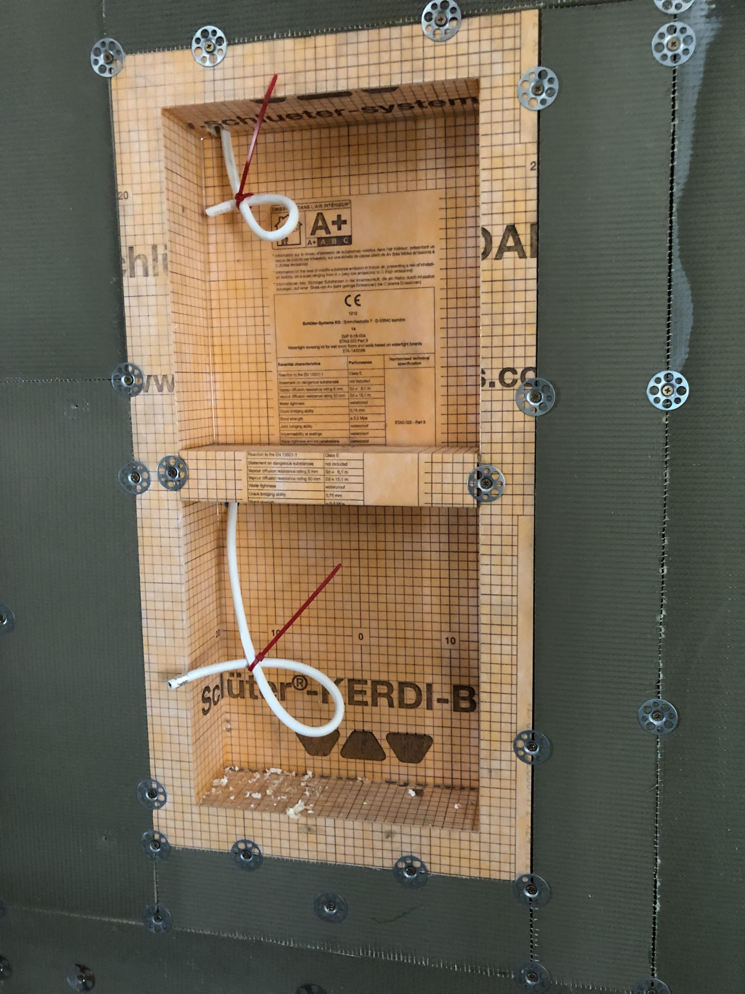

Onoff Posted July 12, 2020 Posted July 12, 2020 12 minutes ago, canalsiderenovation said: Oh I never thought of that - in shower storage recesses..... You can either form them yourself like I did: Or buy them ready made like @pocster has just done. (I was limited on depth). 1

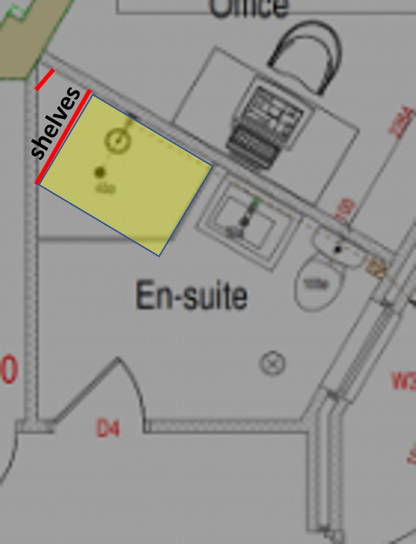

Bored Shopper Posted July 12, 2020 Posted July 12, 2020 (edited) To minimise any moving of walls/ doors etc, and still keep a tray (if you don't want tiles to a fall as recommended above), then like this. Linear drain in the tray can still be applied against the top wall. Then it's up to you how you screen it off with shower screens, can be creative here to make any shape. Edited July 12, 2020 by Bored Shopper 1
Pocster Posted July 12, 2020 Posted July 12, 2020 15 minutes ago, Onoff said: You can either form them yourself like I did: Or buy them ready made like @pocster has just done. (I was limited on depth). Yes . They are expensive for what they are but takes 5 mins to install 1

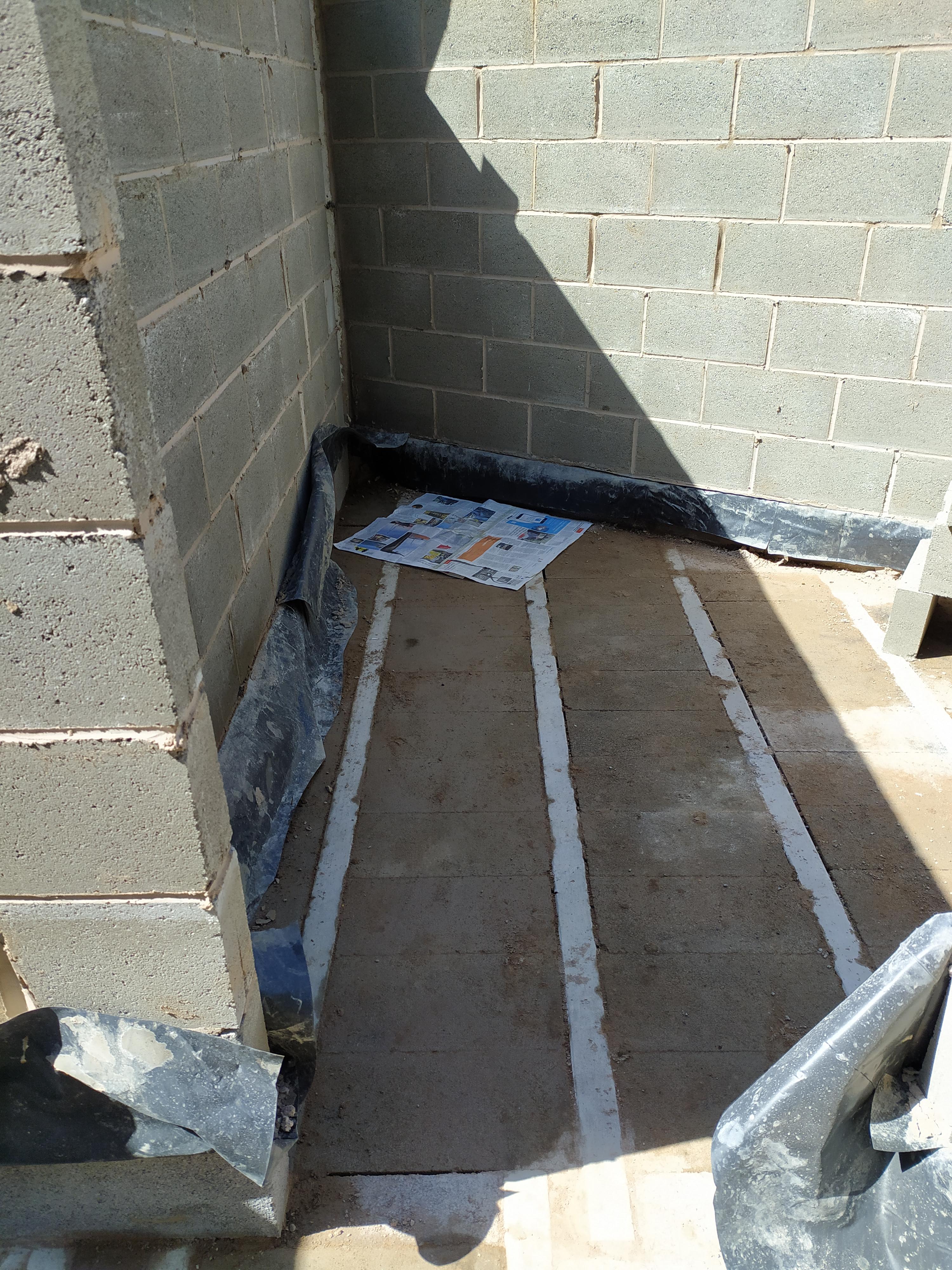

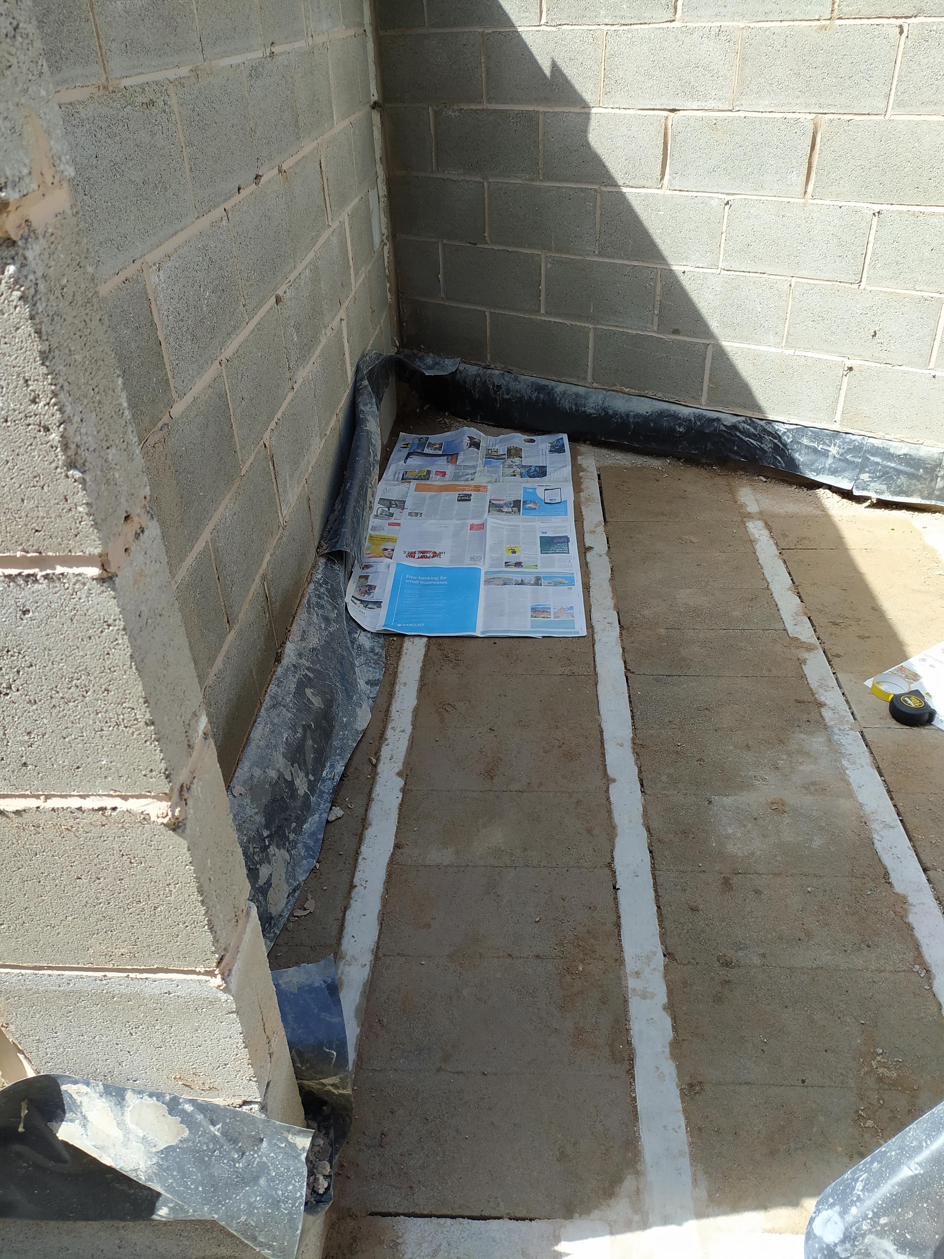

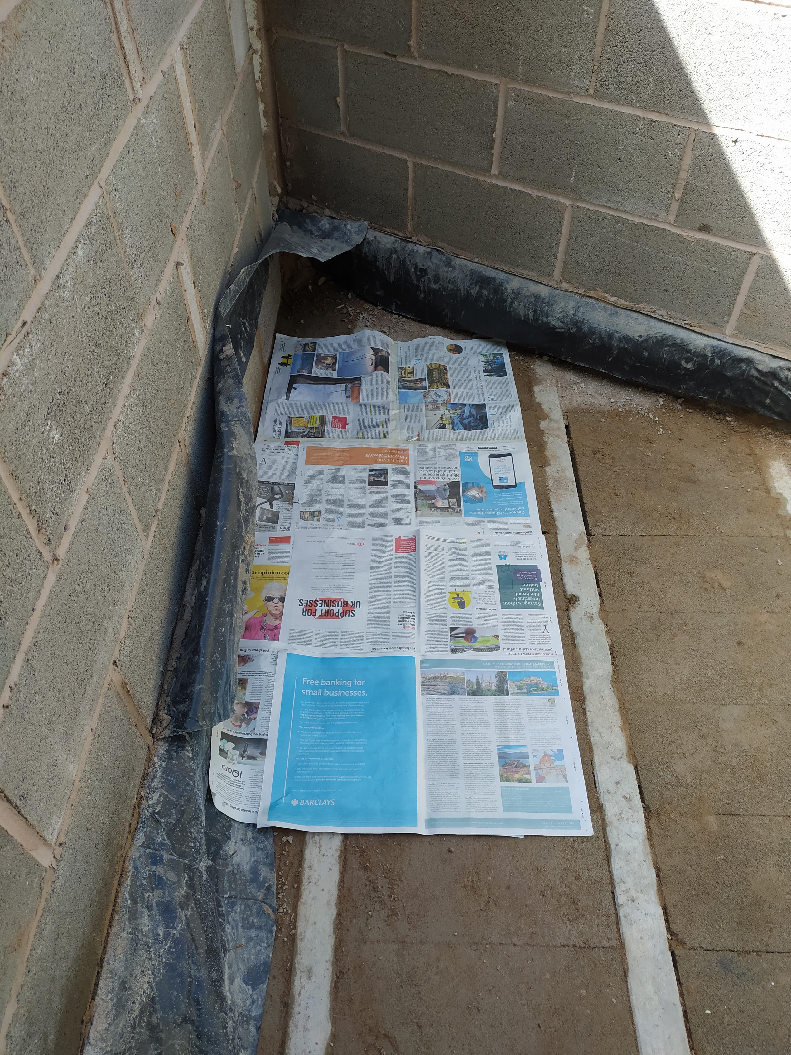

canalsiderenovation Posted July 12, 2020 Author Posted July 12, 2020 It's for a second ensuite for the parents/Airbnb (we have our own) so I don't really want to start moving walls etc so armed with some newspaper I've been playing around with the layout. Option one @Bored Shopper your suggestion. This is based on 800*800 tray. Bit worried about the door on a tray and cleaning access. Not sure.
canalsiderenovation Posted July 12, 2020 Author Posted July 12, 2020 The other option seems to be as per my drawing and have a walk in shower and tray. Newspaper is based on tray of 1400*800. We could then have the entrance door opening the other side but don't think this is necessarily needed. From squaring it off to the entrance door wall the measurement of the wall is 2.9 metres.

PeterW Posted July 12, 2020 Posted July 12, 2020 Where is the drain through the floor ..?? Or under the floor ..?? That will dictate where the waste goes - can’t see it on the pictures. For me, I would go 1400/1500 x 800/900 and not worry about the door anyway - an 800 door would still leave a swing of 600 before the end of any glass frames (and a nice space behind the door for the towel rails)
