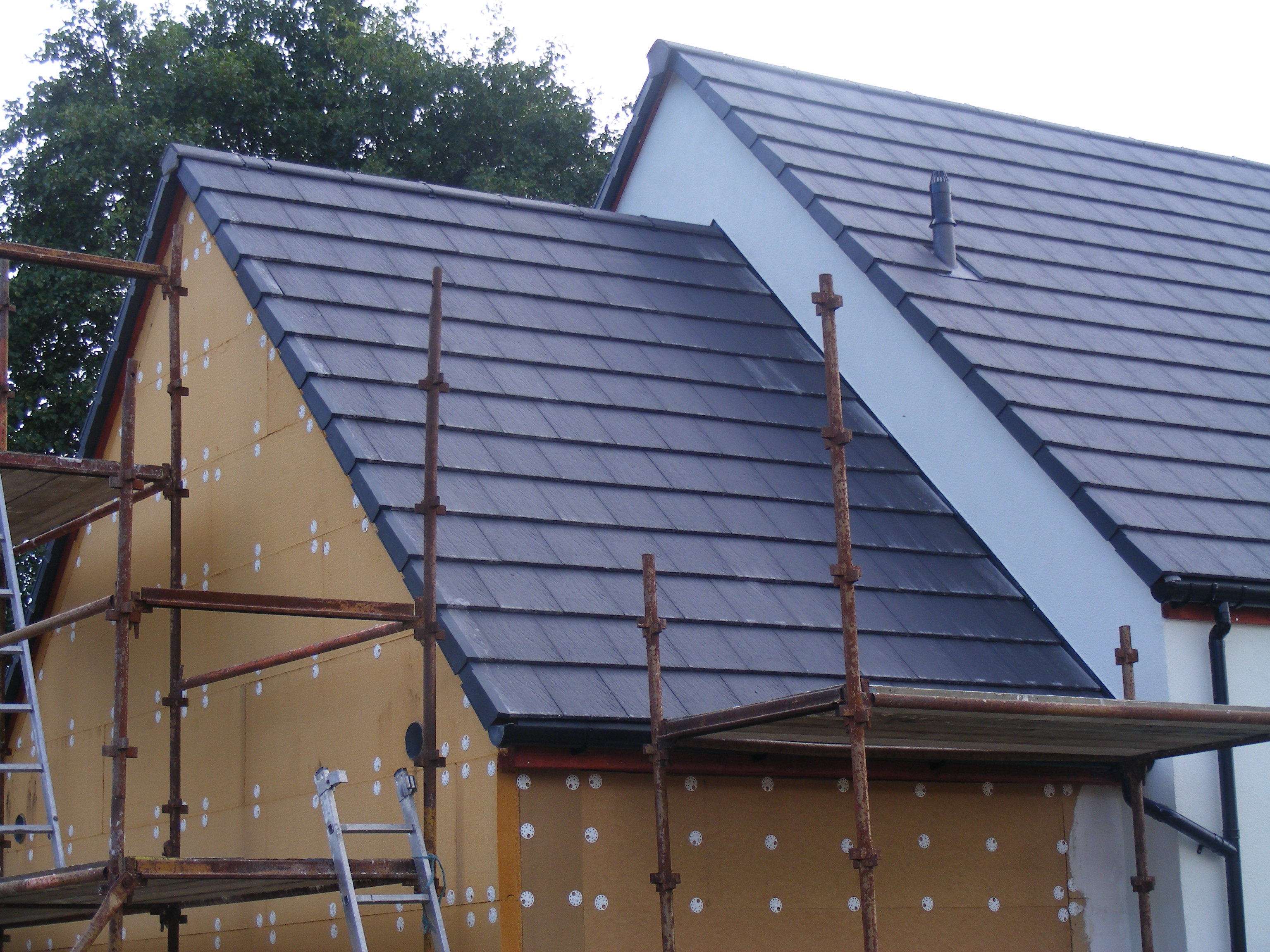

ProDave Posted June 25, 2020 Share Posted June 25, 2020 Is your planning passed yet? Mine started off down the natural slate avenue, but I persisted pointing out adjacent houses had concrete tiled roofs. They eventually accepted a particular concrete tile with a riven finish and colour to make it look a bit like slate. Link to comment Share on other sites More sharing options...

ProDave Posted June 25, 2020 Share Posted June 25, 2020 Is it worth going back for an amendment? We use Marley Edgemere Riven. which are a concrete interlocking tile made to look a bit like slate and a bit thinner than most concrete tiles. Link to comment Share on other sites More sharing options...
dnb Posted June 25, 2020 Author Share Posted June 25, 2020 12 minutes ago, ProDave said: Is it worth going back for an amendment? Your roof looks good! For a saving of around £1000 in materials alone it may well be worth asking about an amemndment if I can find a good reason. I assume interlocking tiles are easier and therefore faster to install than slates, so there's a labour saving too - I'm not too keen on heights so will avoid these jobs where I can and therefore won't be doing much on the roof myself. I have my doubts that I will get away with it though - they'll mention the usual ANOB issues, followed by SSSI and say I'm lucky to be building anything! ? Link to comment Share on other sites More sharing options...

makie Posted June 25, 2020 Share Posted June 25, 2020 As a roofer please don't use Chinese slate, they are awful. Cupa is a good spanish slate (H3's are better than the rest) As said by ProDave try and get an amendment - The redland Cambrian is a good option as it is a tile made from recycled slate. The saxon is another good option. Try and avoid Marley, they are made on the cheap and they don't let them cure as long as they should now. Link to comment Share on other sites More sharing options...
