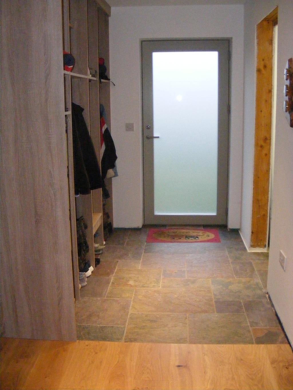

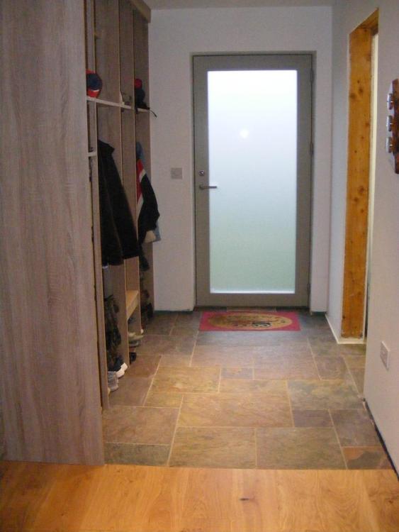

ProDave Posted June 22, 2020 Share Posted June 22, 2020 I got a dead level transition. 7 The wooden floor went down first, height set to match door thresholds. Tiles went down later with floor make up worked out for a level transition. Link to comment Share on other sites More sharing options...

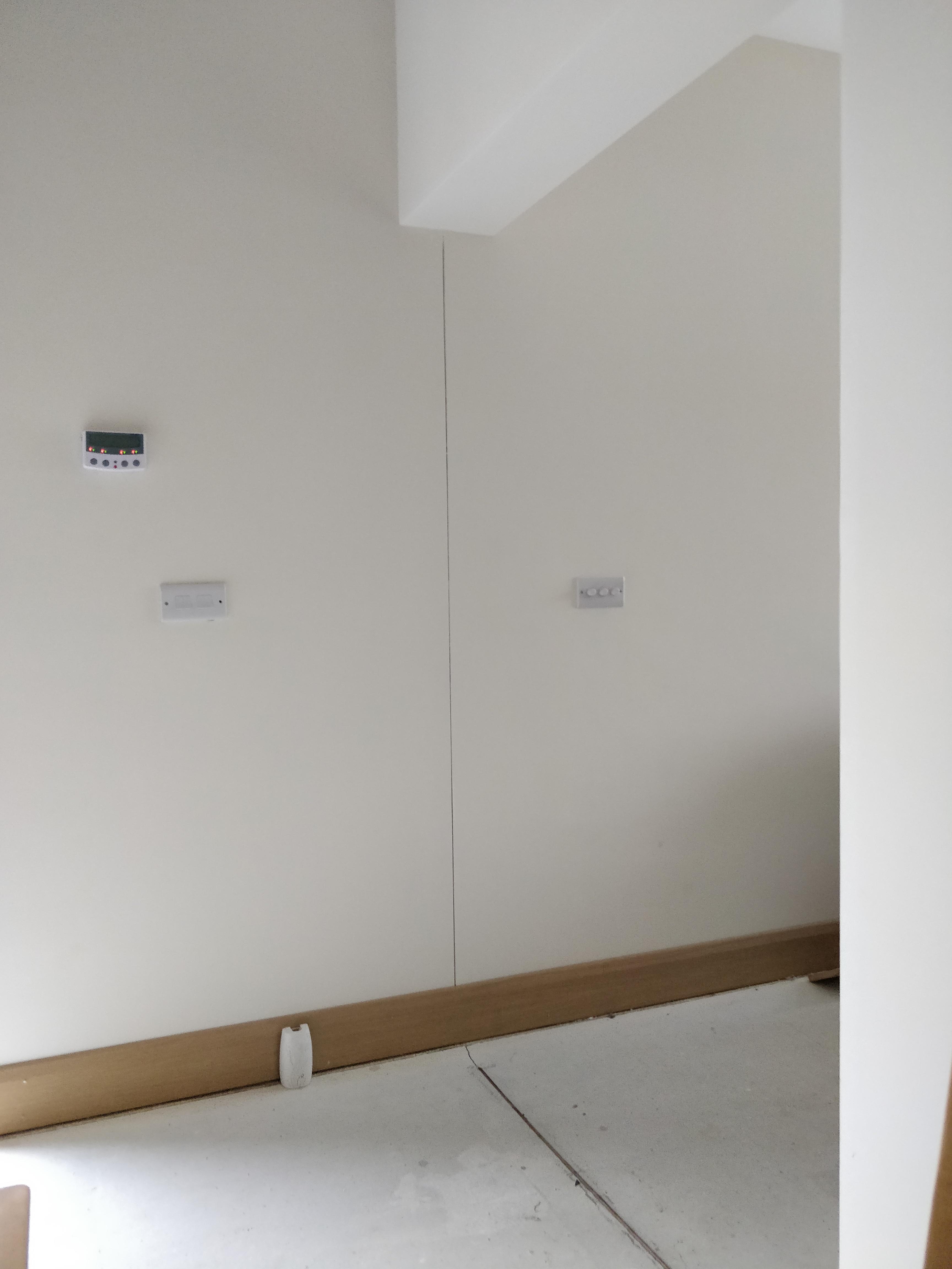

vfrdave Posted June 22, 2020 Author Share Posted June 22, 2020 This is one of the transition areas. Wooden floor is 20mm although not completely decided upon. Add to that some adhesive I guess. Tile is 7/8mm adhesive probably brings it up to 13/14mm. Kitchen is 8m long with a similar opening opposite at the other end. Link to comment Share on other sites More sharing options...

vfrdave Posted June 22, 2020 Author Share Posted June 22, 2020 The issue gets more complex in that if I self level the kitchen to match the height of the wooden floor it throws other levels out. Off the kitchen is the utility, a passageway to the boot room and garage and door to the entrance hall. All of these areas are to be tiled also and thus need self levelling to match kitchen. Link to comment Share on other sites More sharing options...
