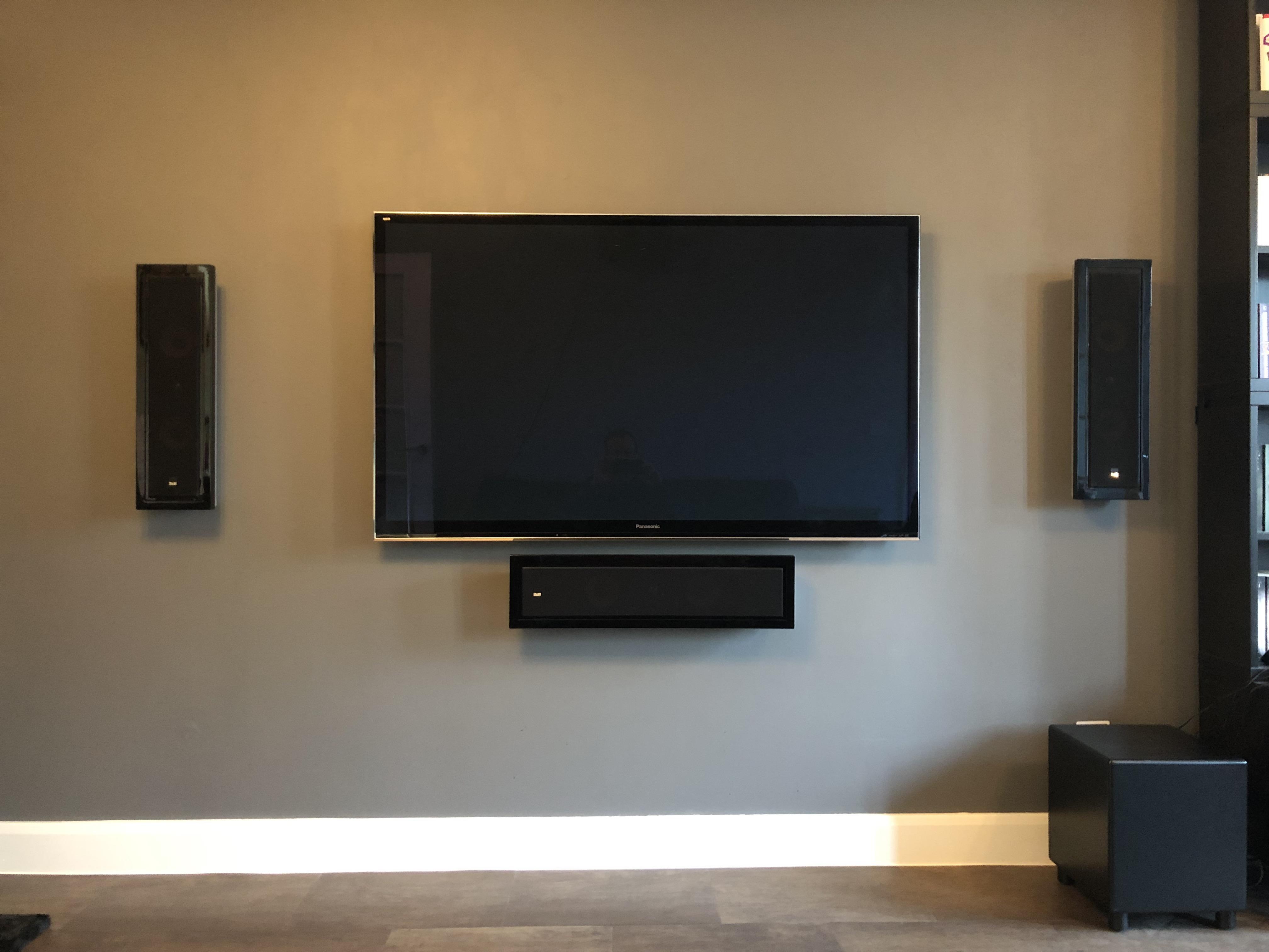

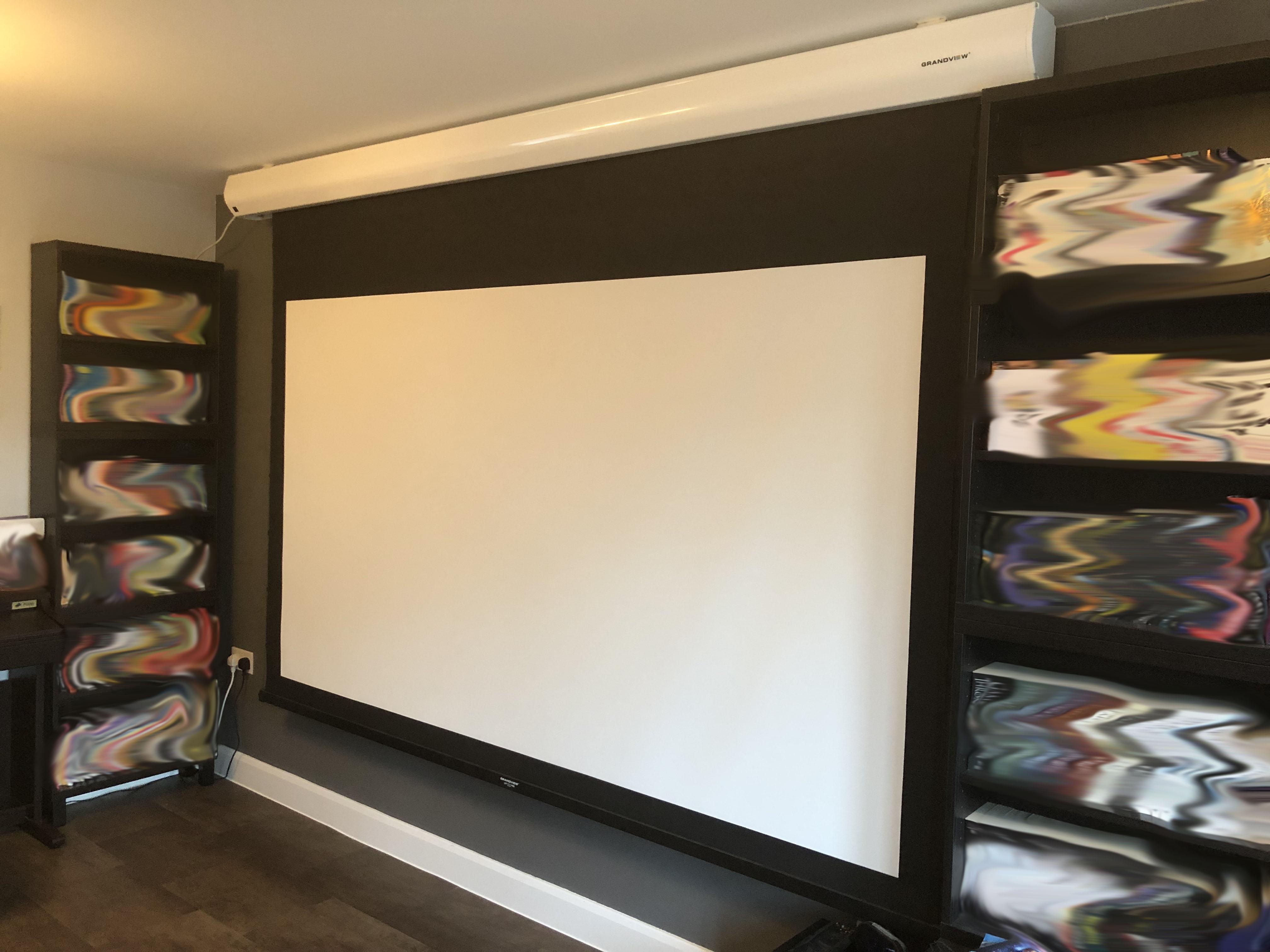

Thorfun Posted June 21, 2020 Share Posted June 21, 2020 (edited) 53 minutes ago, puntloos said: But we were thinking having a proper tv - for daytime viewing, and hey maybe wall lights etc. I had a motorised AT screen with a nice Plasma TV also on the wall. once the projector and screen were installed the TV never got turned on.....ever! we had blackout blinds in the room and even if we were watching TV/film during the day the projector and screen were used. once you get used to the big screen size the TV just doesn't cut it. couple of photos to help visualise what I'm talking about. Edited June 21, 2020 by Thorfun Link to comment Share on other sites More sharing options...

puntloos Posted June 21, 2020 Author Share Posted June 21, 2020 (edited) @Thorfun heh, nice setup! And actually - in my previous home I had a 3m white wall and projector. We did still use the TV a lot, mainly during the day as 'wallpaper' though. (we like radio paradise android app, which gives peaceful pictures with peaceful music) @Reiver: no strong preference for a floor yet! We are tempted to go for amtico, we kinda like the 'parquet-ish' look, UFH needs to breathe, and I think it could also be fairly good for audio? Or am I wrong? Happy to hear suggestions! @Declan52 As you can see I kinda/mostly solved the whole projector issue by embedding it into my kitchen wall: (full floorplan here). FWIW my current projector choice is the JVC NX5 Edited June 21, 2020 by puntloos Link to comment Share on other sites More sharing options...

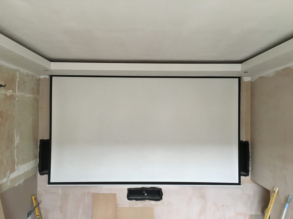

AliG Posted June 22, 2020 Share Posted June 22, 2020 It is unlikely that you have the screen as high up as the ceiling, so the easiest way to hide the screen is to build a pelmet box below the ceiling and put it in there.That also stops it affecting your soundproofing in the ceiling. You could even box out a whole framed area all the way around the screen which would look nice. I did look into this kind of thing in my last house and did not find a satisfactory solution at a reasonable price. Some companies make screens that drop through a door as they lower so you can put the whole thing up inside the ceiling, however from memory for this small benefit of tidiness they were considerably more expensive. I think simply putting the cassette inside the pelmet with an open slot is probably a lot more cost effective. In the end we just screwed it to the wall as in @Thorfun's picture. We have a stepped ceiling in our cinema room which gives an easy way of hiding the ceiling speakers..Again you could then incorporate this into the pelmet that houses the screen and bring it all the way round to the projector. One thing to consider is where will all your equipment be - Sky box, amp, PS4 etc. We have a whole rack in a cupboard at the back of the cinema room. Link to comment Share on other sites More sharing options...
Thorfun Posted June 22, 2020 Share Posted June 22, 2020 22 minutes ago, AliG said: It is unlikely that you have the screen as high up as the ceiling, so the easiest way to hide the screen is to build a pelmet box below the ceiling and put it in there.That also stops it affecting your soundproofing in the ceiling. You could even box out a whole framed area all the way around the screen which would look nice. my plan was to build a pelmet and put nice downlights in it but in the end I couldn't be bothered. in the end I'm glad I didn't as I would've had to take it down and make good when selling the house. but they do look good. Link to comment Share on other sites More sharing options...
puntloos Posted June 22, 2020 Author Share Posted June 22, 2020 24 minutes ago, AliG said: It is unlikely that you have the screen as high up as the ceiling, What do you mean? A 3.5m wide screen, would be 2m tall. The black drop (above the screen) is 30cm, so after that we'd be 40cm above the floor anyway... 24 minutes ago, AliG said: so the easiest way to hide the screen is to build a pelmet box below the ceiling and put it in there. Hm.. it would look ugly though. 24 minutes ago, AliG said: That also stops it affecting your soundproofing in the ceiling. You could even box out a whole framed area all the way around the screen which would look nice. Do you have an image perhaps? 24 minutes ago, AliG said: I did look into this kind of thing in my last house and did not find a satisfactory solution at a reasonable price. Some companies make screens that drop through a door as they lower so you can put the whole thing up inside the ceiling, however from memory for this small benefit of tidiness they were considerably more expensive. I think simply putting the cassette inside the pelmet with an open slot is probably a lot more cost effective. In the end we just screwed it to the wall as in @Thorfun's picture. We have a stepped ceiling in our cinema room which gives an easy way of hiding the ceiling speakers..Again you could then incorporate this into the pelmet that houses the screen and bring it all the way round to the projector. Eh, my cinema speakers have to be positioned fairly exaclty so I don't think I can escape the shell as depicted. 24 minutes ago, AliG said: One thing to consider is where will all your equipment be - Sky box, amp, PS4 etc. We have a whole rack in a cupboard at the back of the cinema room. Fair. I haven't really considered it too strongly. One fact is that if I manage to get a basement into 'affordable' range one tip of the basement directly borders the cinema room so it'd be an obvious location. Link to comment Share on other sites More sharing options...
AliG Posted June 22, 2020 Share Posted June 22, 2020 (edited) I was thinking of this kind of thing to hide the screen and possibly the ceiling speakers. We have something similar but our screen is fixed. Actually our rear speakers are in the step, but the "above" Atmos speakers couldn't be that far to the edge so they are in the ceiling. Edited June 22, 2020 by AliG 2 Link to comment Share on other sites More sharing options...
