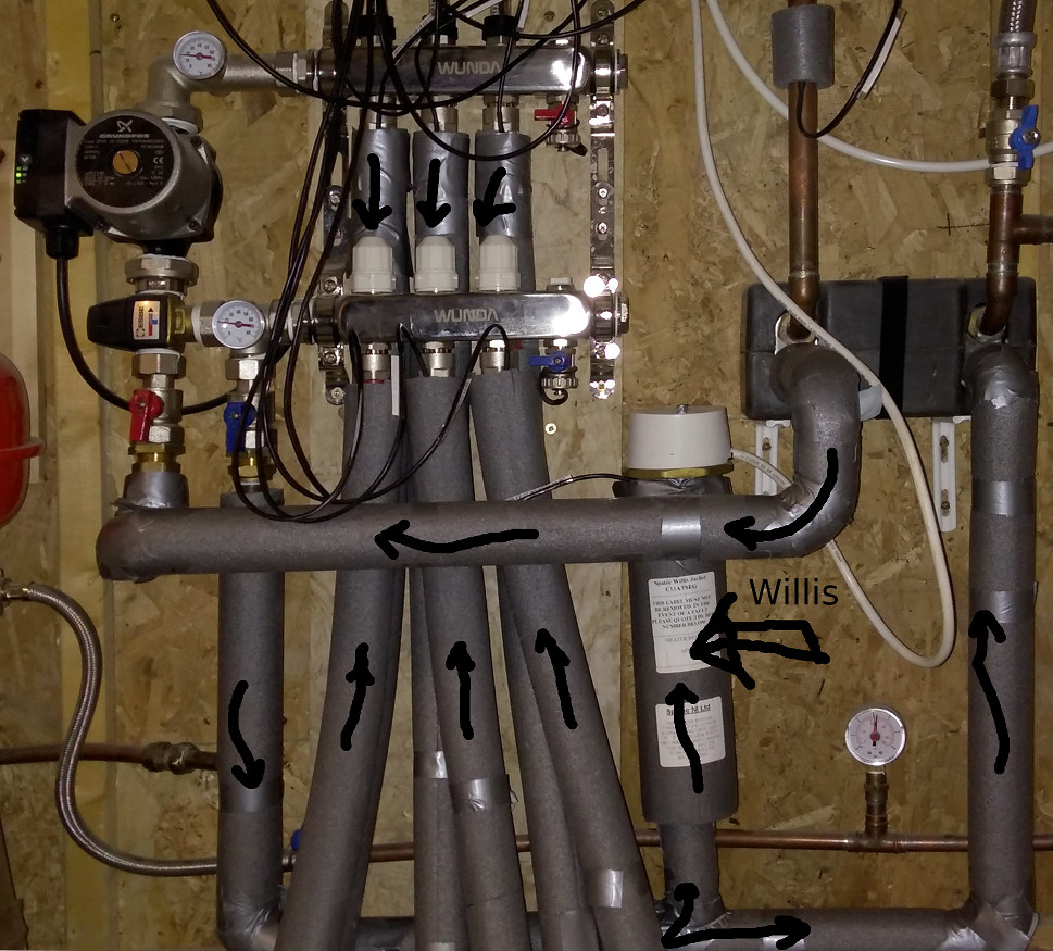

jack Posted November 9, 2017 Share Posted November 9, 2017 Is this the Willis heater? How's it plumbed in? Is it in a bypass loop? Link to comment Share on other sites More sharing options...
Jeremy Harris Posted November 9, 2017 Share Posted November 9, 2017 (edited) This is what a Willis heater looks like: It's just an immersion heater set into a copper tube with an inlet at the bottom and an outlet at the top. They are mounted vertically and in their original application, in Ireland, mainly, they were added to the side of an existing hot water cylinder. They are pretty cheap, around £35. Edited November 9, 2017 by JSHarris Link to comment Share on other sites More sharing options...

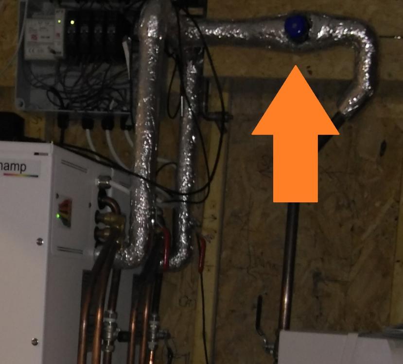

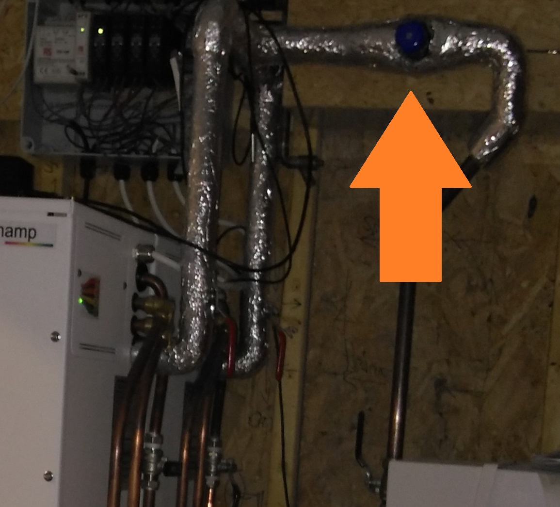

jack Posted November 9, 2017 Share Posted November 9, 2017 I know what a Willis heater is thanks (I seem to recall discussing whether to install one as the primary immersion way back on ebuild when doing our initial design), I'm just interested in how Terry's arranged it within his system. The arrow I put in the pic above points to something vaguely the right shape, and I can't see anything else suitable in the pictures. Link to comment Share on other sites More sharing options...
Dudda Posted November 9, 2017 Share Posted November 9, 2017 19 minutes ago, jack said: I know what a Willis heater is thanks (I seem to recall discussing whether to install one as the primary immersion way back on ebuild when doing our initial design), I'm just interested in how Terry's arranged it within his system. The arrow I put in the pic above points to something vaguely the right shape, and I can't see anything else suitable in the pictures. It's in between the UFH manifold and the black plate heat exchanger on the other photo. It has a white circular cap and two white stickers on it. You can just about make out 'Willis Jacket' on the top sticker. 1 Link to comment Share on other sites More sharing options...
jack Posted November 9, 2017 Share Posted November 9, 2017 Good spot, thanks! Link to comment Share on other sites More sharing options...

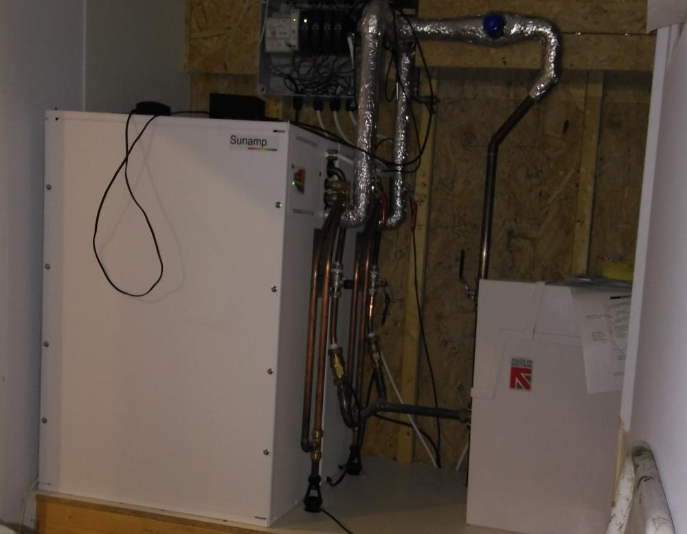

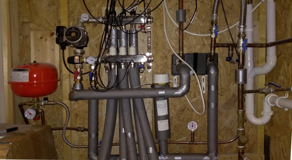

TerryE Posted November 9, 2017 Author Share Posted November 9, 2017 Sorry, thought that you'd see it. Your arrow is pointing to the TMV mixing PHE heated cold + SunAmp hot into the DWH manifold box. This is what you are looking for. Apart from the UFH pipework in the slab, this is my entire central heating system: Now that I've got DS18B20 themos on 3 × out and 3 × return and on the willis (and a couple on the DCW in and out of the PHE). You don't need thermos in the slab. Just run the pump for 5 mins and take the average temp of the water coming back in the returns. 1 Link to comment Share on other sites More sharing options...

Jeremy Harris Posted March 28, 2018 Share Posted March 28, 2018 19 minutes ago, readiescards said: Do they have to be mounted vertically? Probably not, as long as you arrange for one pipe inlet/outlet to be vertical (to let air out) and also arrange for the pump and heater to be wired to the same circuit, so there is always flow through the heater. Willis never designed these heaters to be used horizontally, or with a pump, they were designed originally to be used vertically with a thermosyphon, but the smaller, but similar, immersion heater in a tube that is inside a Sunamp PV is horizontal and works just fine. It has a similar resettable over-temperature cut out as a modern immersion fitted to a Willis heater, and is arranged so that the heater can only operate when the pump is circulating water through the heating chamber. Link to comment Share on other sites More sharing options...
dpmiller Posted March 28, 2018 Share Posted March 28, 2018 Can't find any MIs for the Willis, but looking at the label on this example implies horizontal fitment http://www.pdplumbingsupplies.com/products/rohs-external-immersion-heater-also-known-as-a-willis.html Link to comment Share on other sites More sharing options...
TerryE Posted March 28, 2018 Author Share Posted March 28, 2018 (edited) 1 hour ago, dpmiller said: looking at the label on this example implies horizontal fitment In the typical installation which is external heat for an indirect HW cylinder they are fitted vertically as the thermal gradient is the primary pumping action. In this case the thermal effect is trivial compared to the UFH pump so that can be fitted either way. You can see all of the ds18b20s in this figure, plus the PHE. The typical delta is -5°C out -> return at the manifold and 10°C return -> Willis top so the water flow is ~50:50 through the Willis and the PHE. The 5°C is at the medium pump flow setting. At high setting this drops to ~3°C. but I am happy with 5°C and very little pump noise. BTW, if you want to use the out/returns to measure the slab temperatures then you need to run the pump for 5 mins first. @readiescards, I am happy to talk through all of this stuff with you, but give it 3 days or so because I've had an absolutely shitty cold for 3 weeks and still can't speak easily. Also like Jeremy and others, I do offer an open invite to forum members to come and to see my build and to discuss any issues that they want. Lincolnshire to Northamptonshire isn't that far. If you want to do either, then just PM me, though can you give me your email addr because I prefer using email. Edited March 28, 2018 by TerryE 1 Link to comment Share on other sites More sharing options...
