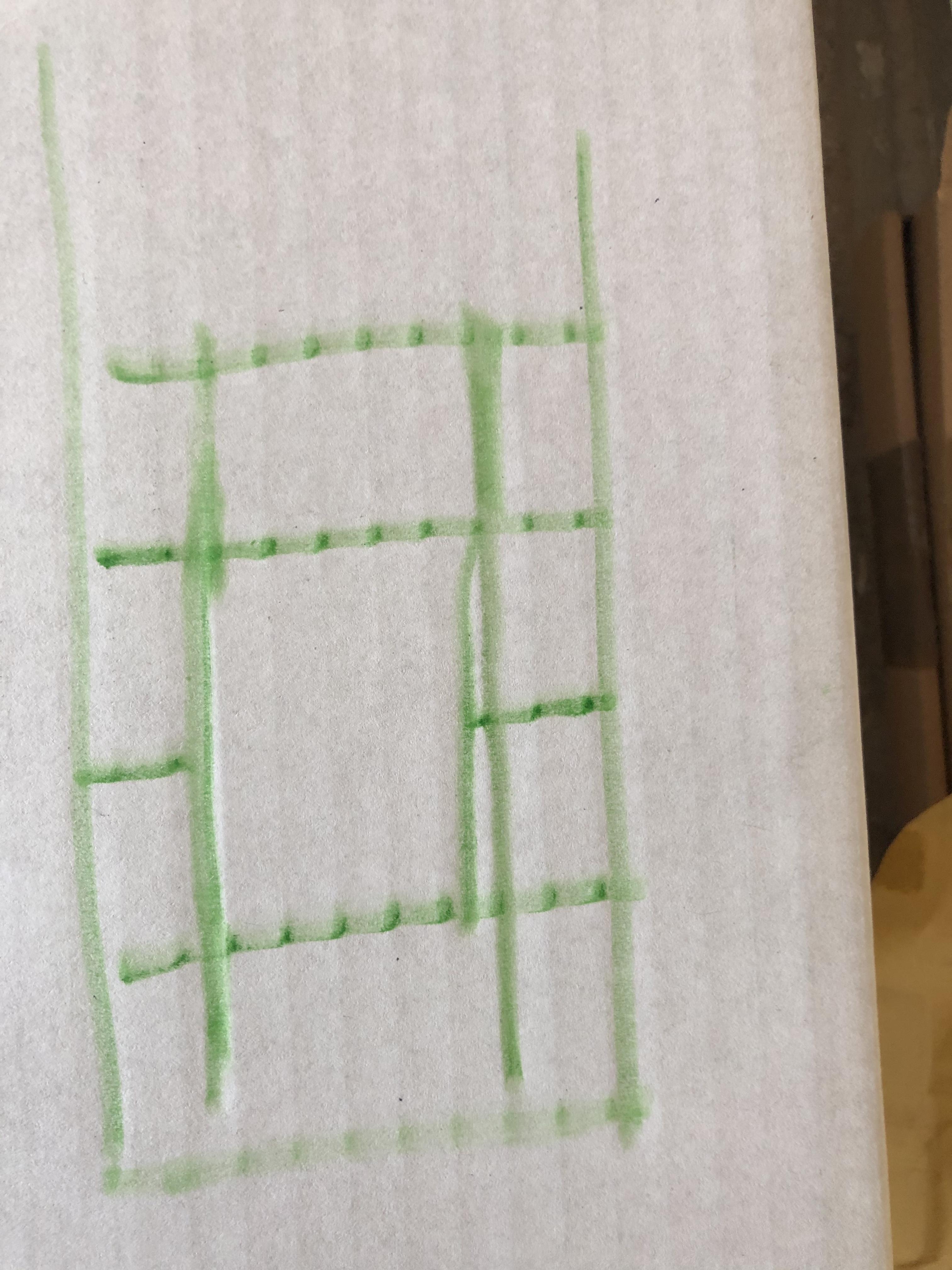

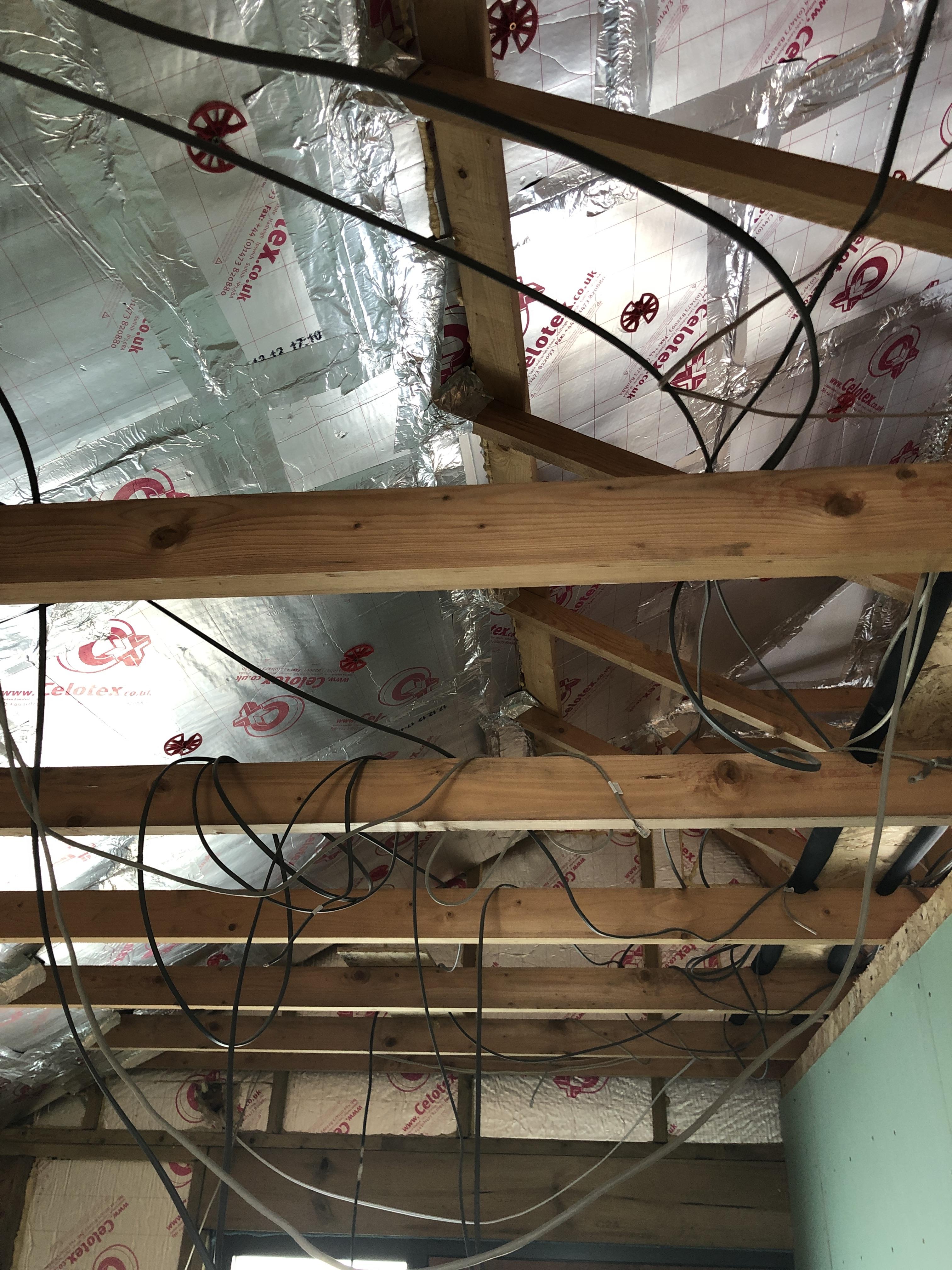

Pocster Posted June 9, 2020 Share Posted June 9, 2020 I assumed a loft hatch with an attached loft ladder would make access easier for me . Problem is my hallway is 1.2m and joists run across it approx 57cm wide. ( so I can’t run it length ways down the hall ) My concern is a ladder won’t come fully down without hitting the wall . I’ve looked at the concertina ones ; can’t workout with the ladder extended how far it goes past the edge of the opening I.e will it hit the wall ? Anyone got one ? Link to comment Share on other sites More sharing options...
ProDave Posted June 9, 2020 Share Posted June 9, 2020 Cut one of the joists and frame round it to fit a ladder the correct way. 1 Link to comment Share on other sites More sharing options...
Pocster Posted June 9, 2020 Author Share Posted June 9, 2020 7 minutes ago, ProDave said: Cut one of the joists and frame round it to fit a ladder the correct way. See . Now I thought that . But I’m scared to cut a structural joist .... Assumed it was a bad plan ... Link to comment Share on other sites More sharing options...
PeterW Posted June 9, 2020 Share Posted June 9, 2020 You can trim and reinforce those to make the gap - just needs to be sistered/framed with the same size joists and doubled up all round Link to comment Share on other sites More sharing options...

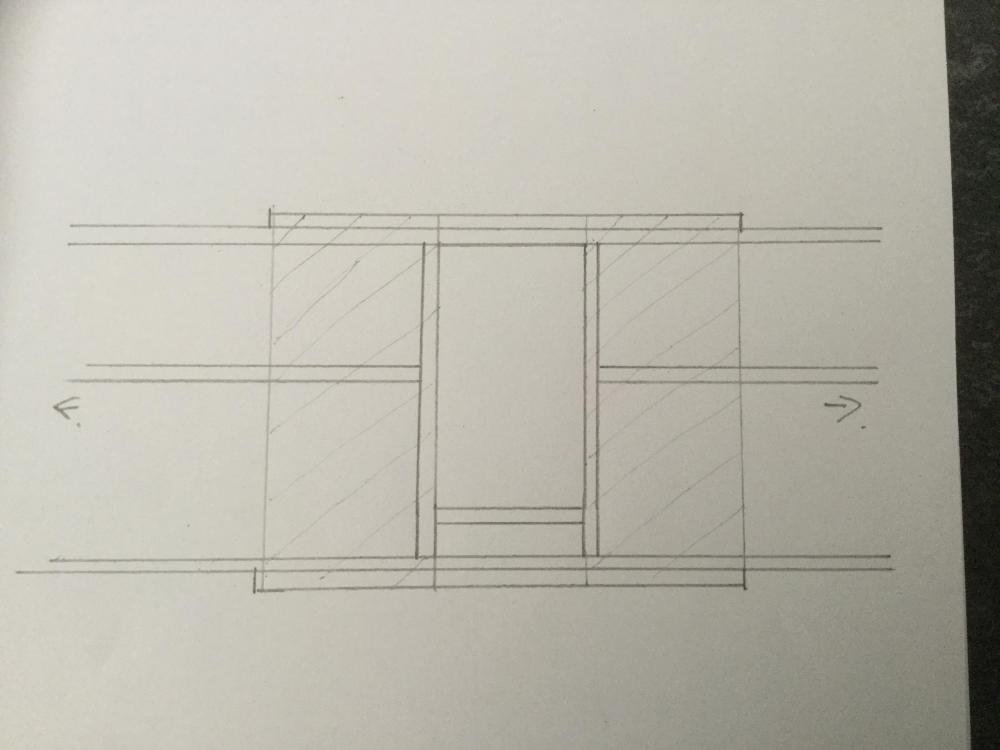

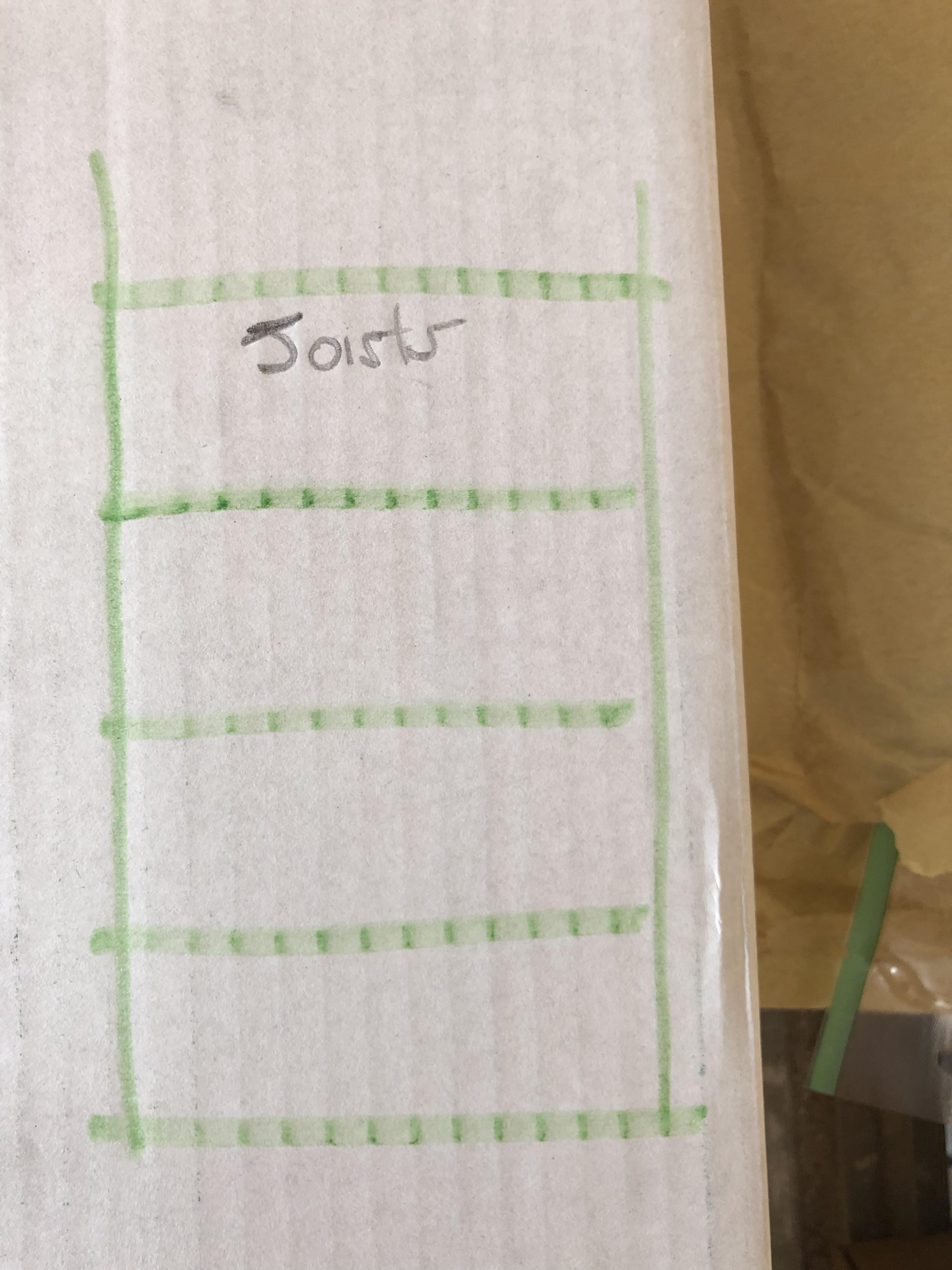

Pocster Posted June 9, 2020 Author Share Posted June 9, 2020 11 minutes ago, PeterW said: You can trim and reinforce those to make the gap - just needs to be sistered/framed with the same size joists and doubled up all round Erm . Not 100% sure what you mean . I’m weary of electrics and structural things . Drawing of what I have Drawing of ‘my plan ‘ Link to comment Share on other sites More sharing options...

joe90 Posted June 9, 2020 Share Posted June 9, 2020 I have done loads of these, as per others above cut joist and frame around it, doubled up or belt and braces screw 18mm chipboard across joists either end of the loft hatch . Link to comment Share on other sites More sharing options...

joe90 Posted June 9, 2020 Share Posted June 9, 2020 @pocster from your second “CAD” drawing how many joists do you need to cut?, also are the joists resting on the walls either side? 1 Link to comment Share on other sites More sharing options...
Pocster Posted June 9, 2020 Author Share Posted June 9, 2020 (edited) 48 minutes ago, joe90 said: @pocster from your second “CAD” drawing how many joists do you need to cut?, also are the joists resting on the walls either side? I use a very specific CAD program - it came free with some walk on glazing . I think I only need to cut 1 . The joists do indeed run straight across the width of the mansion . Edited June 9, 2020 by pocster Link to comment Share on other sites More sharing options...

CC45 Posted June 9, 2020 Share Posted June 9, 2020 6 hours ago, pocster said: Erm . Not 100% sure what you mean . I’m weary of electrics and structural things . Drawing of what I have Drawing of ‘my plan ‘ What I would do ... Put a piece of timber along the top / bottom of the existing joists to hold them temporarily while you cut the pieces out, cut and then add bracing. If you are really worried you could form the 'box' 1st and then cut to fit this - pop this in place and fix. If it all goes wrong no liability here + anything there of interest to the rest of us self builders? 1 Link to comment Share on other sites More sharing options...

ProDave Posted June 9, 2020 Share Posted June 9, 2020 You are trying to "fix" it with a tiny ladder, than fix the issue stopping you getting a decent ladder in. If you want to be going up and down carrying stuff, AND without keep banging your head, you need a decent size loft hatch. Link to comment Share on other sites More sharing options...
