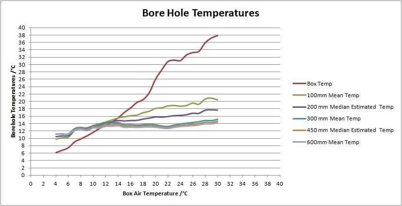

SteamyTea Posted June 8, 2020 Posted June 8, 2020 (edited) If you are considering UFH, how much insulation are you going to fit under it. Heat loss to the ground is greater with UFH than radiators or forced air systems. If you fit post heating to your MVHR, chech that the airflow is large enough to transfer enough energy. It is easy to put in larger ducts at the design stage. You mentioned 'thermal mass'. This is a contentious term and has no basis in science. What you actually mean is thermal inertia, which is the product of the specific heat capacity and the thermal conductivity. What that boils down to is the time it takes for the air in the house to drop by 1°C when there is no extra energy input i.e no heating. Brick and concrete are not very good, timber and cellulose insulation are very good. Edited June 8, 2020 by SteamyTea 1

SteamyTea Posted June 9, 2020 Posted June 9, 2020 58 minutes ago, A_L said: Cellulose and timber do have higher specific heat capacities 2100J/kg.°C and 1600J/kg.°C than Brick, 500J/kg.°C and Concrete, 750J/kg.°C but the greater density of these, 1750kg/m3 and 2300kg/m3 compared to 40kg/m3 and 500kg/m3 means that they store more heat on a volumetric basis. Concrete 1725kJ/m3, Brick 1400kJ/m3, Timber 800kJ/m3 Cellulose 84kJ/m3 The volume becomes a bit irrelevant when the temperature changes are only affecting the first few millimetres. This is why it is the product of the SHC AND thermal conductivity.. There are materials that have low SHC and high thermal conductivity, metals being one class, but there are not many materials that have high SHC and low thermal conductivity. Below is the data from my 600mm borehole that is under my little grrenhouse. Once you are 300mm deep, there is little variation in temperature, approx 5°C, with temperature swings of 32°C within the greenhouse. This reinforces my believe that excess mass with the 'wrong' thermal inertia will cause cooling rather than stability.
A_L Posted June 10, 2020 Posted June 10, 2020 17 hours ago, SteamyTea said: The volume becomes a bit irrelevant when the temperature changes are only affecting the first few millimetres. This is why it is the product of the SHC AND thermal conductivity.. The products (J/kg.K x W/m.K) are Cellulose 84, Timber 208, Brick 280 and Concrete 1350. 17 hours ago, SteamyTea said: This reinforces my believe that excess mass with the 'wrong' thermal inertia will cause cooling rather than stability. What is the energy source to drive this cooling and where does the energy go?
SteamyTea Posted June 10, 2020 Posted June 10, 2020 (edited) 14 minutes ago, A_L said: What is the energy source to drive this cooling and where does the energy go? The energy source can be anything, heating, lighting, solar gain, people. The energy is just dispersed to the atmosphere, which is generally colder, or, for the proper scientific term, a semi-infinite heat sink. Edited June 10, 2020 by SteamyTea
