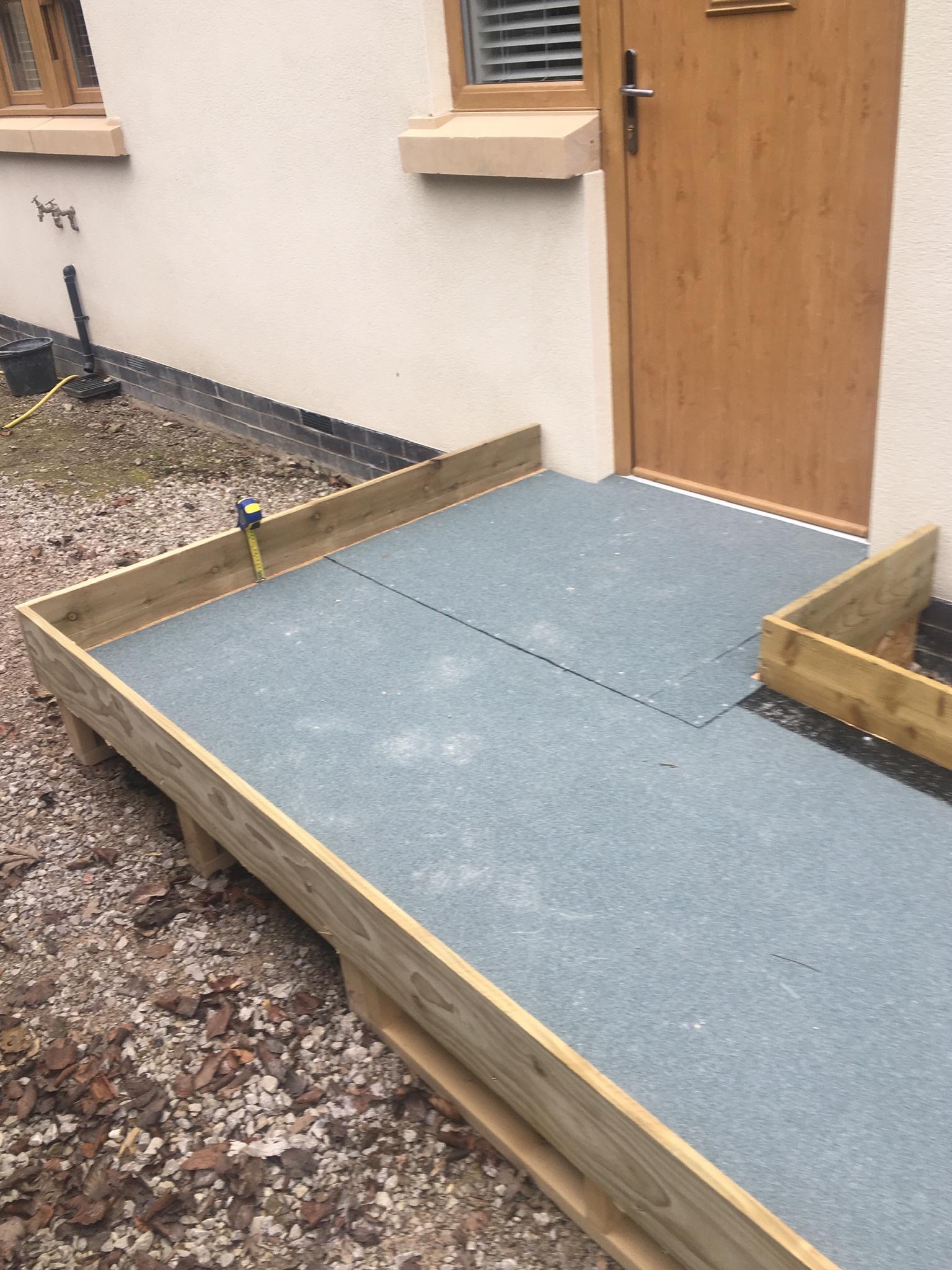

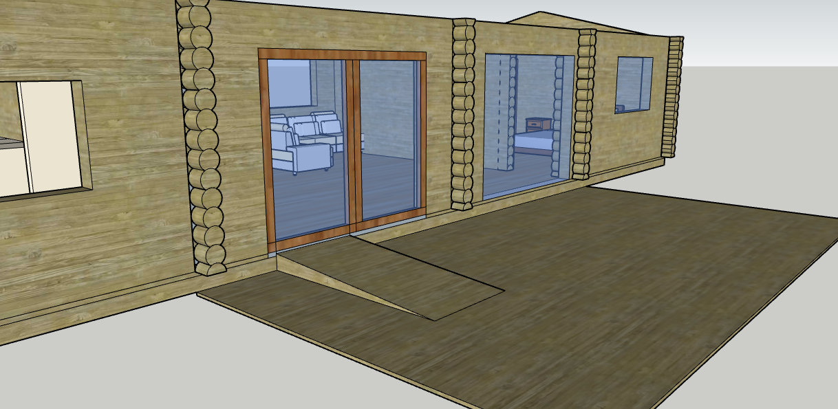

iSelfBuild Posted June 4, 2020 Posted June 4, 2020 Keen to hear peoples thoughts on this. I'm just about to start my project (a disabled compliant mobile log cabin) The difference between inside and outside floor levels is 195mm - the exit onto the deck is through level threshold sliding doors - all be it with a step down onto the balcony - the reason being I want a half decent splash zone for the logs and I want access behind the 150mm timber fascias which covers the steel universal floor beam structure. There is a 800mm roof overhang all along the deck so shouldn't be too much of a splash zone anyway. I don't think this is too ridiculous of a step down out onto a decking is it? I am going to construct a timber ramp which can be installed for guests who require disabled access. This will fit under a stepped lip on the sliding door thresholds so will be about 175mm drop over 2100mm. This would project out onto a 4m x 10m decking area so won't eat into too much activity space. Would a ramp of 1:12 also be permitted for the entrance door?
nod Posted June 4, 2020 Posted June 4, 2020 I’m guessing you are looking for a sign off certificate Picture is the minimum that our Building control would accept
scottishjohn Posted June 4, 2020 Posted June 4, 2020 you must have a flat area at the door -not a continuos ramp the spec is inthe building regs
DevilDamo Posted June 5, 2020 Posted June 5, 2020 You’re wanting to construct a disabled complaint mobile log cabin but will be looking to install what I can make out is a temporary ramp for those disabled persons that need it? I assume this has nothing to do with Building Regulations and you are just wanting to cover all bases/scenarios?
Ferdinand Posted June 5, 2020 Posted June 5, 2020 (edited) Is it better to make it level, but with a gap (150-200mm?) between the fascia and the deck, and a little bridge at the door threshold? That would require a lip to the decking, but would prevent any need to bugger about with ramps between guests etc. Will your staff - whoever they are - be able to move a ramp that size? Edited June 5, 2020 by Ferdinand 2
iSelfBuild Posted June 5, 2020 Author Posted June 5, 2020 (edited) 7 hours ago, scottishjohn said: you must have a flat area at the door -not a continuos ramp the spec is inthe building regs Caravans are out of scope of building regulations. But I still want to comply with easy access as obviously the whole point is to make it comfortable and accessible for wheel chairs. So even though the building regulations say it needs to be level. If a disabled person can access with a ramp then that is enough for me. Edited June 5, 2020 by iSelfBuild
iSelfBuild Posted June 5, 2020 Author Posted June 5, 2020 5 hours ago, DevilDamo said: You’re wanting to construct a disabled complaint mobile log cabin but will be looking to install what I can make out is a temporary ramp for those disabled persons that need it? I assume this has nothing to do with Building Regulations and you are just wanting to cover all bases/scenarios? Correct
iSelfBuild Posted June 5, 2020 Author Posted June 5, 2020 1 hour ago, Ferdinand said: Is it better to make it level, but with a gap (150-200mm?) between the fascia and the deck, and a little bridge at the door threshold? That would require a lip to the decking, but would prevent any need to bugger about with ramps between guests etc. Will your staff - whoever they are - be able to move a ramp that size? I thought about this and wondered if I could have like a floor grill grate or something. Or I could just fibreglass the sides with roofing spec stuff so stop any dampness against the steel floor chassis. I just don't like the idea of stuff butted up against it allowing it to rust!

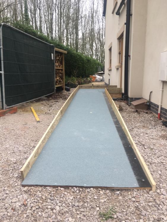

iSelfBuild Posted June 5, 2020 Author Posted June 5, 2020 7 hours ago, nod said: I’m guessing you are looking for a sign off certificate Picture is the minimum that our Building control would accept Is this 1:20 ?
scottishjohn Posted June 5, 2020 Posted June 5, 2020 8 hours ago, iSelfBuild said: Would a ramp of 1:12 also be permitted for the entrance door? why are you asking? -you already have said caravans don,t have to comply to regs I think its very short sighted to to do it your way and If i were a disabled person i would not be back a second time to yout chalet and would give it a bad right up access is everything for the disabled don,t be a peasant build it right first time lift the deck up and have wee strip of s/sgrid between chalet and deck so water don,t go to chalet wall you stuill got to have a ramp for wheelchair to get to the deck
scottishjohn Posted June 5, 2020 Posted June 5, 2020 50 minutes ago, iSelfBuild said: You’re wanting to construct a disabled complaint mobile log cabin well you will succeed at that -.but i ithink you meant compliant LOL
iSelfBuild Posted June 5, 2020 Author Posted June 5, 2020 9 minutes ago, scottishjohn said: why are you asking? -you already have said caravans don,t have to comply to regs I think its very short sighted to to do it your way and If i were a disabled person i would not be back a second time to yout chalet and would give it a bad right up access is everything for the disabled don,t be a peasant build it right first time lift the deck up and have wee strip of s/sgrid between chalet and deck so water don,t go to chalet wall you stuill got to have a ramp for wheelchair to get to the deck Many shops and public buildings are adapted to be accessible to disabled people and make use of ramps don't they? I'm just trying to find a happy medium between comfortable access and following full building regulations to the T - where I don't need to. On the whole, I find this forum useful to bounce ideas and soundboard suggestions from (on the most part) very helpful members. So that's why I'm asking... I could just ignore it all as I may not ever even have a disabled guest or crack on with my original idea and find it's not comfortable for disabled people down the line. The aim is to have a level access to the decking wrapping around the side of the cabin, not sure yet if it's feasible with levels on site but it should be. That's another reason why I wanted a drop down with a ramp as then it stops this wrap around access being butted against the cabin. I have a sauna and grill house up on the peak of the site which is not going to be accessible for wheel chairs and a wood fired hot tub which wont be accessible.
scottishjohn Posted June 5, 2020 Posted June 5, 2020 (edited) once you say diasabled access in your adverts --the expect claims if someone hurts themselves and thier solicitor uses normal build regs to define "disabled access" and if the regs are changed in the future to include caravan sites ,which must be quite likely --then you going to have to do it later anyway If you have seen these removable ones that councils use -to get round the regs ,cos its an old building --they are not small or light to move about and need storage when not in use and at 175mm drop from sliding door to deck you would need a flat standing area at half the height as well,even if it was just foot traffic design the need for it out of the project now same as you will need edges and handrails on the decking ,so wheel chairs can,t roll off I take it the shower room is a wet room with wheel chair access as well I,m sorry you don,t think I,m being hlepful -- i consider I am being very helpful and saving you making expensive mistakes now which can be designed out -- Edited June 5, 2020 by scottishjohn
