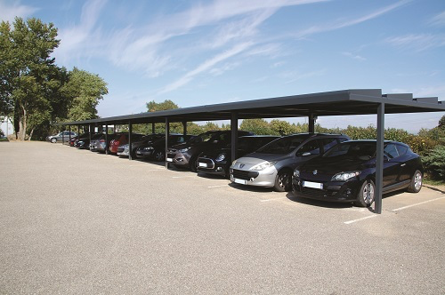

Nickfromwales Posted June 4, 2020 Share Posted June 4, 2020 They’re not cheap for anything robust, so decide how much you want to part with before mentioning car port or “solar pergola”..... This is what is in the NSBRC if you want to go and see one in the flesh; https://en.irfts.com/pergosolar/ The one there is 2 panels deep ( landscape ) by 3 panels wide, measuring in at 6m x 2.5m give or take. Supply and fit for that is ~£10k including delivery and installation, so a big chunk of change! The aluminium system above is very nice tbh and includes such trinkets as a hidden rainwater runoff system, which has the down pipes in the legs, but after hearing the price most run off in the nearest opposite direction. I’d consider putting an in roof system over an oak frame setup if you want the best bang for your buck. At 4x7 you could get an on-roof setup with 16 panels ( 4x4 landscape ) but for a much nicer look you’ll need 4.5x 7.2 to allow for an in roof setup which will look a LOT nicer. 16 panels @285w pp will give you 4.5kWp gross output, so would not be insignificant, but you could go up to 330w pp and then you’d be looking at over 5.2kWp. Do a survey for shading as that will dictate what you’ll end up with from each solar day, and then start the maths as to what is sensible to invest vs the estimated break even point and RoI over the next 25 years. 1 Link to comment Share on other sites More sharing options...

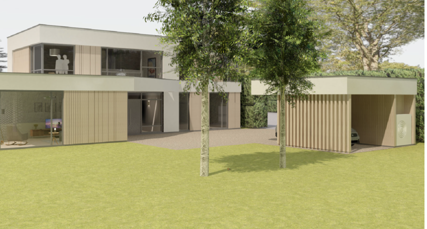

tanneja Posted September 16, 2021 Share Posted September 16, 2021 @AliG did you continue to look at a carport? If yes would you mind sharing your decisions? I am considering a carport, 6x6, unsure if I need PP as will be behind the further forward part of the house, but would be relatively close to the boundary edge (within 2 m). I am a corner plot so I am on show to the rest of the neighbours. Used to have a lean-to carport and it was so helpful throughout the years. Being able to integrate solar into the roof where I couldn't to our main roof would be a real bonus, it wouldn't get late evening sun as would get into the shade cast by the house, but uninterrupted the rest of the day. Is there a way to have the roof watertight but it not act like a big sail during strong winds? I would expect a kind of gutter design permitting airflow but prevents rain and sunlight getting through. Link to comment Share on other sites More sharing options...
AliG Posted September 16, 2021 Share Posted September 16, 2021 We did decide on a carport, as much as anything it is a little cheaper and also looks less bulky, making it easier to see the garden as you enter the property. The saving is not enormous, it mainly comes from the foundations. I think if you are on a corner and the side where the carport faces the road then it will need planing permission. Effectively, a corner is like having two fronts. The roof has to be designed to take windloads, we will have an SE look at ours. I will put the cabling in to connect the panels back to the house as it will be easy to add them to the roof. 1 Link to comment Share on other sites More sharing options...
tanneja Posted September 16, 2021 Share Posted September 16, 2021 Is that a rendering of the final plan? It sits harmoniously within the grounds and next to the house. Will the side walls make opening and closing the car doors a bit problematic? What size is is planned to be, it seems big enough for a single car? And so what size array will it have? Do you also have panels on the house roof? Our house is L shaped, and so any carport would sit in the middle of the L, essentially not in front of either principal elevation, but I take your point, it is the safer thing to do. Link to comment Share on other sites More sharing options...
AliG Posted September 16, 2021 Share Posted September 16, 2021 Thanks, it is a rendering of the final plan. The carport is 5.6mx5.6m. The space the car goes into is 3.3m wide and then there is a garden store at the other side. there was no need for two spaces so we decided a big space plus a store was better. The front of the store is 1.75m from the front of the roof so you can tuck the front of a car under there if you want. 1 Link to comment Share on other sites More sharing options...
