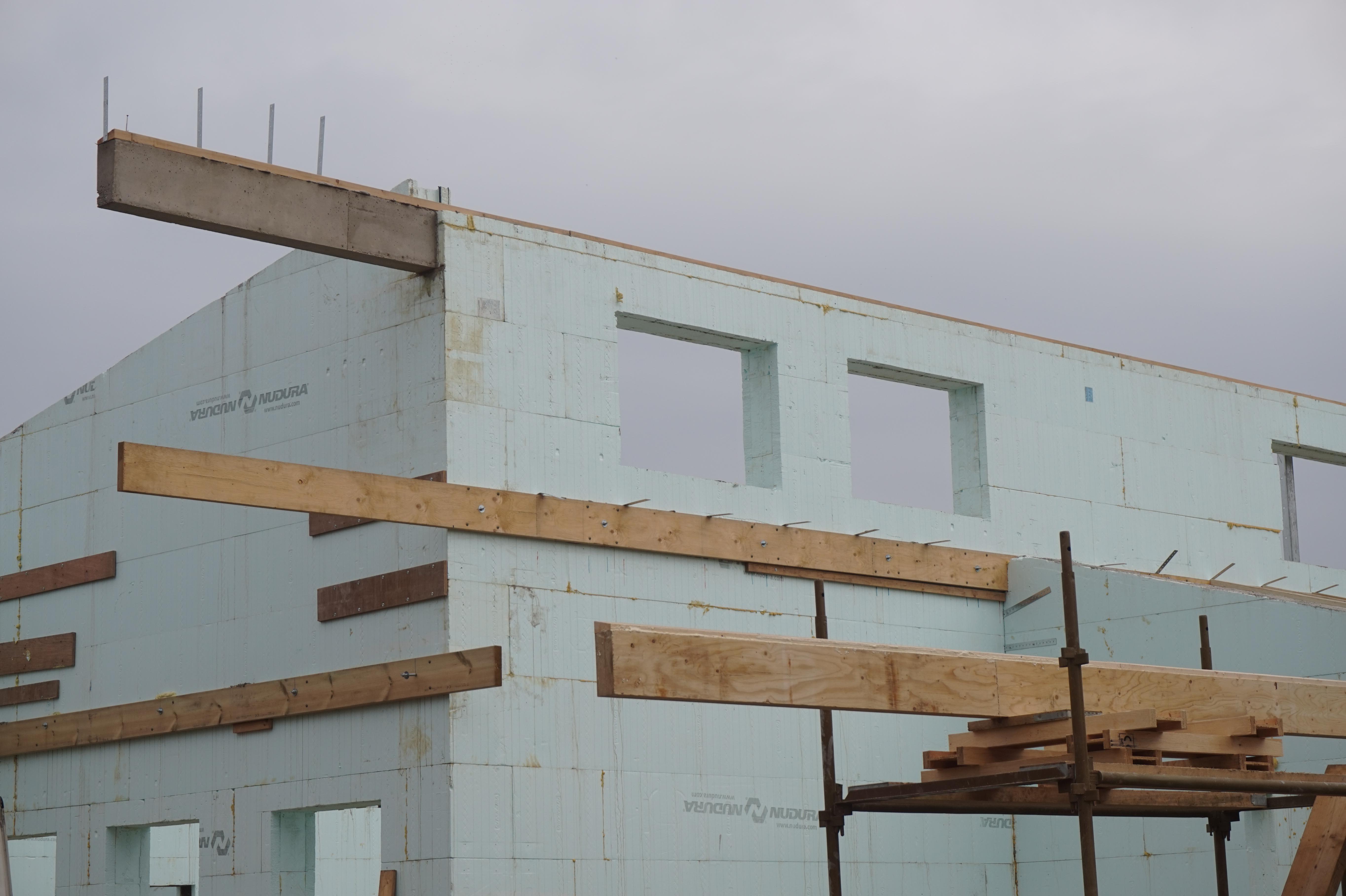

Vijay Posted May 27, 2020 Posted May 27, 2020 I bought a load of treated 6 x 2 C24 regularised timber just under 2 weeks ago, for some wall plates on my ICF build. I had an issue with some of them when I unpacked them, being twisted - so supplier exchanged those. What I'm finding is more of them are twisting - making them useless. Should this be happening and what can I do to stop it from happening??????? Cheers Vijay

Declan52 Posted May 27, 2020 Posted May 27, 2020 Look down the length and Mark where it starts to twist and cut this section out. I don't see how any timber wouldn't end up like that during this spell of great weather.

Russell griffiths Posted May 27, 2020 Posted May 27, 2020 @scottishjohn how Vijay describes it is exactly how it’s done, why would you drill the concrete if you don’t need to, I fixed all mine like this, far cheaper, no drilling and no expensive bolts, just threaded rod and a nut and washer.

Russell griffiths Posted May 27, 2020 Posted May 27, 2020 (edited) @Vijay can you not use a kerto beam instead of solid timber. Its like a big plywood gluelam. My pole plates are all kerto beams, straight as a die. Edited May 27, 2020 by Russell griffiths
scottishjohn Posted May 27, 2020 Posted May 27, 2020 8 minutes ago, Russell griffiths said: scottishjohn how Vijay describes it is exactly how it’s done, why would you drill the concrete if you don’t need to, I fixed all mine like this, far cheaper, no drilling and no expensive bolts, just threaded rod and a nut and washer. and thenyou swopped for correct dimension beam after concrete pour? that i understand -you are really just making a jig to hold concrete fixings in correct postion ? but he is complaining beams are bent and worried that they will distort his wall which to me says he is trying to tighten it all up now before the pour
Russell griffiths Posted May 27, 2020 Posted May 27, 2020 @scottishjohn I didn’t swap out anything I fixed it all in and then poured the concrete. However I didn’t use solid timber, I hate it, it’s rubbish. I used kerto beams which are a glue lam but for structural work not for show, so they have a rough unfinished surface not ready to varnish. Very good in long lengths with no twist or warping, I think I had some 8m long. 1
Alexphd1 Posted May 27, 2020 Posted May 27, 2020 (edited) It has gotten a bit of topic on how from how to straighten /prevent 6x2 timber from twisting to installing timber plates for 1st floor icf. @scottishjohn it would be a lot of work to remove beams and replace as you mention. This is a link on what we done (method 1) https://www.vancouvericf.com/nudura/technicalDetailsFloors.php with fixing the timber and pouring the concrete. Edited May 27, 2020 by Alexphd1
Vijay Posted May 27, 2020 Author Posted May 27, 2020 33 minutes ago, Russell griffiths said: @Vijay can you not use a kerto beam instead of solid timber. Its like a big plywood gluelam. My pole plates are all kerto beams, straight as a die. Never heard of them, will look into them. How pricey??
Russell griffiths Posted May 27, 2020 Posted May 27, 2020 Getting back to @Vijay issues I think I would chuck the wobbly wood over in a corner and buy a couple of kerto beams, i think with your system it could really mess you up if you need to fit your next channel on top and it twists.
