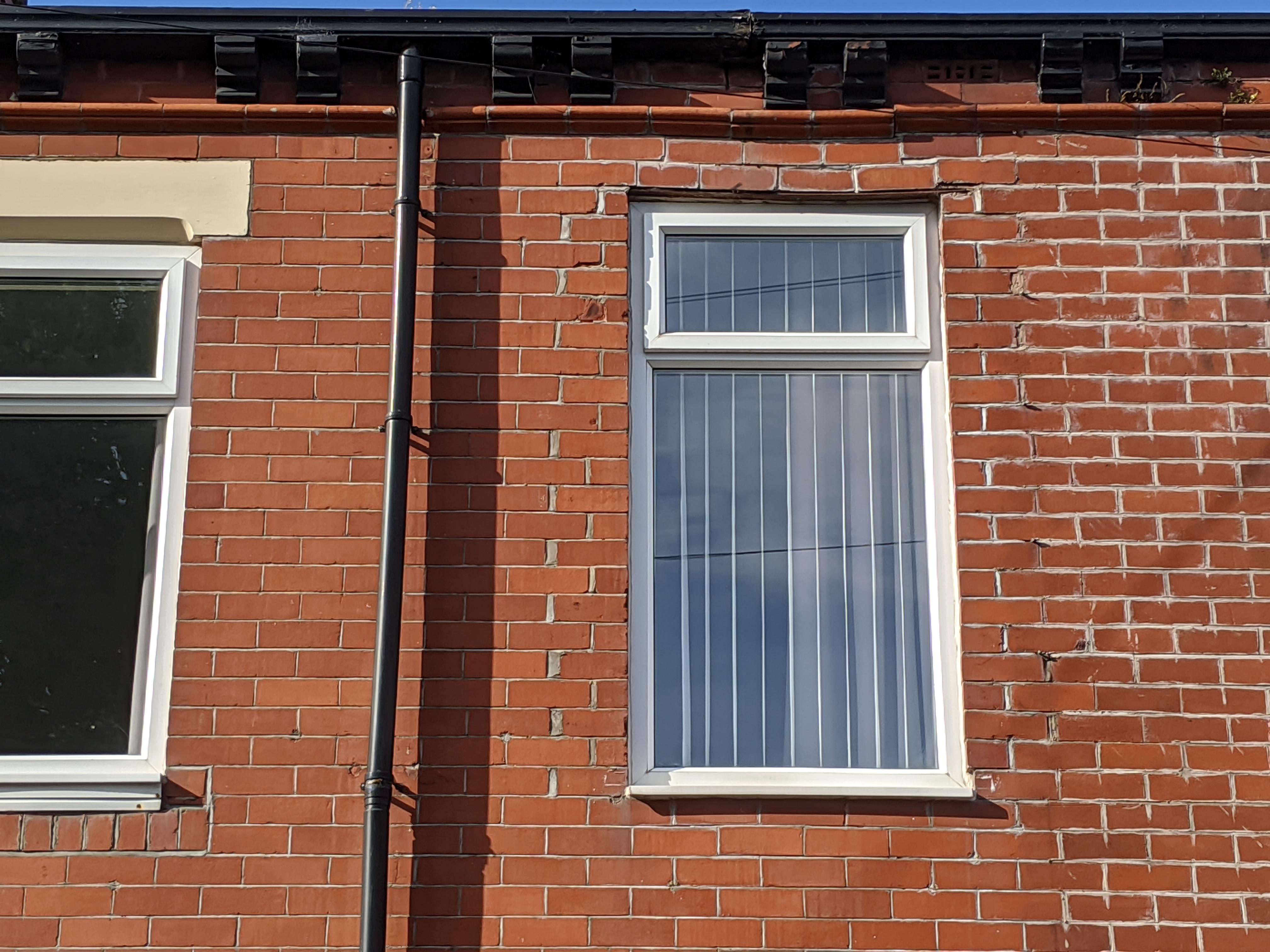

Tom T Posted May 26, 2020 Share Posted May 26, 2020 May 26, 2020 6:44 pm Hi all, I'm looking to sell my house and I'm wondering if the state of mortar around a window installation (done by the previous owner) is going to be an issue on a survey. I never noticed it till we decided to sell. There is no issues with damp or any problems from that window, it just looks abit suspect and I'm worrying it may be an issue if a full survey is to be carried out. If it will be an issue what am I looking at to correct it. Thanks Tom Link to comment Share on other sites More sharing options...
ProDave Posted May 26, 2020 Share Posted May 26, 2020 Where has the lintel gone? the brickwork is sagging with only the actual window holding it up. Yes that will be an issue probably blown out of all proportion by a surveyor. Link to comment Share on other sites More sharing options...

Temp Posted May 26, 2020 Share Posted May 26, 2020 (edited) Forget the width of the mortar perps. The lintel is the real problem. You might consider replacing the window with a wider one at same time as replacing the lintel. Have any other windows got lintel problems? Edited May 26, 2020 by Temp Link to comment Share on other sites More sharing options...
Roundtuit Posted May 26, 2020 Share Posted May 26, 2020 Looks like the old lintel (like your neighbours) has been taken out to put a taller window in, and maybe moved to the right a bit. It's been done badly with an undersized bit of steel so the brickwork has dropped. Not sure what's going on with the pointing to the right; looks like it's been painted on. I'd try and get it tidied up a bit - repoint above the window, make the gutter joint look better and get rid of the vegetation - and see what comes up on a survey. Link to comment Share on other sites More sharing options...
tonyshouse Posted May 26, 2020 Share Posted May 26, 2020 No real issues, very badly done job but it ain’t falling down, likely to be made into a mountain, hopefully not though Link to comment Share on other sites More sharing options...
