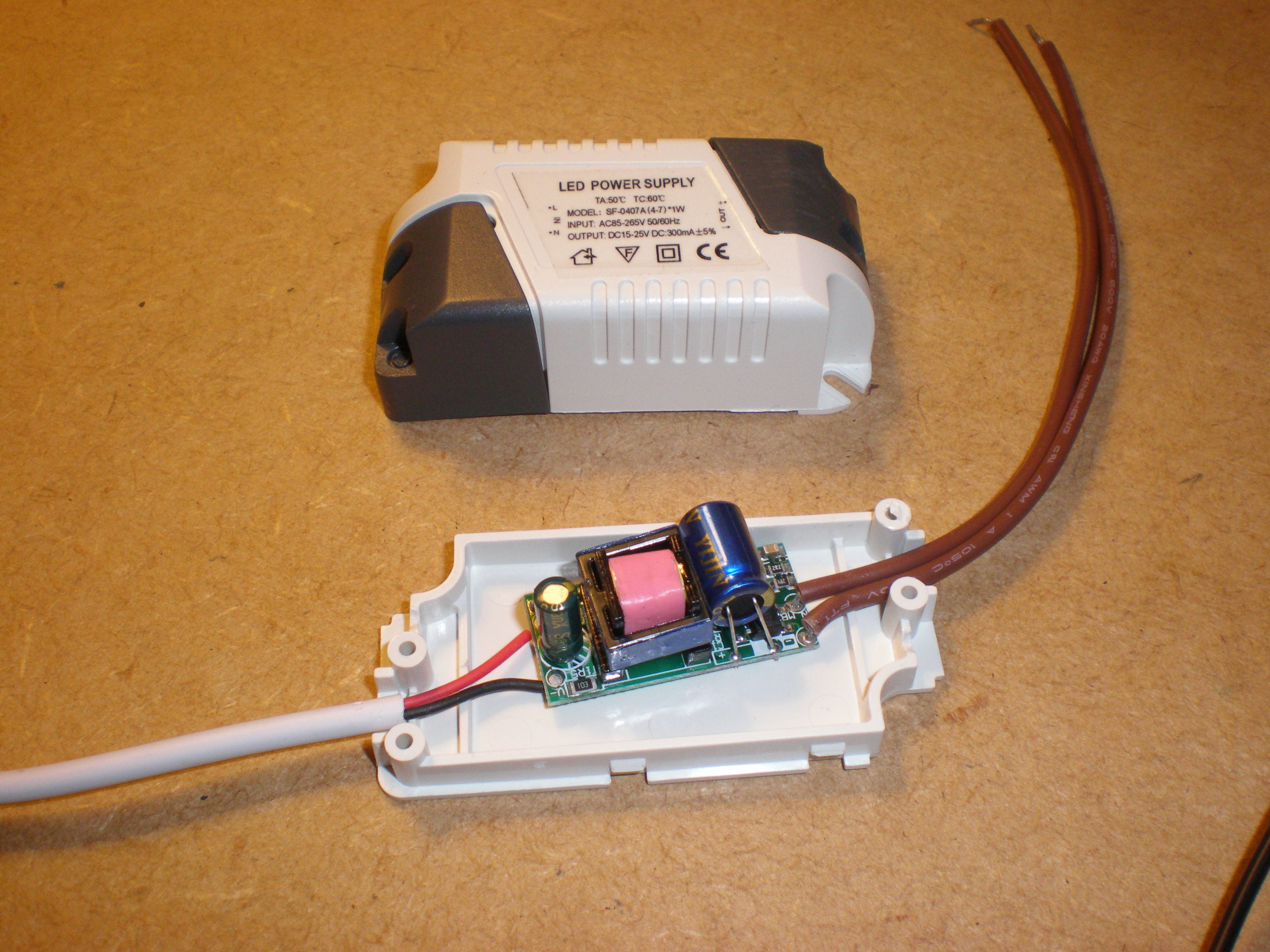

Stones Posted December 4, 2016 Share Posted December 4, 2016 Having ordered a few samples online, we have settled on a cheap but impressive flat panel LED lighting for our kitchen: http://www.ebay.co.uk/itm/I-LumoS-LED-RECESSED-LIGHTING-PANEL-15MM-SLIM-ROUND-SQUARE-CEILING-DOWNLIGHTS-/331607082056?var=&hash=item4d35528448:m:m9roqi3fZ_UkKwkwNZm1wlQ A driver is supplied (no interference with radio on those I tested) so all that remains the final connection between driver and mains cable. Having removed the cover from one of the drivers: the wires are soldered. I'm assuming a simple chocbox is the way to go to make and protect the final connection between the driver wires and mains cable? Link to comment Share on other sites More sharing options...

ProDave Posted December 4, 2016 Share Posted December 4, 2016 I doubt that CE mark means anything other than Chinese Electronics If it has a flying flex as it's input, is should be double insulated, as in a sheathed flex. That's glorified speaker wire there. I would be tempted to replace that speaker wire with some proper 2 core sheathed mains flex and then into a choc box or wago box if it's going to be in an inaccesible location. I would put one on an extended soak test to see how hot it gets. 2 Link to comment Share on other sites More sharing options...
Stones Posted December 5, 2016 Author Share Posted December 5, 2016 @ProDave how long would you suggest running one for as a test? I can certainly try replacing the input wires with sheathed flex - it'll be an interesting test of my soldering skills. If that's not going to work, is there anything else I can do, eg insulating sleeve over input wires, or is that just a recipe for disaster? Annoying thing is that these lights are perfect for what we want. It really is an absolute minefield... Link to comment Share on other sites More sharing options...
Gone West Posted December 5, 2016 Share Posted December 5, 2016 The cables are rated at 600V, 3A and 105C. I would have thought they would be fine but you could sleeve them with heat shrink. Link to comment Share on other sites More sharing options...
Nickfromwales Posted December 5, 2016 Share Posted December 5, 2016 Is it actually glorified speaker wire, or is it 230v rated stuff? Any writing on it? For testing, put it in a large Tupperware box and seal it in, but put it outside or do NOT leave unnatended. The unit will usually have the heat from the light adding to the running heat of the driver, so recreate that as best you can with the driver sat over the light. Much as leds are supposed to run very cool, these units do get quite warm. I bought these ones and they're fine. The 9w have a fantastic output. FWIW I just made them off with Wagos straight onto the twin and earth cables . No complaints from me, and just ordered 4 more to go in my boys ( work in progress ) attic conversion, due to the lack of head height. These also have excellent dispersion vs standard recessed GU10 / MR16 downlights, and can be bought IP66 too with no additional recessed depth. Remember that, afaik, you need to supplement these with additional fire proofing measures as they're not fire rates from what I can derive. Anyone know different. ? Link to comment Share on other sites More sharing options...

Stones Posted December 5, 2016 Author Share Posted December 5, 2016 @Nickfromwales, I don't have the driver in front of me just now, but I think out fair to say that the input and output wires are little more than bell wire - very insubstantial. I take it the ones you linked to don't have the wiring issues identified in the picture? Other question which someone may wish to answer, we have 12 lights planned for our kitchen covering a combined floor and worktop area of around 13m2. I had been thinking of 6W lights but just wondering if this would be too bright / overkill? Link to comment Share on other sites More sharing options...

Guest Alphonsox Posted December 5, 2016 Share Posted December 5, 2016 18 minutes ago, Stones said: Is radio interference the (main) reason you plan to swap them out? Yes - I don't see too much of a problem with the wiring. Dave is correct in that the mains wires should be double insulated but they are sat well out of harms way in the kitchen ceiling. I can't see any big issues. Link to comment Share on other sites More sharing options...

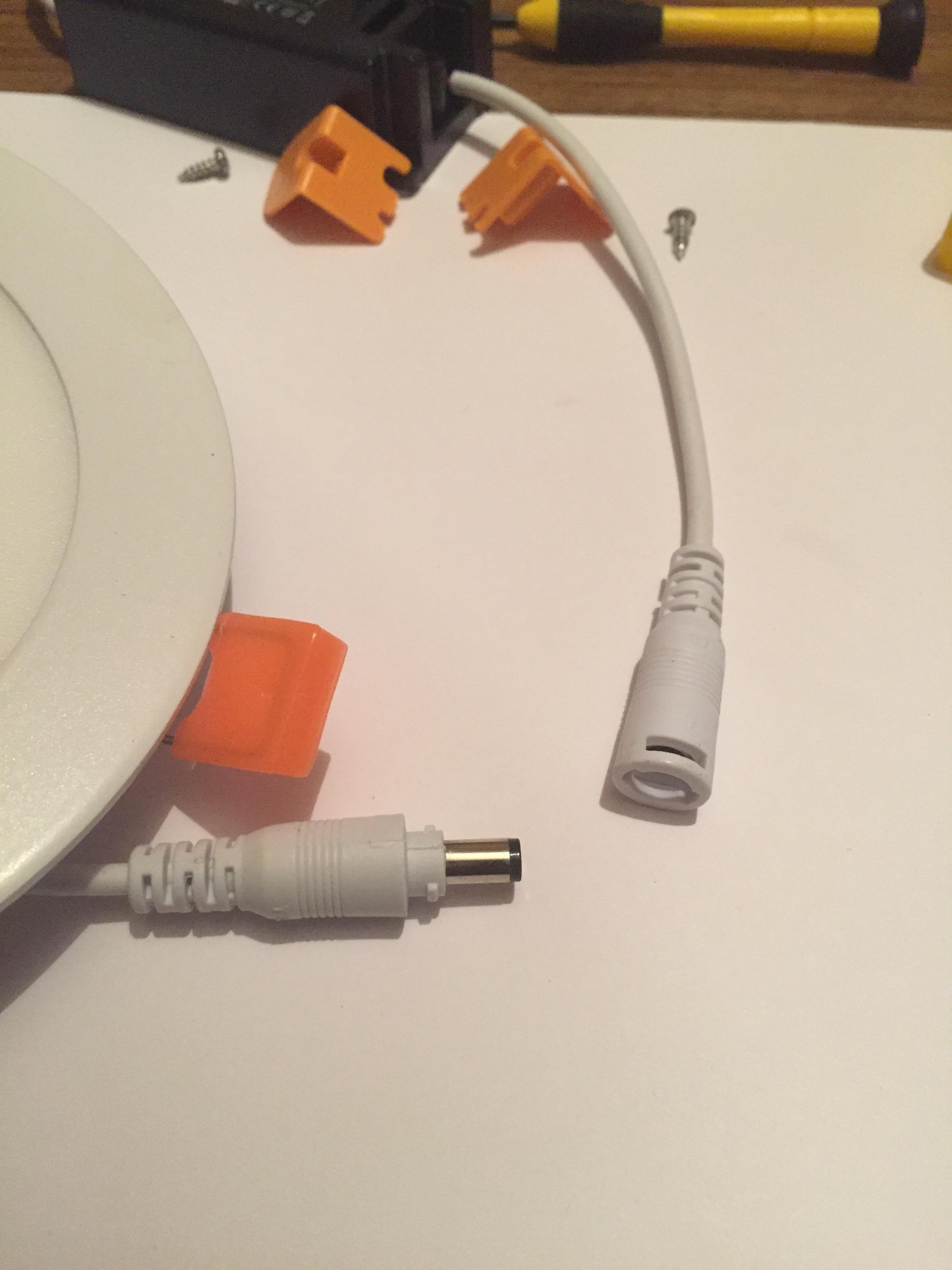

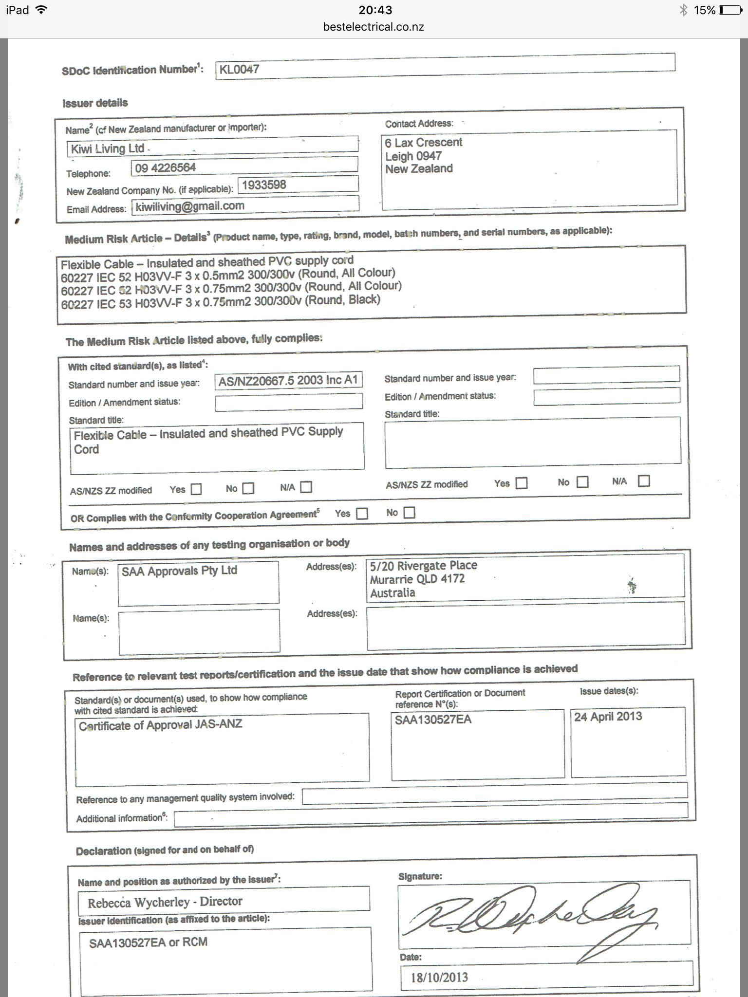

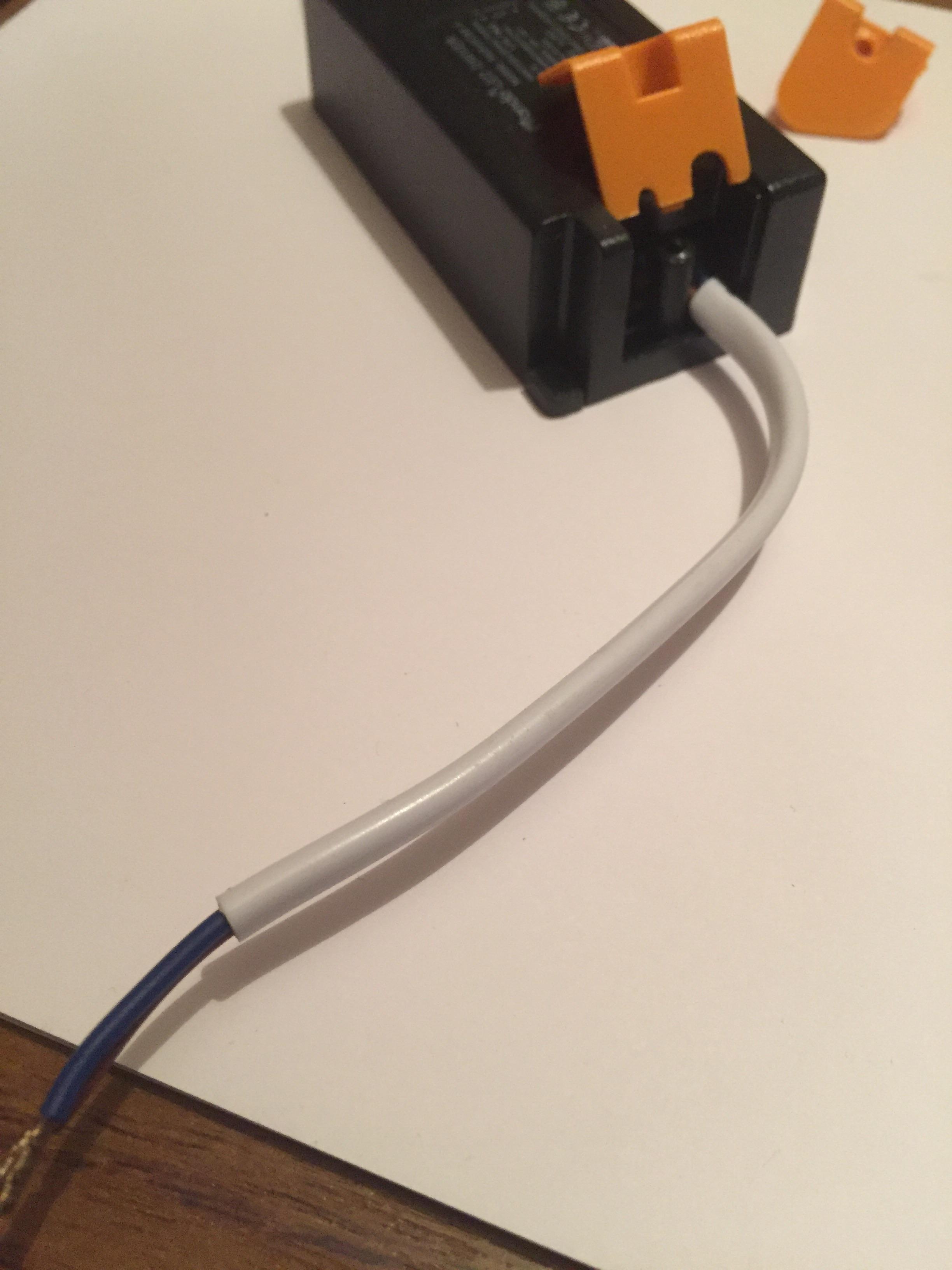

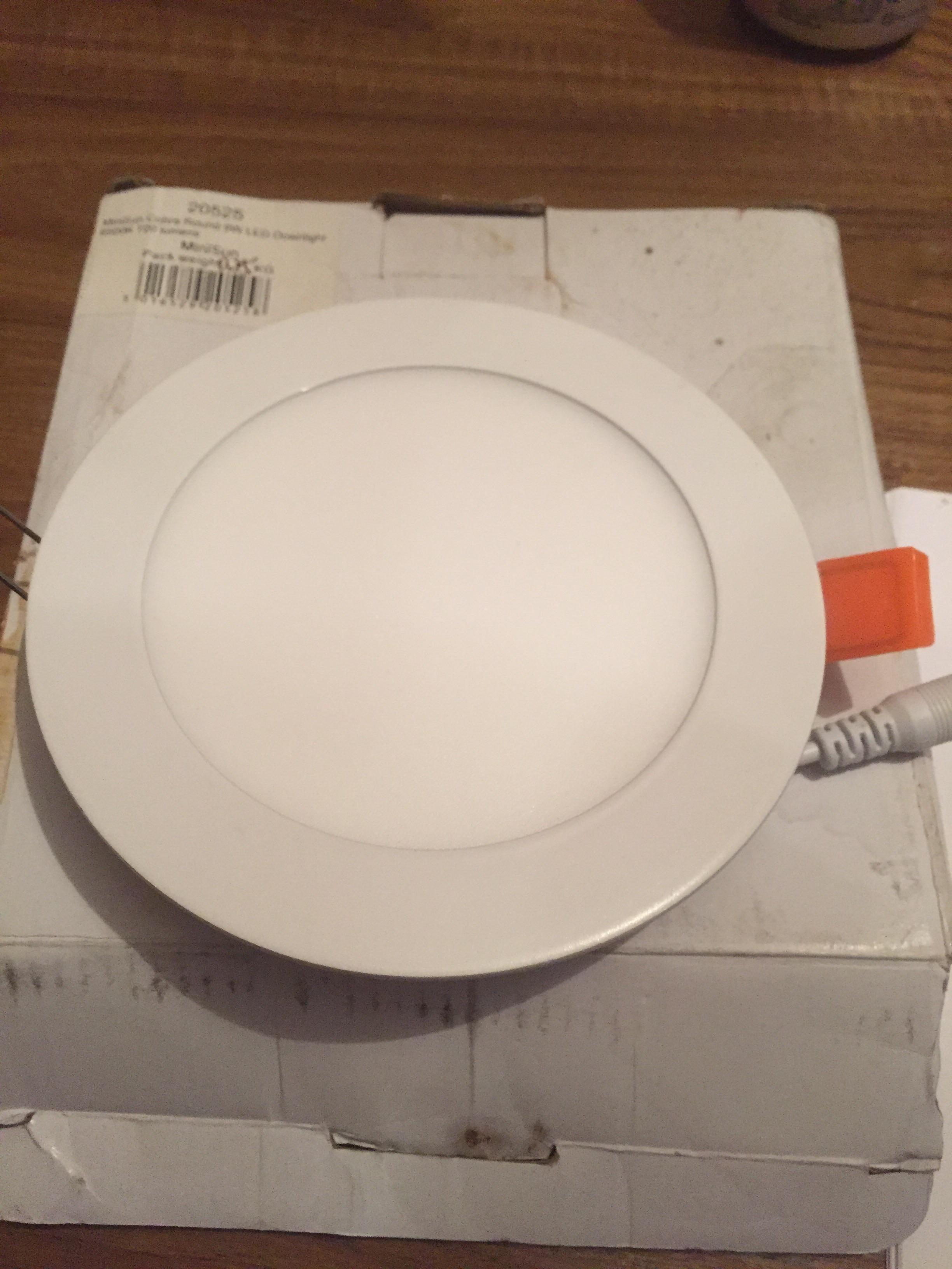

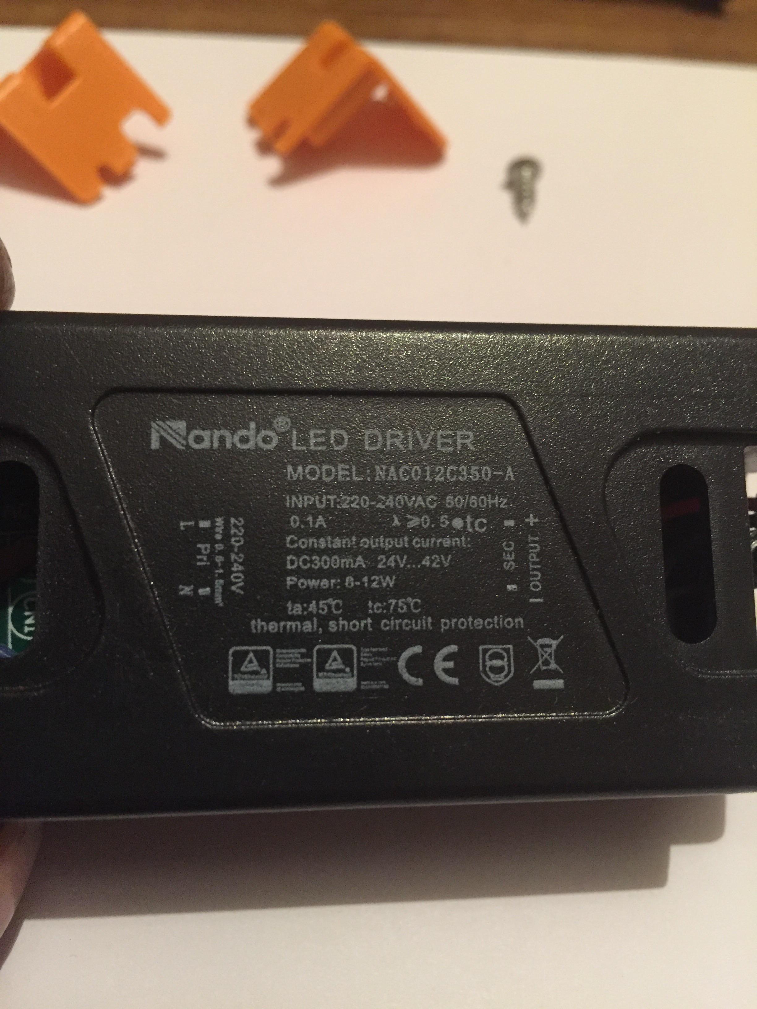

Nickfromwales Posted December 5, 2016 Share Posted December 5, 2016 On 5 December 2016 at 17:40, Stones said: I've just had a look at the link @Nickfromwales posted, the driver looks the same, down to the same unsheathed input wires. Hmmm. Seems that inconsistency may be a supplier problem too. The ones I got ( 9w ) as follows... Very handy twist to lock connectors to separate lamp from driver. Cord grip kind of provided by the orange cable clamp / cover Cable has writing and a CE mark and an SAA number which I googled briefly and got this. Long and short, the cable is certified and cosha for mains use . I had 3 of these running in a tiny bathroom. ( 1100mm x 3000mm ) and my DAB didn't blink when switching on / off and I'd foil lined the room with PIR sheets. I'd use these again in a heartbeat. Oh, and 6 for £40 delivered. Tres bien x2 Link to comment Share on other sites More sharing options...
Nickfromwales Posted December 5, 2016 Share Posted December 5, 2016 Just thought back and the 6w ones deffo did come with unsheathed input cables. Why the hell didn't they just supply these drivers with those lights?!? Link to comment Share on other sites More sharing options...
