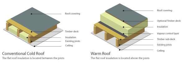

Simplifying it and picked at random but couldn't you just apply this warm roof technique to sloped, vertical and flat surfaces.
So basically ditch the existing tiles and felt, add a timber (OSB) deck.
Where the flat roof is insulate over the edge so it meets the vertical insulation and add a soffit detail AFTER.
If I went for EWI at ground floor I assume the VCL there would have to join to the roof's VCL.

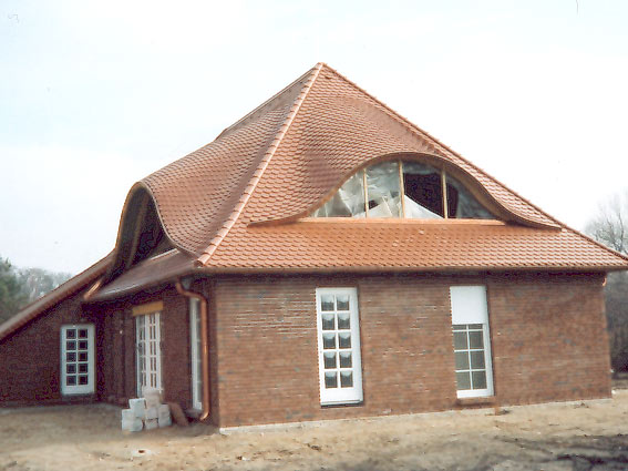

What is an "eyebrow roof"?
I dislike flat roofed dormers (I dislike flat roofs in general) and I dislike the side detail of most dormers (which is why on my new build I extended the pitched rood of the "dormers" all the way down making them more of a "gable end").  But you have what you have so need to make the most of it.
I would definitely strip it all off and convert it to a warm roof. You could always do it like mine, 100mm wood fibre board over the rafters (which is strong enough to span the gap without a support board under it) and then also fill the gap between the rafters, in my case with Frametherm 35 earthwool.  And I would definitely NOT replace the roof with felt, that is the work of the devil. Get a fibreglass roof cover put on it.
No reason not to do the same on the sides of the dormer as well and replace with new cladding, or just put the hanging tiles back if you can, at least they should last a long time unlike timber cladding so that's a detail I would seek to retain.
I think the reason a lot of dormers are so poor, is they just build them with sticks of 4 by 2 timber so there is never enough room to fit anything like enough insulation so they end up being the coldest part of the house. So over sheeting with external insulation is an easy way to improve that.

God's Blood forsooth - BDSM on an eyebrow window!
Is one of you called Max?
Do not buy a house with an old one. They are sods to insulate later.
Edited by Ferdinand
Sorry, I was getting mixed up with this Dormer.....it was all the curves:
