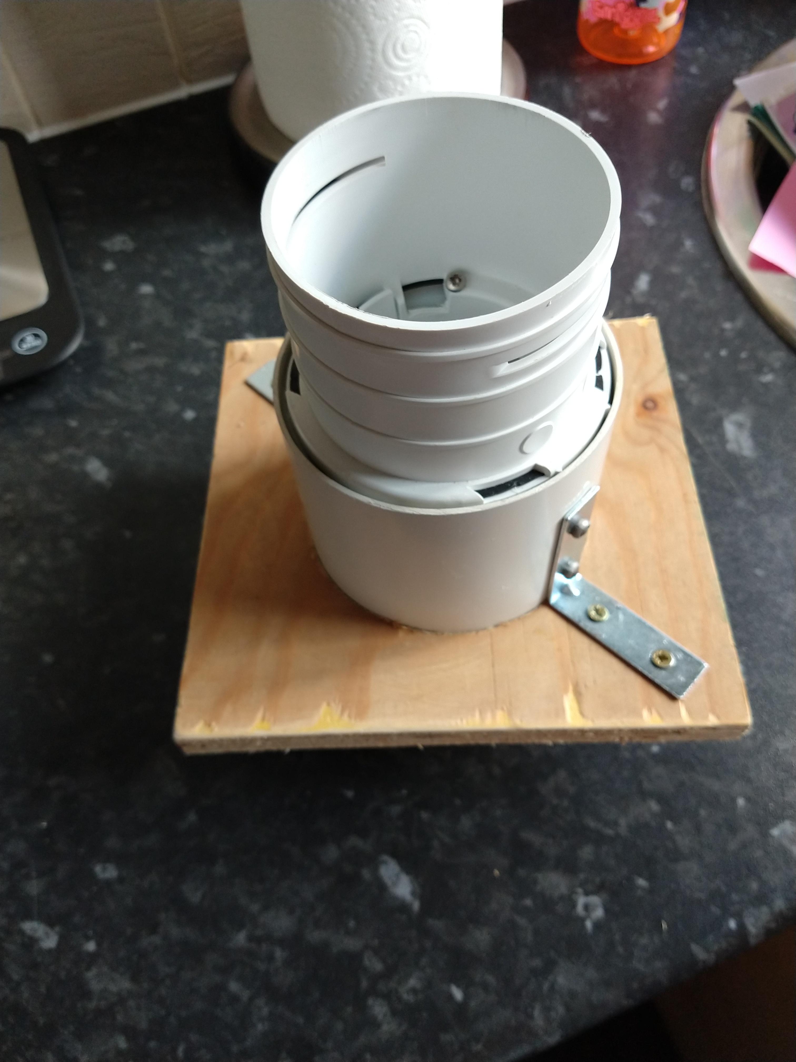

LeeV Posted July 10, 2022 Share Posted July 10, 2022 On 28/04/2020 at 20:35, JFDIY said: I went and cherry picked components from a few places based on quality, cost or location (I.e. I could collect in person) One thing I made extra effort to source was 150mm insulated ducting, I used the ubbink foam ducts as it looked easy to engineer the routes I wanted and no need to insulate separately after installation, can dismantle them for easy cleaning now installed as well. There's some pics in this thread. https://forum.buildhub.org.uk/topic/11747-silencer-can-it-be-mounted-horizontally/page/2/?tab=comments#comment-208334 Also made a few of my own vertical terminals for about £3 each, but mostly because I couldn't get exactly what I wanted Sorry to revive an old thread but I have a quick question if I may? Hi @JFDIY I've just come to the same conclusion that I need to make something, as spending £45 per supply/extract will cost more than the MVHR unit I've bought. I guess that is some ply for the base and 100mm rigid duct to connect to the ceiling vents, but what is that unit inside the duct? A 100mm to 90mm adapter maybe? Can I ask where you got them from? Link to comment Share on other sites More sharing options...
