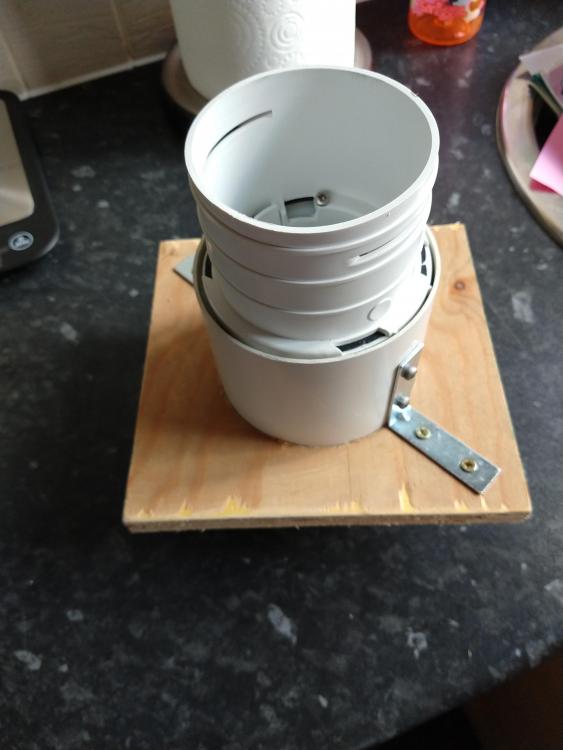

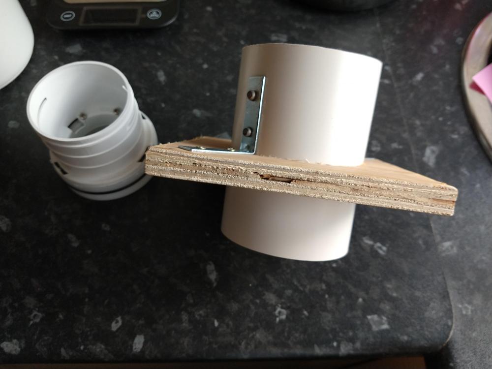

bluebirdnick Posted September 1, 2020 Author Share Posted September 1, 2020 I'm curious as to how everyone else has cut holes in ceilings for their plenums. 125mm seems to be the standard internal diameter for these things, but the external diameter is wider than a 127mm hole saw. The next standard size up is 152mm which would be far too big. I've only installed one, using an adjustable hole cutter but it is fair to say that this is less than ideal as it leaves a pretty rough finish and isn't particularly accurate - fitting the metal collar became an issue as I had no ceiling to take a screw. So what has everyone else been doing? Is there some standard hole saw out there that I've simply not found? Starrett make one at 133mm which might be about the right size - has anyone used and can confirm? It's £50+ so not a cheap bit of kit. Or are people cutting them freehand with a plasterboard saw? The adjustable hole cutter just about did the job but I want to avoid using it if possible. Link to comment Share on other sites More sharing options...
joe90 Posted September 1, 2020 Share Posted September 1, 2020 (edited) Is 140mm any good? https://www.ebay.co.uk/itm/110-200mm-Bi-Metal-M42-HSS-Hole-Saw-Cutter-Drill-Bit-For-Aluminum-Iron-Pipe-Wood/264636749412?hash=item3d9d945664:g:wkgAAOSwi0RXzm03 i made my own plenums, can’t remember the hole size now. Edited September 1, 2020 by joe90 1 Link to comment Share on other sites More sharing options...
bluebirdnick Posted September 1, 2020 Author Share Posted September 1, 2020 Thanks. For £8 it's worth a go. I've found a 133mm one for £18 too so will get them both and see. I need to drill two holes in brick too. I was expecting that a 127mm diamond core bit would do it (and my builder has a 127mm bit), but clearly it won't. So I'll need to find one that does, and a drill large enough to do the job. Link to comment Share on other sites More sharing options...

MJNewton Posted September 1, 2020 Share Posted September 1, 2020 5 hours ago, bluebirdnick said: I'm curious as to how everyone else has cut holes in ceilings for their plenums. 125mm seems to be the standard internal diameter for these things, but the external diameter is wider than a 127mm hole saw. The next standard size up is 152mm which would be far too big. I've only installed one, using an adjustable hole cutter but it is fair to say that this is less than ideal as it leaves a pretty rough finish and isn't particularly accurate - fitting the metal collar became an issue as I had no ceiling to take a screw. So what has everyone else been doing? Is there some standard hole saw out there that I've simply not found? Starrett make one at 133mm which might be about the right size - has anyone used and can confirm? It's £50+ so not a cheap bit of kit. Or are people cutting them freehand with a plasterboard saw? The adjustable hole cutter just about did the job but I want to avoid using it if possible. What plenums are you using, and are you sure they're not intended to be used with a short section of 125mm ducting between them and the ceiling terminal? (Thus meaning you'd be cutting a 125/127mm hole in the ceiling, which I thought was the de facto standard) 1 Link to comment Share on other sites More sharing options...
bluebirdnick Posted September 3, 2020 Author Share Posted September 3, 2020 On 01/09/2020 at 22:05, MJNewton said: What plenums are you using, and are you sure they're not intended to be used with a short section of 125mm ducting between them and the ceiling terminal? (Thus meaning you'd be cutting a 125/127mm hole in the ceiling, which I thought was the de facto standard) Airflow grey plastic ones, which have about 300mm of plastic duct as part of the unit. The video shows that the plastic duct sticking through the ceiling and then being cut so that the bottom of the plastic part of the duct is flush with the room side of the ceiling. So the hole needs to accommodate the outer diameter of the plastic part of the duct. However it does make me wonder if I'm doing this right. The room valves have a metal base plate that is inserted into the plastic duct and secured to the ceiling. It is quite large, but its outside diameter is clearly 125mm as it sits tightly inside the 125mm duct. Like this: So I wonder if actually I cut the plenum so that the 125mm plastic duct sits on top of teh ceilign rather than coming through it, and then poke the metal base plate up through the ceiling and into the grey duct that sits above it. I've got quite thick ceilings - probably about 40-50mm now - but the base plate is quite large and could span that gap. Link to comment Share on other sites More sharing options...
bluebirdnick Posted September 3, 2020 Author Share Posted September 3, 2020 On 01/09/2020 at 21:55, Jenni said: I've only cut 1 hole so far, but used a 135mm cutter, like this - https://www.ebay.co.uk/itm/154027640313 Thanks Jenni. I'm beginning to think I'd not looked hard enough for a hole cutter between 127mm and 152mm! I've got a 133mm starrett cutter arriving today and I think I'd still be happier with allowing the plastic plenum to poke through the ceiling and be cut so I suspect I'll use that and see how I go. It will take me weeks to get it done from here, I had a week at home last month to get things finished but for various reasons I was unable to do much. So now I'm left trying to fit it in on weekends and with a toddler and a newborn it is going to be a challenge! Link to comment Share on other sites More sharing options...

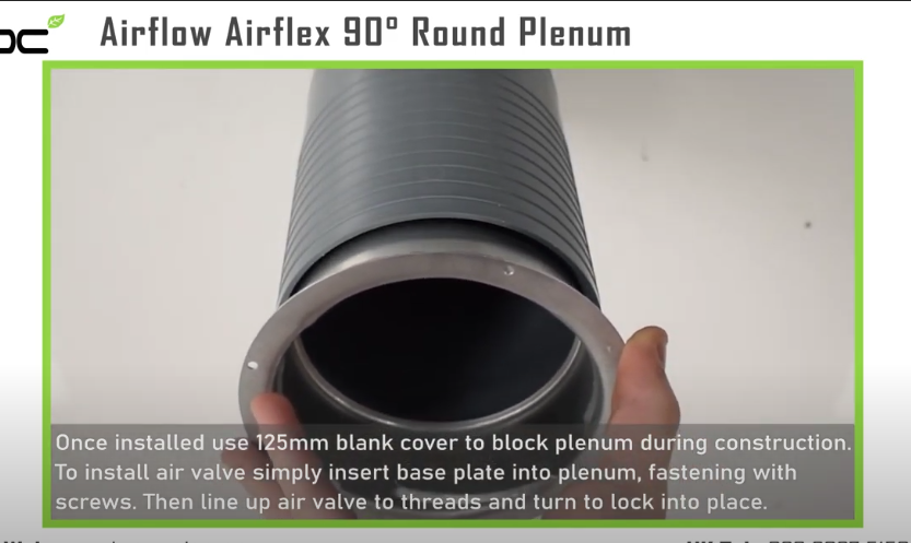

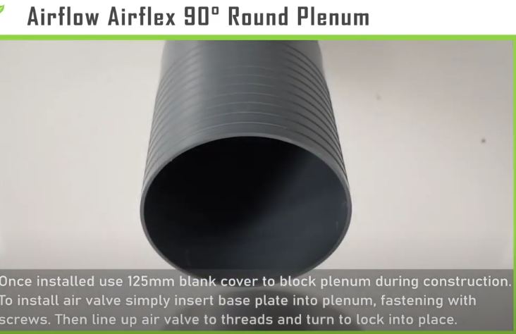

MJNewton Posted September 3, 2020 Share Posted September 3, 2020 (edited) 14 hours ago, bluebirdnick said: However it does make me wonder if I'm doing this right. The room valves have a metal base plate that is inserted into the plastic duct and secured to the ceiling. It is quite large, but its outside diameter is clearly 125mm as it sits tightly inside the 125mm duct. I think you are doing it right, and as you say there are photos/videos of these type of plenums protruding through the ceiling (prior to trimming). Indeed it's effectively what most are like, even those that have a separate top section and pipe. Have you enquired with BPC? Maybe it is standard practice to cut with a 125/127mm holesaw and then trim further with a drywall saw to fit. A shame as holesaws make beautifully neat holes with ease! Edited September 3, 2020 by MJNewton Link to comment Share on other sites More sharing options...
MJNewton Posted September 3, 2020 Share Posted September 3, 2020 (edited) To add: Whilst a bit late now, but maybe useful for the archives and others, I bought these from BPC which are half the price of the Airflow plenums and simply require a standard 125mm pipe (~£10/2m) to bridge the gap to the ceiling and vent: Is it too late to return yours? For £12 saving per plenum - not to mention a simpler life (got a 3rd old myself so I understand the need for that!) - I'd recommend doing so if you can... Edited September 3, 2020 by MJNewton 1 Link to comment Share on other sites More sharing options...

bluebirdnick Posted September 5, 2020 Author Share Posted September 5, 2020 (edited) Thanks all. I have the Domus plenums too: I bought both types to see what the difference was, and in some cases I need the duct part to be over 300mm. I'd like one of those cowls - the mess these holes make is phenominal, in particular as I've boarded over old lath and plaster ceilings. But now I have a 133mm hole saw I'm not sure how I'd use the two together. I'll have a play. Edited September 5, 2020 by bluebirdnick Link to comment Share on other sites More sharing options...
tanneja Posted January 27, 2021 Share Posted January 27, 2021 On 03/09/2020 at 23:36, MJNewton said: To add: Whilst a bit late now, but maybe useful for the archives and others, I bought these from BPC which are half the price of the Airflow plenums and simply require a standard 125mm pipe (~£10/2m) to bridge the gap to the ceiling and vent: These have been out of stock for a while with BPC but seem to be back. Did you have to do anything special when fitting your 125mm pipe to ensure a good fit / no air leakage? Airtight tape around the junction? Link to comment Share on other sites More sharing options...
MJNewton Posted January 27, 2021 Share Posted January 27, 2021 4 hours ago, tanneja said: Did you have to do anything special when fitting your 125mm pipe to ensure a good fit / no air leakage? Airtight tape around the junction? They were a reasonably good interference fit but, yes, for completeness I did run some aluminium tape around the join (on the inside as access was easier). 1 Link to comment Share on other sites More sharing options...
