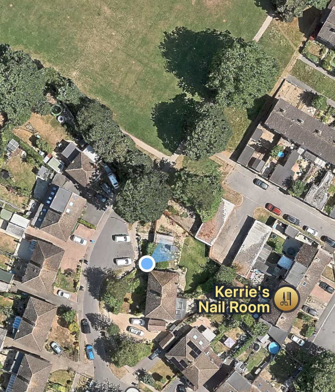

Looking at that aerial view I see another detached house on the other side of the road.  Was that also built after the original houses on the side garden?
How does that one opposite compare in size and bulk to what you are proposing?  It looks to me only slightly wider than the original semi detached houses with a single storey garage.  If you submitted something like that, and it was still refused, you would have very good grounds to appeal.
Just because you have used a planning consultant to get this far, an appeal can be done yourself for virtually no cost if you are just appealing a refused application.
The house opposite was actually original although they have planning for a two storey (set back) side extension. I was attempting to mirror the street scene with my original proposal.

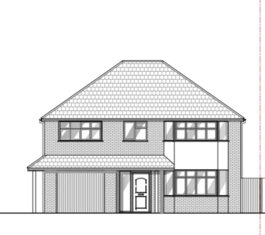

If you really want the double fronted, make the left hand half above the garage set back a little with a stepped roof line, making it look right from the start like a subservient extension on the side (probably like has been approved for the house opposite)
Good point and I would switch the garage to the right hand side to create more visual space to no 35.
Worth doing a few visuals.

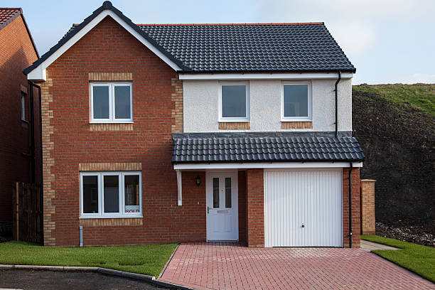

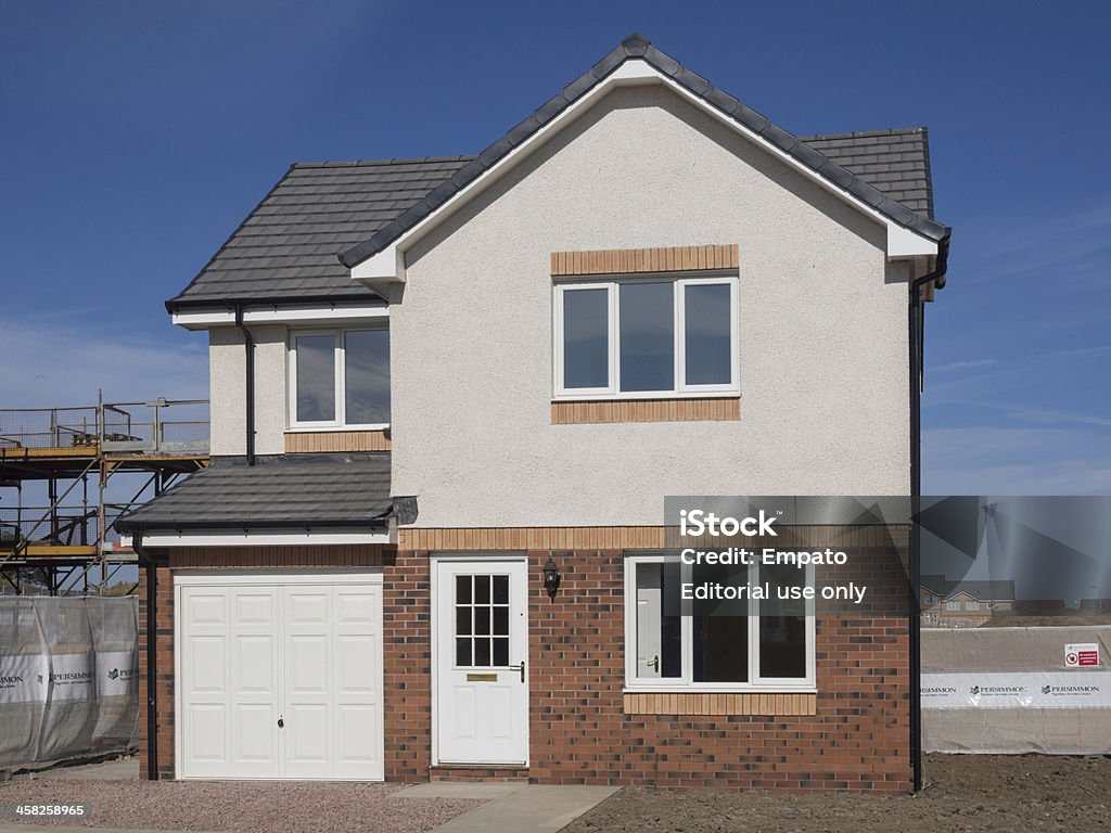

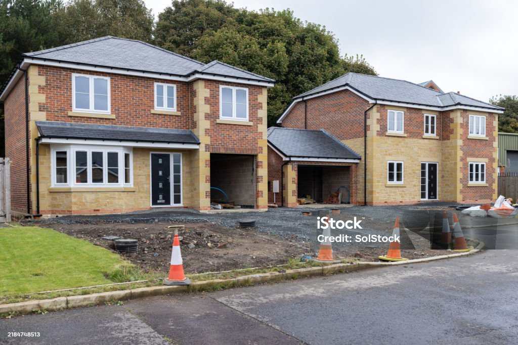

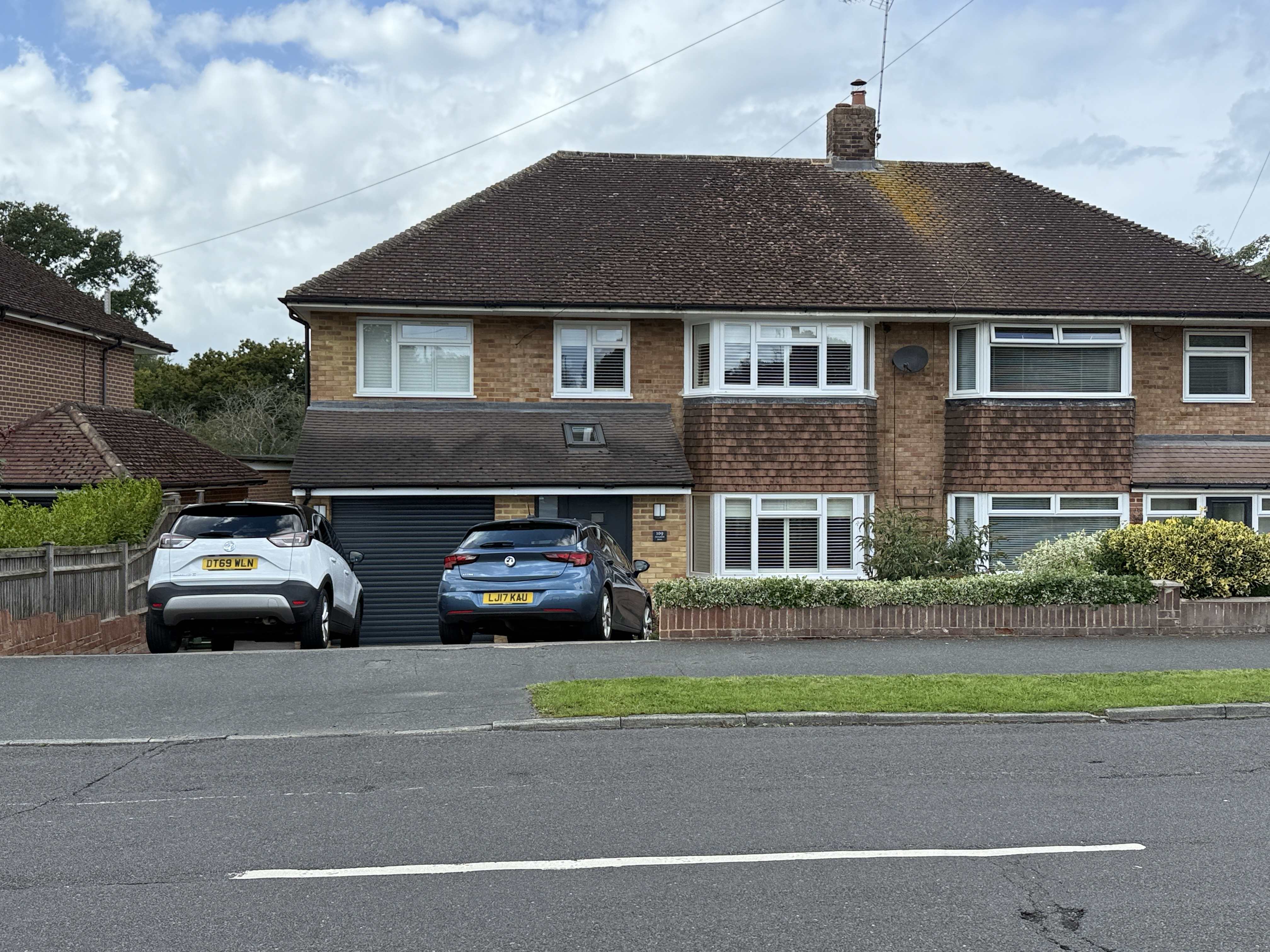

I have been attempting to replicate similar properties that have had extensions like this.
IMG_7150.thumb.jpeg.eae098a6e8f1ea5210fbad90313f6df3.jpegIMG_7143.thumb.jpeg.ecb129e3e4cb2d6f09d20f1c7beb56f4.jpeg
This was your second refusal?
Some random grabs from a quick search, 2 have a front facing gable which are probably not suitable and 2 hipped with garage on right hand side.

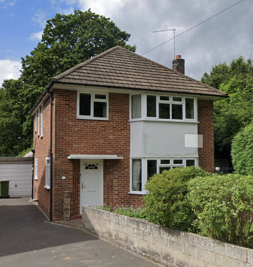

Looking at past planning applications, your neighbours have planning for only single storey extensions, the only 2 storey application was refused in 2006.
Enclosed are the drawings of the application for a 2 storey extension at no 33 back in 2006. Was refused.

does anyone think the case officer was correct in stating this was a "prominent corner plot", as i think this will be the main basis of my appeal.

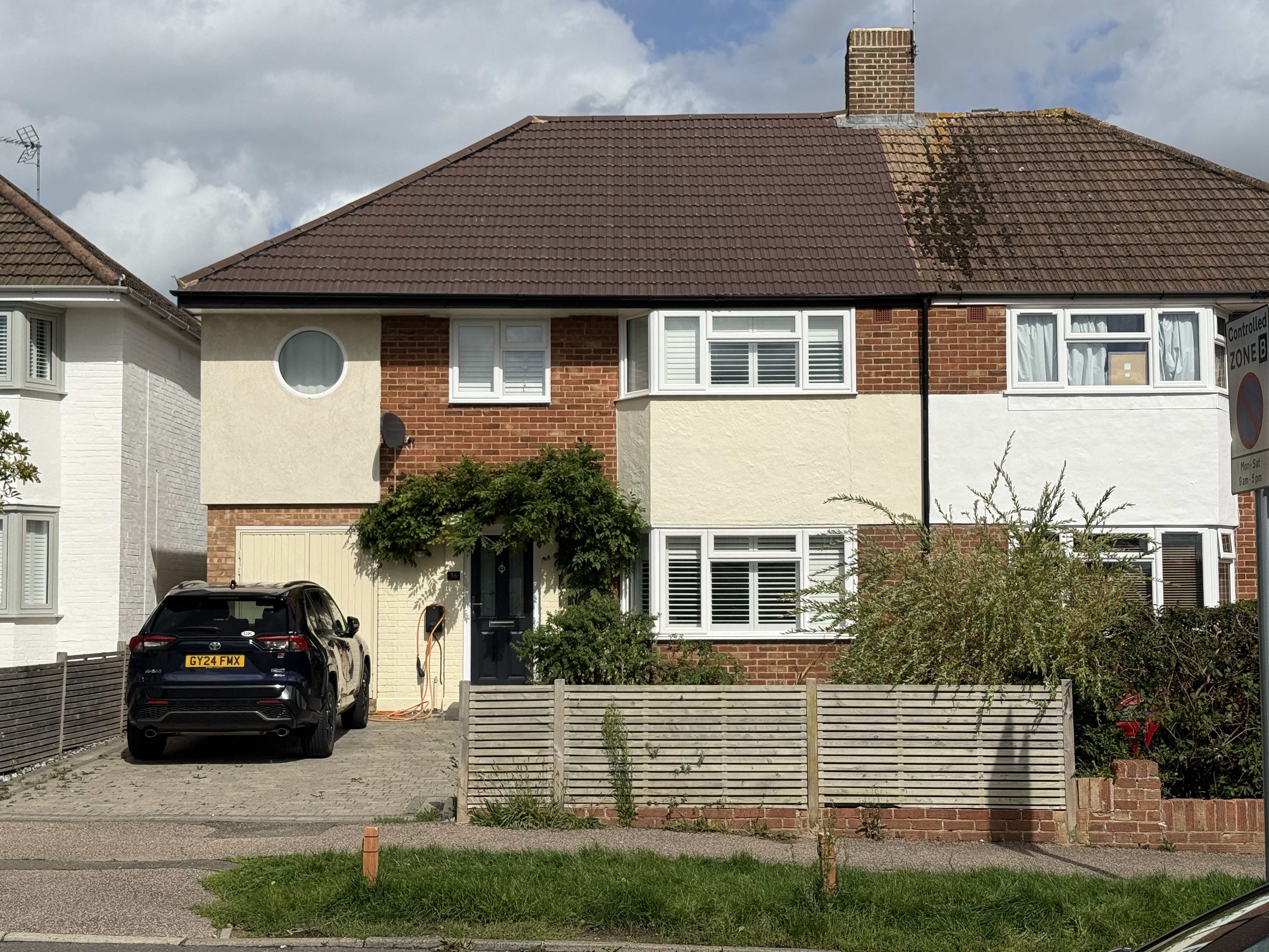

12 minutes ago, ProDave said:
With even fairly simple extensions like the post above being refused, I have to ask, are you in a conservation area?
It is all subjective but I would not call this " a prominent corner plot"  even though the case officer seems to be on your side.
It is overbearing and cramped.

No property in the street has had a  two storey extension built. All single storey wraparound.
Look at no 33 for ideas, looks like garage with a mono pitch roof or imagine no 42 with an attached garage.
On the face if it, no - "tucked away around the corner of a quiet cul de sac" sounds more appropriate, but if your street is the main walking route used by people to visit the park or whatever at the top of your aerial view then yes it would be prominent and a large house there might seem overbearing.

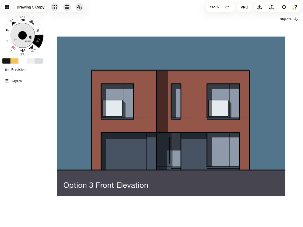

Just a few thoughts…..
Progress, Option 1. Huge improvement.
Great to see a contemporary new build design instead of rehashing the existing vernacular.
Personally, it is a tricky site with minimal parking for both properties, I think a 3 bed with attached garage would be acceptable.
"That valleys gonna give me problems down the line"?
I agree, but if you thought 19 objections last time was a lot, this will probably stir up more and open up other possible grounds for refusal (not in keeping with the area)
I. agree, you agree. It was really a comment on @ETC contributions.
Addressing overbearing and cramped should get this passed.
