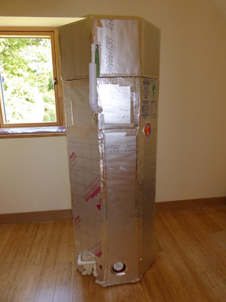

Jeremy Harris Posted April 23, 2020 Share Posted April 23, 2020 Some companies will spray a double thickness insulation layer on, if you request it. I had a thermal store double sprayed to increase the insulation level, but the company wouldn't/couldn't change the energy rating. 1 Link to comment Share on other sites More sharing options...

SteamyTea Posted April 24, 2020 Share Posted April 24, 2020 Rather than fret over the actual insulation on the cylinder, can you make the cupboard it is in insulated? I could only put a standard replacement in my cupboard, but then filled the gaps with a combination of mineral wool and sheet insulation. Over halved the thermal losses. 1 Link to comment Share on other sites More sharing options...
Russell griffiths Posted April 24, 2020 Share Posted April 24, 2020 12 minutes ago, SteamyTea said: Rather than fret over the actual insulation on the cylinder, can you make the cupboard it is in insulated? I could only put a standard replacement in my cupboard, but then filled the gaps with a combination of mineral wool and sheet insulation. Over halved the thermal losses. I did wonder the same, with all the insulation off cuts I have left, why could you not build a cupboard within a cupboard, so box the cylinder into the corner of the plant room. 1 Link to comment Share on other sites More sharing options...
Jeremy Harris Posted April 24, 2020 Share Posted April 24, 2020 4 minutes ago, Russell griffiths said: I did wonder the same, with all the insulation off cuts I have left, why could you not build a cupboard within a cupboard, so box the cylinder into the corner of the plant room. I did pretty much this, I added a layer of foamed on 50mm PIR insulation around our old thermal store. Reduced the heat loss by about 30% or so: 1 Link to comment Share on other sites More sharing options...

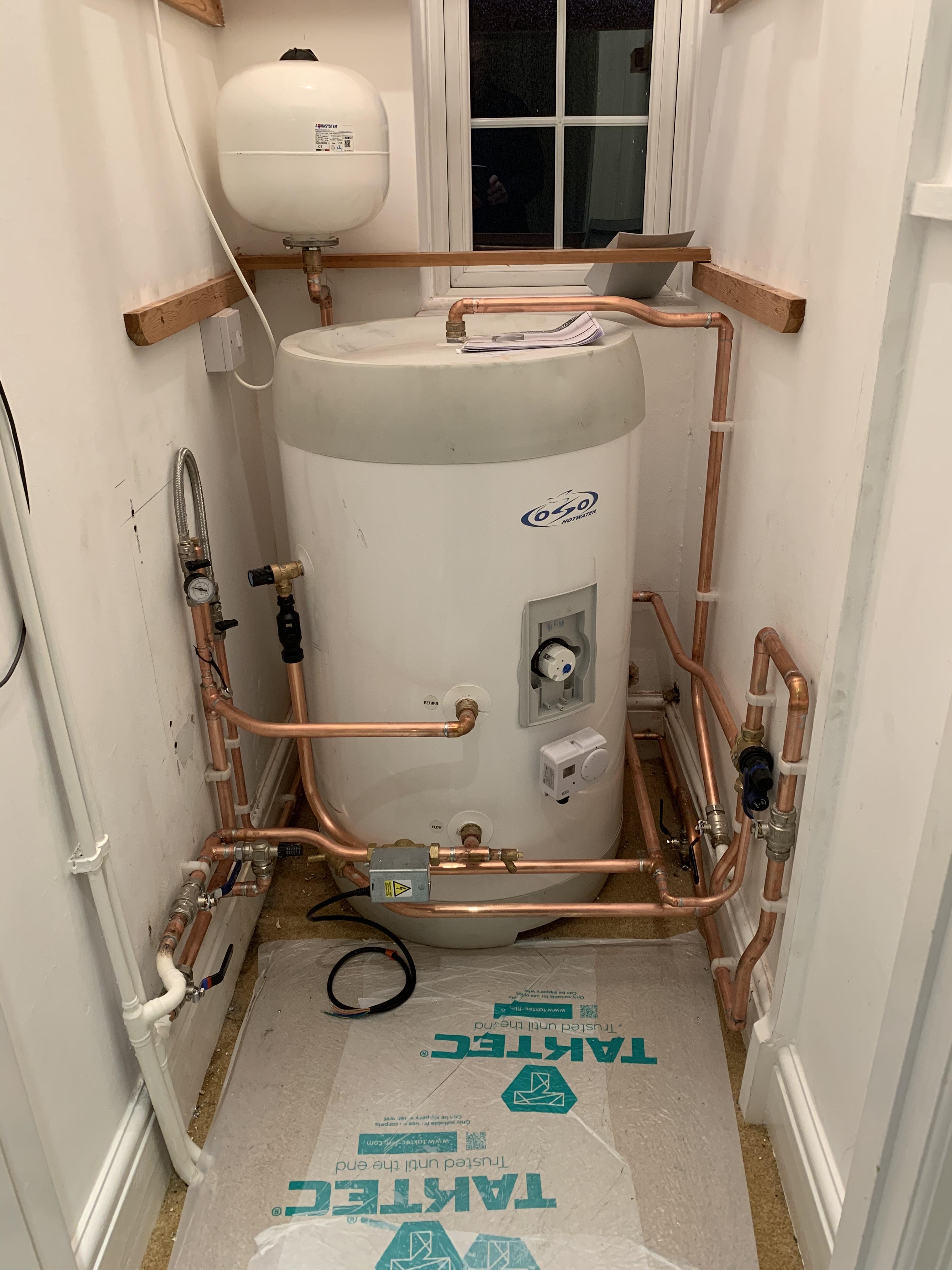

Robert Clark Posted May 8, 2020 Author Share Posted May 8, 2020 On 23/04/2020 at 19:08, Neil said: Have you looked at OSO Delta Coil. This claims to be the only A - rated HW cylinder available in the UK. I went for the 250 litre version. Although I have no detailed measurements, it appears to lose approx 1 degree overnight. https://osohotwater.co.uk/product/delta-coil/ Our new (imperfect) OSO cylinder bought on EBay (from OSO) saving over £500 was fitted yesterday. Heated up really fast well pleased ! 1 Link to comment Share on other sites More sharing options...

Robert Clark Posted May 8, 2020 Author Share Posted May 8, 2020 22 minutes ago, Russell griffiths said: What sort of money. £395 inc VAT and delivery Theyve only got 150 litre ones though which is fine for the two of us Link to comment Share on other sites More sharing options...
