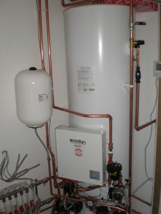

ProDave Posted November 29, 2016 Share Posted November 29, 2016 I was working today on a new build that was having the "professionally" designed and installed heating system commissioned,so I took some time to have a look and talk to the guys. It was a Mitsubishi ASHP coupled to a "pre plumbed" Mitsubishi cylinder and controls. The nuggets of information I gleaned, in no particular order were: The tank was an unvented cylinder for hot water only. Heated to 45 degrees by the heat pump. Once every 3 weeks, on a day of the week of your choosing, it automatically uses the immersion heater to raise the tank to 60 degrees for an hour as an anti legionella measure. Because of the low grade heat input, they said it would require too large a heat input coil, so it used a plate heat exchanger to heat the tank. The UFH runs directly from the heat pump. No buffer tank. It either runs DHW or heating, never both together. When in heating mode, the heat pump runs at a low temperature which you can set. They say this obviates the need for UFH mainifolds with temperature control, instead you can use a dumb manifold (cheaper) and just dial up the flow temperature you want for the UFH in the heat pump controller. The outside unit ran very quietly, and I didn't see it icing up or needing to defrost, it was about 3 degrees today. I was particularly interested in the no buffer tank, and direct operation of the UFH with a dumb manifold. Certainly something to think about. 2 Link to comment Share on other sites More sharing options...

ProDave Posted November 29, 2016 Author Share Posted November 29, 2016 Yes, but in a really well insulated house, you would not set the UFH temperature to 10 degrees above room temp, you would set it lower. I think the main point is no need to go via a buffer tank between the ASHP and UFH, and no need to heat the water any hotter than the target floor temperature (so the heat pump can run at a lower temoperature and hopefully better COP. One think I did notice, which I will probably be asked to correct later, is the installer did not use the "call for heat" from the UFH controller. So at the moment it looks like the ASHP would still be left idling heating just a short loop if the UFH was satisfied. So in any event the UFH controller with it's room stats would stop the house cooking. In case it's not clear, the system I am describing is not in my own house, but the new build I have just about finished wiring today. Link to comment Share on other sites More sharing options...
Barney12 Posted November 29, 2016 Share Posted November 29, 2016 (edited) Was it the packaged Ecodan product as described here: https://heating.mitsubishielectric.co.uk/Products/Pages/Monobloc_Packaged_Cylinder.aspx Of all the reading I've done it ticks the most boxes for me. Edited November 29, 2016 by Barney12 Link to comment Share on other sites More sharing options...
ProDave Posted November 29, 2016 Author Share Posted November 29, 2016 4 minutes ago, Barney12 said: Was it the packaged Ecodan product as described here: https://heating.mitsubishielectric.co.uk/Products/Pages/Monobloc_Packaged_Cylinder.aspx Of all the reading I've done it ticks the most boxes for me. Almost. It is actually this cylinder https://heating.mitsubishielectric.co.uk/Products/Pages/Monobloc_Pre-Plumbed_Slimline_Cylinders.aspx And I believe it's an 8KW monoblock heat pump/ Link to comment Share on other sites More sharing options...

SteamyTea Posted November 29, 2016 Share Posted November 29, 2016 1 hour ago, ProDave said: Because of the low grade heat input, they said it would require too large a heat input coil, so it used a plate heat exchanger to heat the tank. Not sure I understand what is happening here. As it is an unvented store, does the mains water just enter it cold, get heated, then comes out the top to the tap (I don't think this is what happens). Or does the water in the cylinder get pumped though the plate heat exchanger, heating the the cold supply that then goes off to the tap (I think this is what happens). So this system will always need a working pump and a power supply then. Link to comment Share on other sites More sharing options...
Stones Posted November 29, 2016 Share Posted November 29, 2016 32 minutes ago, ProDave said: Yes, but in a really well insulated house, you would not set the UFH temperature to 10 degrees above room temp, you would set it lower. I think the main point is no need to go via a buffer tank between the ASHP and UFH, and no need to heat the water any hotter than the target floor temperature (so the heat pump can run at a lower temoperature and hopefully better COP. One think I did notice, which I will probably be asked to correct later, is the installer did not use the "call for heat" from the UFH controller. So at the moment it looks like the ASHP would still be left idling heating just a short loop if the UFH was satisfied. So in any event the UFH controller with it's room stats would stop the house cooking. In case it's not clear, the system I am describing is not in my own house, but the new build I have just about finished wiring today. My plan is to use the call for heat function from the master controller / stat, but keep the heating pump circulating so that the slab temp is nice and even. As per your comments, I plan to run the slab as near as I can to room temperature. It will no doubt take a bit of trial and error to work out the optimum settings. 20 minutes ago, PeterW said: Which wholesaler did you go through as there seems to be some wild variation on price on those ... http://www.seconsolar.com/ekmps/shops/seconsolar/resources/Other/secon-heat-pumps-v8.4-a4x6pp-jan16.pdf 1 Link to comment Share on other sites More sharing options...
ProDave Posted November 29, 2016 Author Share Posted November 29, 2016 25 minutes ago, SteamyTea said: Not sure I understand what is happening here. As it is an unvented store, does the mains water just enter it cold, get heated, then comes out the top to the tap (I don't think this is what happens). Or does the water in the cylinder get pumped though the plate heat exchanger, heating the the cold supply that then goes off to the tap (I think this is what happens). So this system will always need a working pump and a power supply then. My understanding is this is an unvented water tank, so cold mains water (via PRV) goes in at the bottom and hot water to the hot taps comes out of the top. You would normally heat this type of tank with a heat exchange coil at the bottom. But because you are heating it with low temperature water from the HP, it would need a particularly large heat exchange coil. So instead it is heated by a plate heat exchanger. So the water / antifreeze / inhibitor mix of the closed circuit heating circuit passes through one side of the plate heat exchanger, and water from the tank is pumped through the other side via two tappings to the tank. So it only needs power and a pump running while the cylinder is being heated. Once hot, you can draw hot water from it in the same way as any other unvented cylinder without any power. There are 3 pumps on this tank. One is to circulate the hot water via the PHE. One is to circulate the heating circuit to the ASHP whenever that is running, and the third is to circulate heating water to the heating circuit, in this case UFH. I did like this system for what it does and how it does it. but my feeling is the "controls" side of it lack integration. There is a very complicated controller, which I strongly suspect is beyond the ability of most normal home owners to understand or adjust. Then in this case there is a completely separate under floor heating controller with it's own timer clock etc. There is almost no integration between the two. That is probably the fault of the home owner who in this case had originally planned to heat the house with an oil boiler, until he found that it was not possible to get a SAP "pass" with just an oil boiler so he rather reluctantly I think chose the ASHP system. I am still minded to put my own system together along these lines, but built from individual components with a simpler and perhaps better integrated control solution. Link to comment Share on other sites More sharing options...
