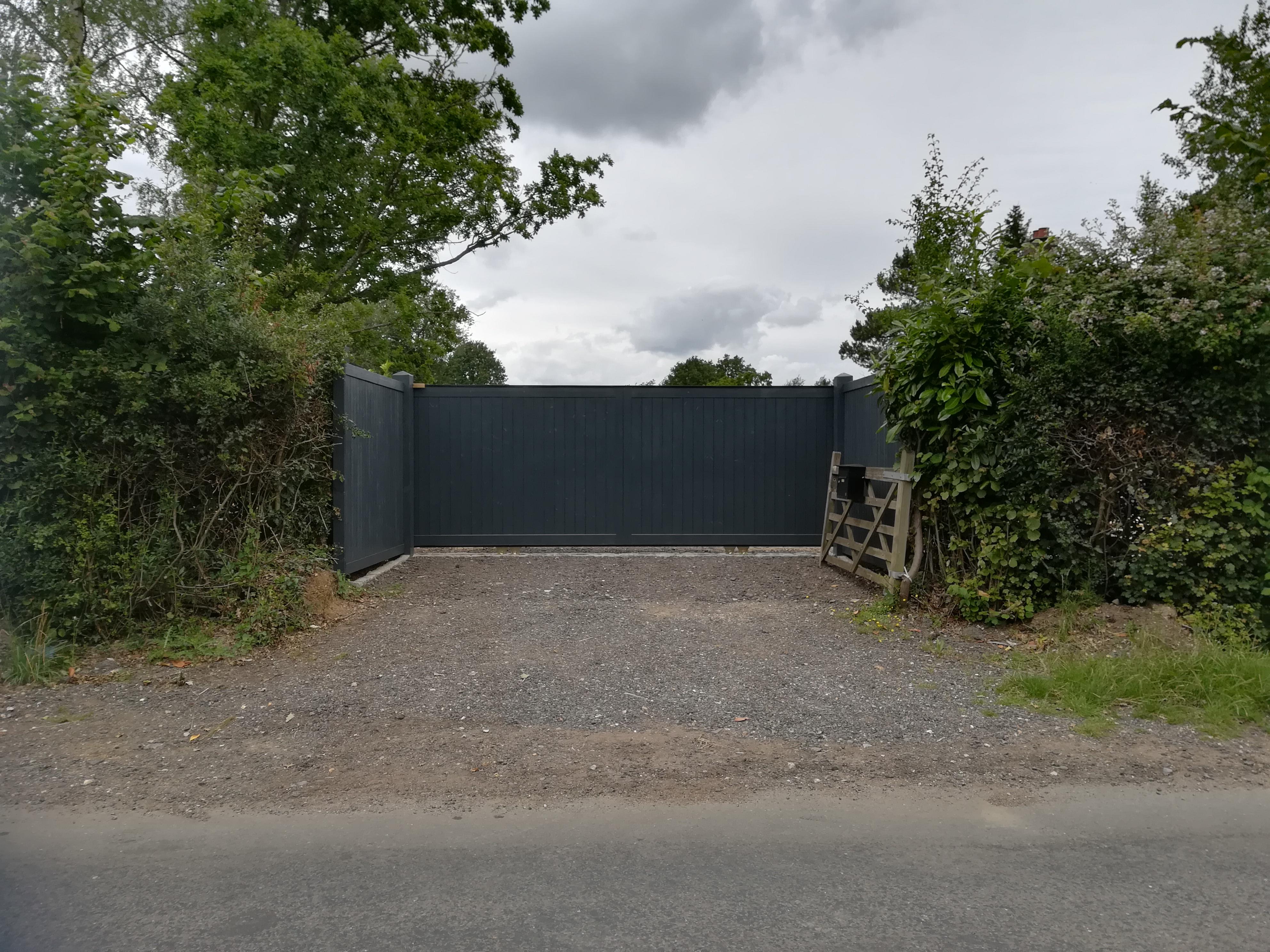

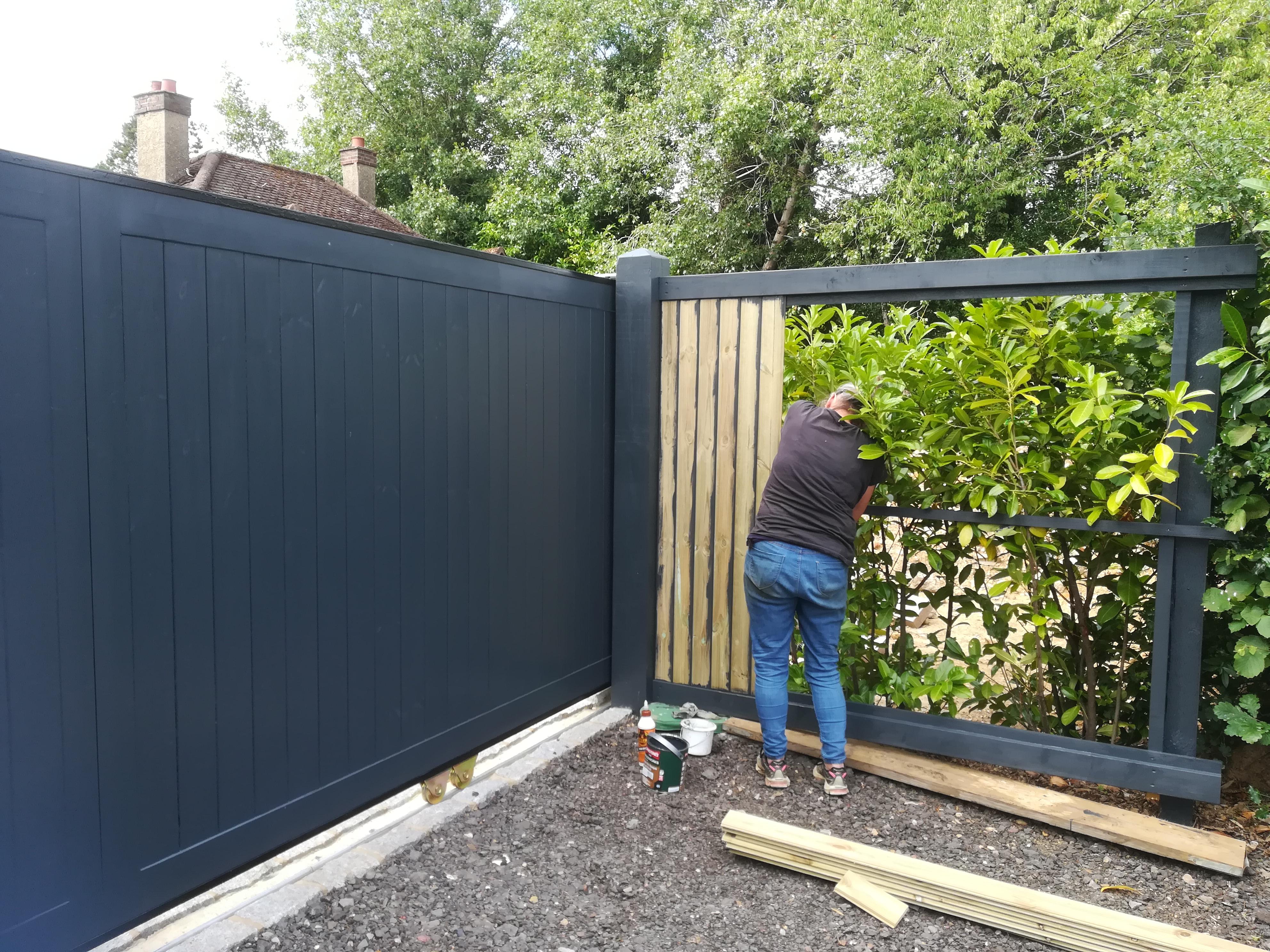

Big Jimbo Posted August 14, 2020 Author Share Posted August 14, 2020 So I made some gates. That should stop all the people walking passed having to watch me in my pants, scratching my bits, having a fag outdoors. I'm pleased with them 16ft wide. 1 Link to comment Share on other sites More sharing options...
Mr Punter Posted August 14, 2020 Share Posted August 14, 2020 Nice. Tell more. Did you make them? Are they automated? They look like sliding but I can't work out which way. Pics during construction may be good. Link to comment Share on other sites More sharing options...

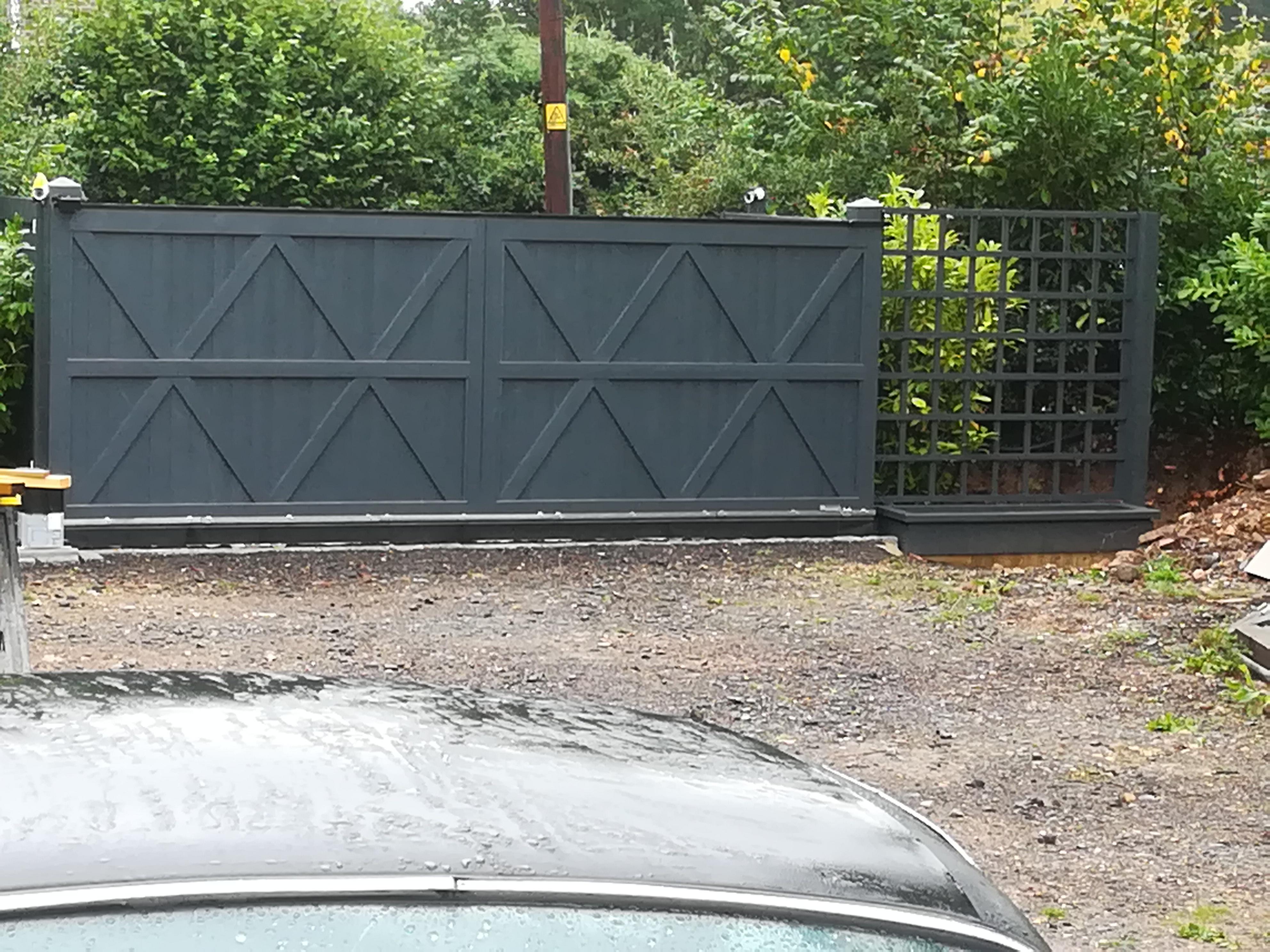

Big Jimbo Posted August 14, 2020 Author Share Posted August 14, 2020 14 minutes ago, Mr Punter said: Nice. Tell more. Did you make them? Are they automated? They look like sliding but I can't work out which way. Pics during construction may be good. Yeah, I made them. 8 ft wide each, then joined them with metalwork at the top and bottom. Too heavy to lift as 1 gate. So it is now 1gate 16ft wide. Made it sliding, and stuck a grands worth of c20 concrete in the ground to take the sliding track, and to act as a super strong crossover for big lorries etc. Bought the motor from Italy, and welded up the stop catches etc from scrap. 1 Link to comment Share on other sites More sharing options...
Onoff Posted August 14, 2020 Share Posted August 14, 2020 Looks terrific. Have you got contact strips on the gate or just photo cells? I'll have at least 3 pairs of photo cells (3 beams) and will add contact strips. Did you buy a sliding gate kit & what make? 1000kg one is it as that gate looks huge and heavy? (I like gate details). Also looking to make a simple loop detector circuit. Link to comment Share on other sites More sharing options...
Big Jimbo Posted August 14, 2020 Author Share Posted August 14, 2020 12 minutes ago, Onoff said: Looks terrific. Have you got contact strips on the gate or just photo cells? I'll have at least 3 pairs of photo cells (3 beams) and will add contact strips. Did you buy a sliding gate kit & what make? 1000kg one is it as that gate looks huge and heavy? (I like gate details). Also looking to make a simple loop detector circuit. At the moment i just have photo cells, and a flashing light. The motor is from Italy. (Actually made in italy) The company is called Oxygen. Its a 2000kg motor. The gate is bloody huge and heavy. I bought four wheels, and a track from Rolling centre, I am going to make a loop detector, and i plan on adding an edge contact strip. (Better not kill anybody) I'm a right tight sod, and my only mistake was getting a video door entry, with keypad, and rfids from China. £69...I got the Key unlock from inside to work, but can't get the rfids to work or the number pad. The video works great. Im rubbish with tecno, but the entry systems from brit companies were about a grand, so i though for £69 squid i'd give it a go. Link to comment Share on other sites More sharing options...
Taff Posted August 14, 2020 Share Posted August 14, 2020 On 29/04/2020 at 14:22, joe90 said: This was part of my planning fiasco with the planners, upshot is the verge is classed as “pedestrian” and historically was used fir horses. Your boundary will be the fence, ditch or hedge. There is a min distance from gate to roadside to enable you to stop your car off the road to open your gate, if your gates are that far back then visibility will not be an issue. Personally I would “crack on” as no one seems to notice (unless you have a stroppy neighbour like I had) but I still won my case at appeal and the planners and neighbour were told I was within my rights ? Totally agree Link to comment Share on other sites More sharing options...

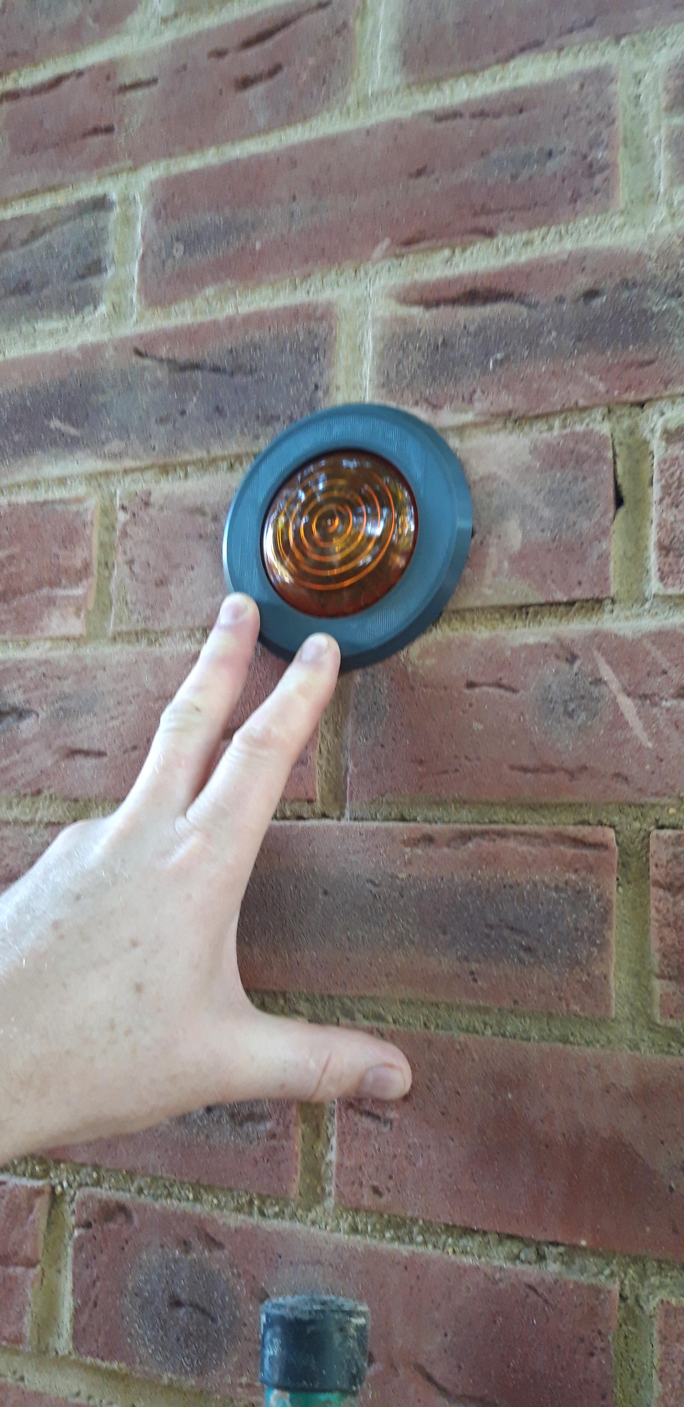

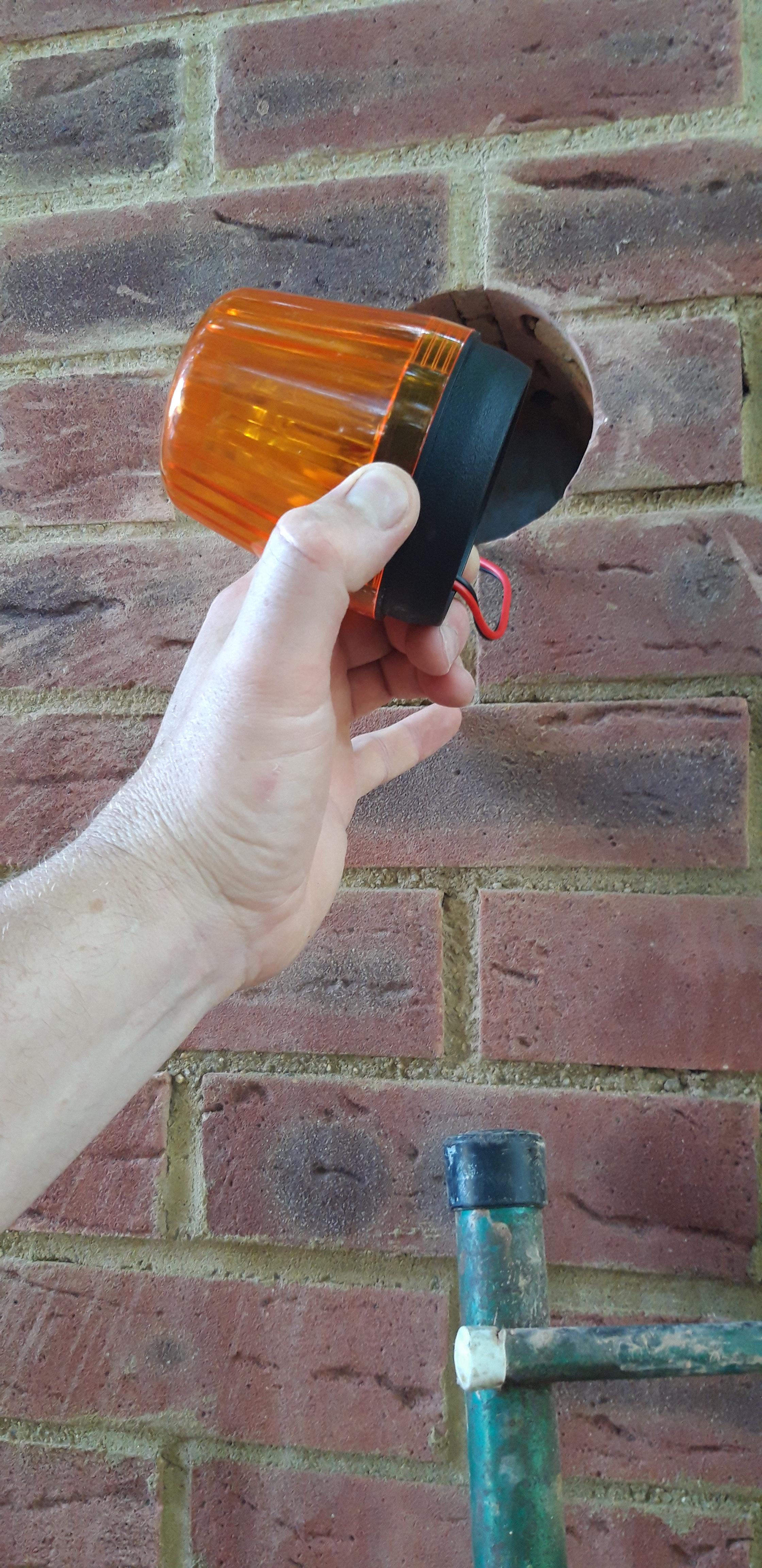

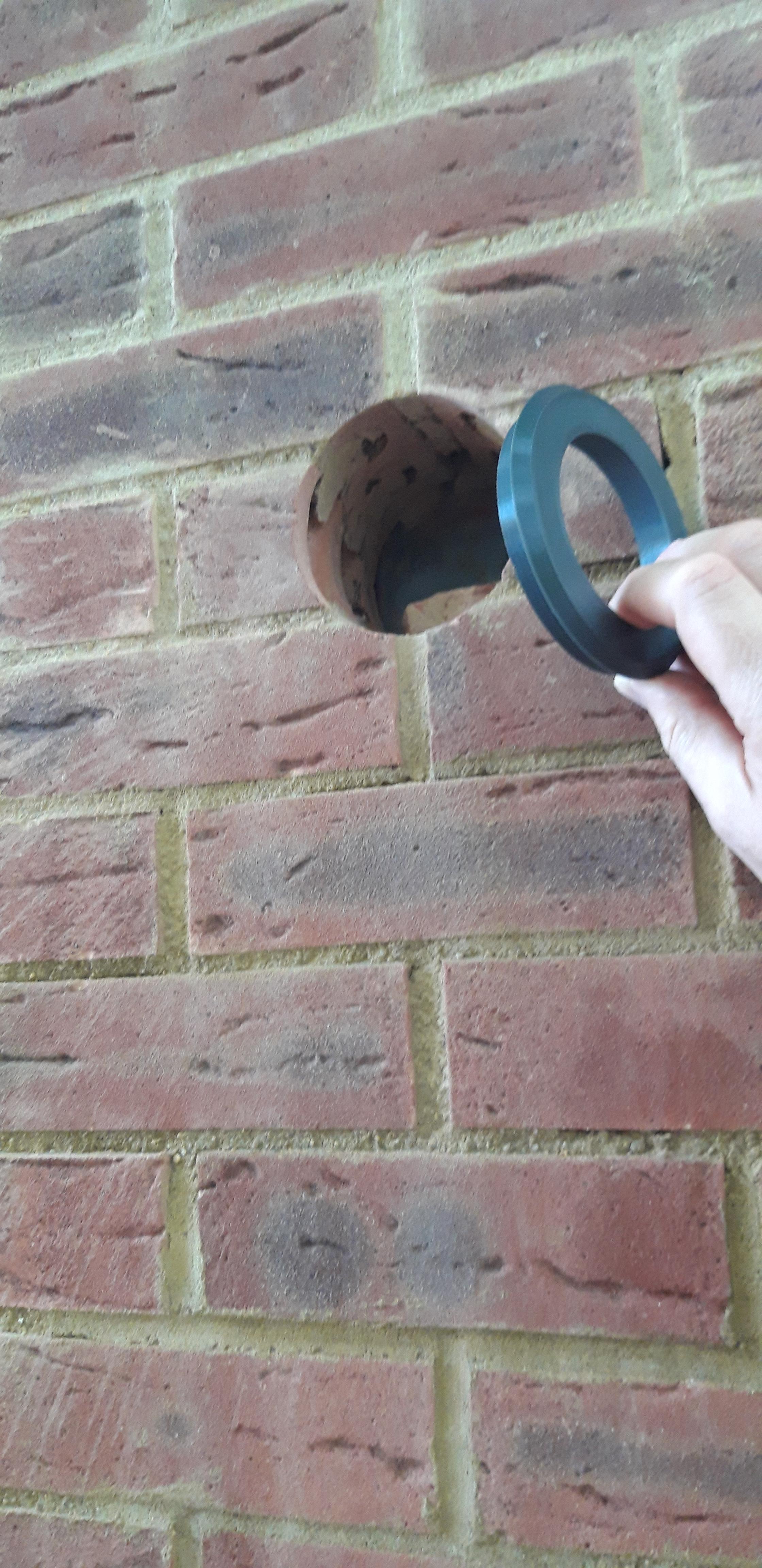

Onoff Posted August 14, 2020 Share Posted August 14, 2020 @Big Jimbo, got my kit from EasyGates, 500KG motor is by Chamberlain LiftMaster. Track from Barrier Components in Purfleet. Tbh I think all my gear is in fact Italian. Made the gate & frame and built the brick pillars. I really didn't like the idea of looking at the big flashing orange strobe, like a council gritter! My lad's just 3D printed an insert so I can mount it near flush. It'll get sprayed black to match the trim of the brick lights below. My video doorbell is something equally obscure as yours sounds! Made by the Kyoto Dangerous Toy & Lawnmower Company I think. Trialled it the other day with 45m of Cat-6 and it worked fine tbh. Comes with a 7" indoor touchscreen. Link to comment Share on other sites More sharing options...
Big Jimbo Posted August 14, 2020 Author Share Posted August 14, 2020 4 minutes ago, Onoff said: @Big Jimbo, got my kit from EasyGates, 500KG motor is by Chamberlain LiftMaster. Track from Barrier Components in Purfleet. Tbh I think all my gear is in fact Italian. Made the gate & frame and built the brick pillars. I really didn't like the idea of looking at the big flashing orange strobe, like a council gritter! My lad's just 3D printed an insert so I can mount it near flush. It'll get sprayed black to match the trim of the brick lights below. My video doorbell is something equally obscure as yours sounds! Made by the Kyoto Dangerous Toy & Lawnmower Company I think. Trialled it the other day with 45m of Cat-6 and it worked fine tbh. Comes with a 7" indoor touchscreen. Love your recessed light. That looks fab. I hate mine. I'll have to bite the bullit and get a decent door entry video thingy. They just seem to cost so much from Brit suppliers, and they are all prob made in China. Link to comment Share on other sites More sharing options...
Onoff Posted August 14, 2020 Share Posted August 14, 2020 6 minutes ago, Big Jimbo said: Love your recessed light. That looks fab. I hate mine. I'll have to bite the bullit and get a decent door entry video thingy. They just seem to cost so much from Brit suppliers, and they are all prob made in China. 1080P apparently is my one. Must mean something different in China! ? 1 Link to comment Share on other sites More sharing options...
