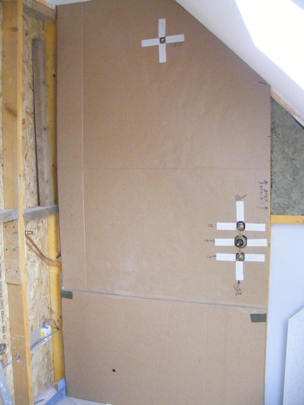

ProDave Posted April 6, 2020 Posted April 6, 2020 If I have an awkward bit to cut and only 1 bit of material (or expensive material) I make a cardboard template and get that right before cutting the real stuff.
