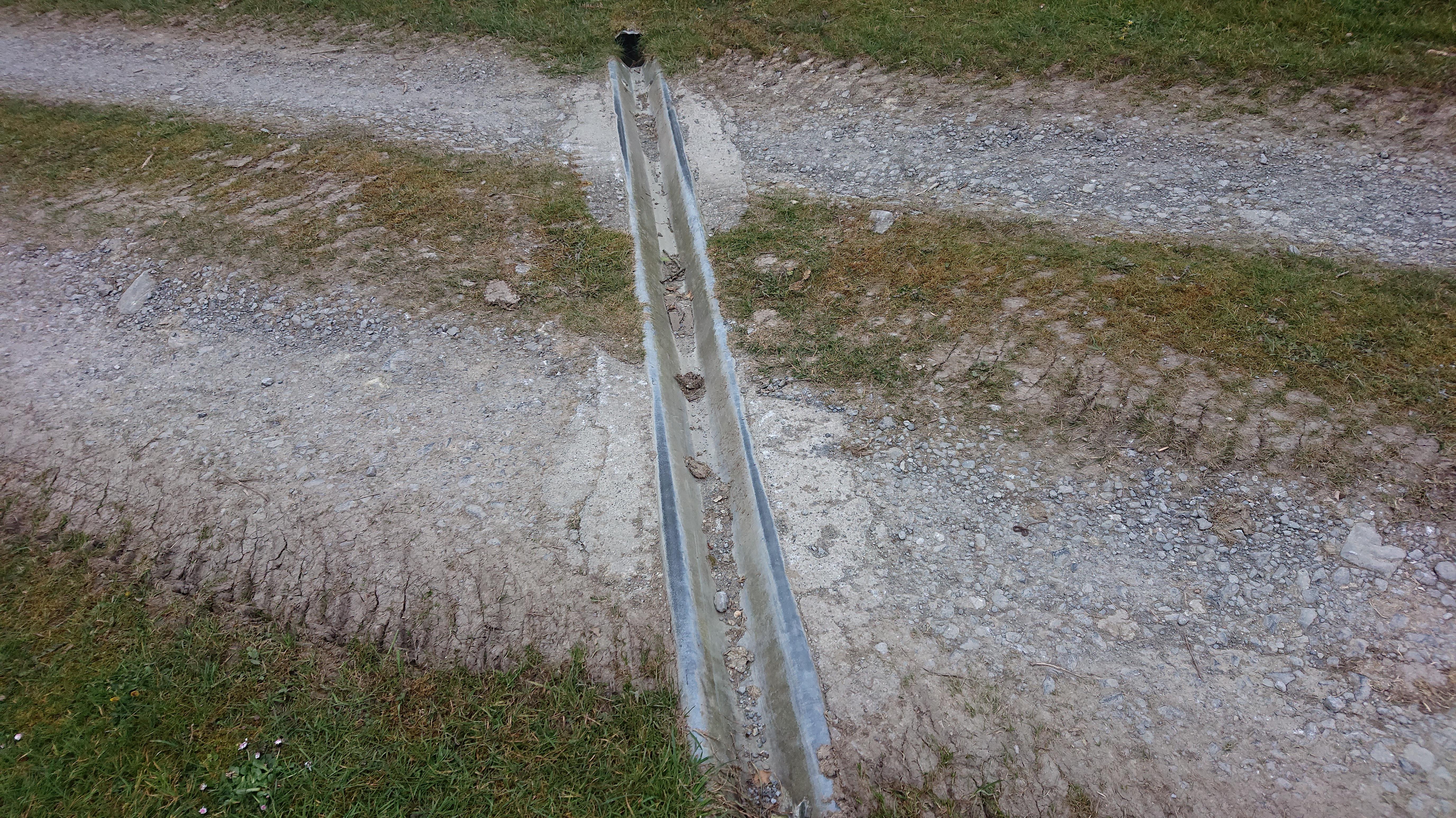

Miek Posted April 1, 2020 Share Posted April 1, 2020 Also important to consider why/how potholes form in the first place. Drainage is key to a stone track as running or pooling water soon errodes the surface and leaves a small pothole which can the grow when a tyre passes through it and throws out the water and some of the stone. If you observe how forestry roads are built they have considerable camber to shed water off the track and a ditch to carry this water away. Road crash barrier makes a cheap gully to shed water off the track and will take a lorry if concreted in no problem. I have a potholed stone track too Link to comment Share on other sites More sharing options...
