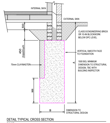

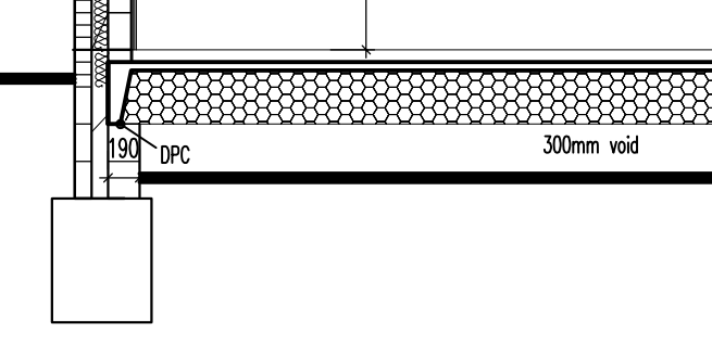

MortarThePoint Posted March 19, 2020 Author Posted March 19, 2020 The Structural Engineer has specified a maximum of 750mm of blockwork below external ground level and maximum 450mm below internal ground level (i.e. under void). Looking at these two pictures highlights that I should make sure it all works as the Structural Engineer has finished floor level way above external ground level whereas it will be 150mm above external ground level. The floor beams and screed are 375+75=450mm thick and the void 300mm so that makes internal ground level 450+300-150=600mm below external finished ground level. Based on this I'd expect the pour would come up to level with the ground under the void. Ground level outside has been reduced during demolition and needs to be built back up by 600mm.

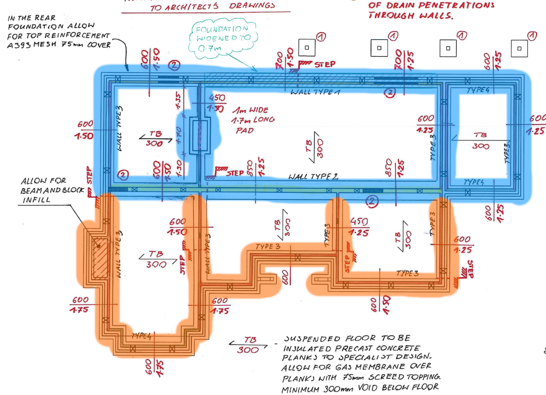

MortarThePoint Posted March 19, 2020 Author Posted March 19, 2020 Due to the nature of the soil the ground work team don't think they can dig the whole foundation and pour in a day so they are proposing to pour in stages anyway. They should be able to confirm that cement is deliverable first thing and then dig and pour same day. Any shutdown that might be announced is unlikely affect the day of announcement so at least that day's work can be concluded. There is the risk that the second day gets called off which wouldn't be good as the concrete is more likely to 'bond' the two halves together if it is fresher I imagine. Does anyone know about any downsides of having the foundations done in two pours like this? The Structural Engineer has recommended "to dowel foundations at the construction joints, use 6no. H16 dowels, 600mm long encased 300mm deep in concrete on each side of joint; install dowels in three rows evenly spaced and providing minimum 150mm edge distance." I don't know how many would be on each row and will ask. The ground works team were talking about starter bars. What do people think?
Mr Punter Posted March 19, 2020 Posted March 19, 2020 The rebar dowels are fairly straightforward. I think you can use a bit of ply with holes drilled and locate it where the joint is. Push the rebar halfway so it is part in the excavation and part in the unexcavated soil. Concrete one bit, dig the rest of the trench and bingo. Never done it or googled it but I think that is the basic plan. Unless the plot is huge, you should be able to get all the concrete in in a day.
MortarThePoint Posted March 19, 2020 Author Posted March 19, 2020 The subsoil is very sloppy and he foundation quite long with a number of corners. They are suggesting doing the blue shaded bit on the first day and the orange shade bit on the second day:
Oz07 Posted March 20, 2020 Posted March 20, 2020 I think your supposed to step it so it keys but perhaps the rebar negates this. Just go with what SE says. It won't be the first time it's been done in stages will be fine.

Declan52 Posted March 20, 2020 Posted March 20, 2020 If your soil has a concentration on sand and gravel then the water will eventually wash this out which will make the banks unstable. That's the biggest risk in to leaving them open for to long. Do it in two halfs as you have proposed and you should be fine.
