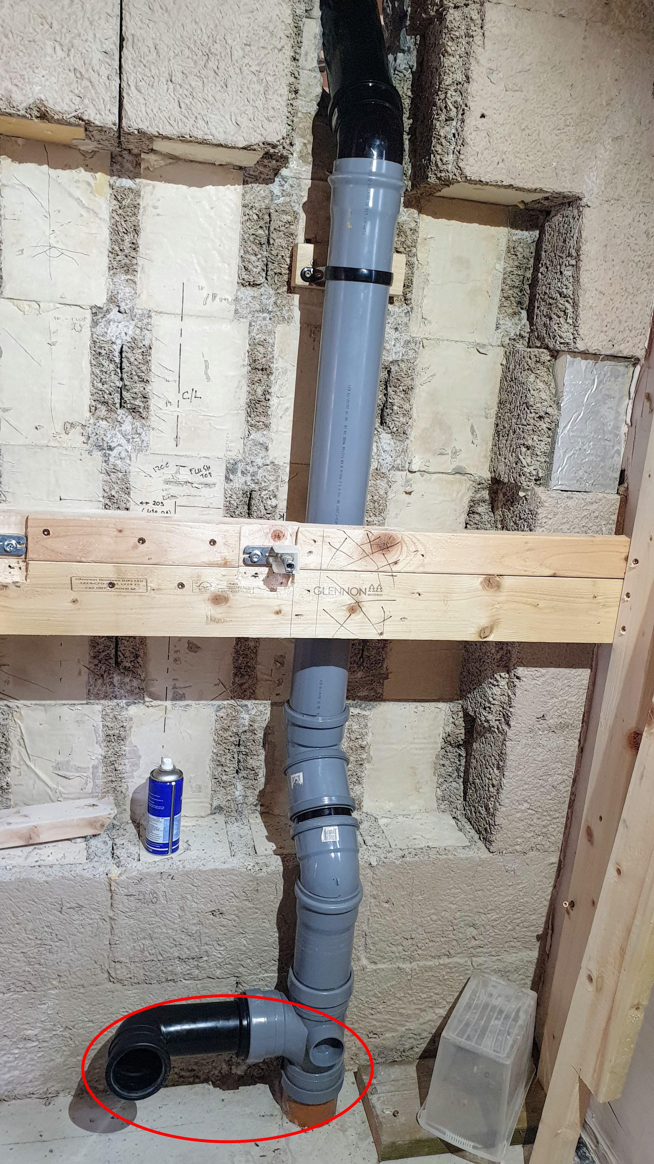

March 17, 20206 yr This image, for me represented success - never done it before. Putting in a Geberit DuoFix. Took ages to plan, longer to do, pipes slipping all over the shop doing a fair imitation of a slippery pig competition - that silcone gets everywhere dunnit? Deliberately sprayed some silicone where the cat jumps up - jumps, slides right off the work surface. Got the shock of his charmed, fat cat life. Should have seen his face as he fell off the edge of the workbench ? But he was laughing loud and long when ...... ... I realised that I put the socket connection joint in about 45mm too low..... Cue rictus grin, smart exit of the cat stage left when he hears me cursing. Is it possible to lift the grey Triple Socket Branch by just 45mm or so? Or should I try and get a flexible connection? I'm so nearly there....
March 17, 20206 yr You can get a version of that grey tripple socket that has TWO boss connections side by side and hence is a little longer. Might that do it?
March 17, 20206 yr I would drop the T down to floor level and replace with a Y fitting and a 45 degree elbow to bring you level.

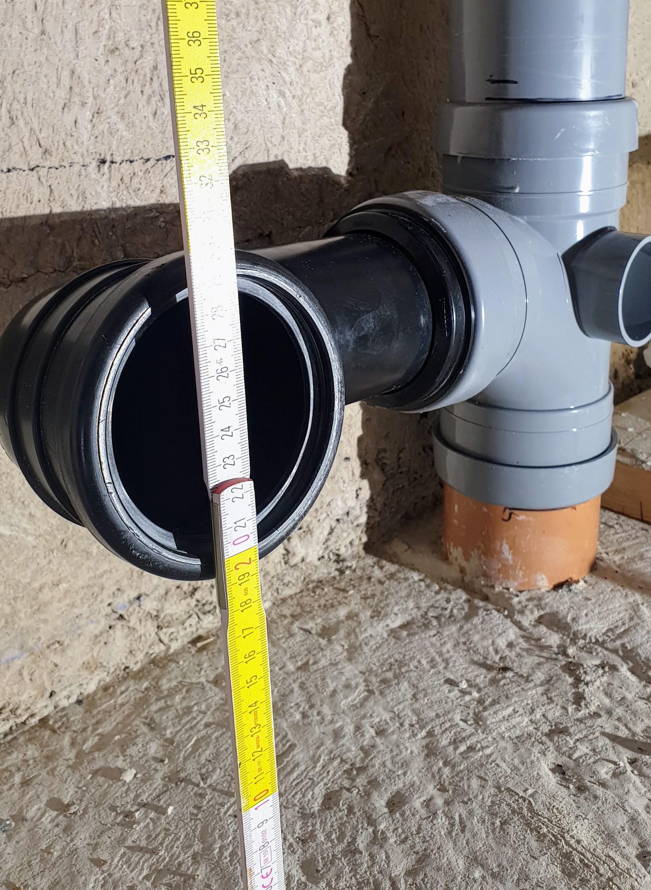

March 17, 20206 yr How far from bottom of grey to the concrete floor? That is how much brown is showing?
March 17, 20206 yr Author OK, just been on to Geberit Tech line; very helpful They propose Solvent Y piece instead of the current push fit branch Fit a short length of pipe to the (as it were) left hand branch of the Y (solvent weld it) Fit a ring seal coupler to the end nearest the loo that should give enough wriggle room ( 10mm or so) Phhhhh, wadja fink?
March 17, 20206 yr Fit a 102mm long UE407 brown coupler and a short bit of grey pipe solvent welded into the bottom of the existing branch: https://www.marleyplumbinganddrainage.com/products/underground-systems/solid-wall-drainage/ That raises you 51mm. Trim a 1/4" of the existing brown stub if needs be but I reckon it'll move and settle.

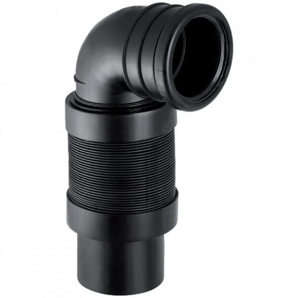

March 17, 20206 yr Author Boys! Geberit do a flexible bend. Bought one. Problem solved. Manufacturer's number 241521001 Yeah, I know, I know. I just haven't got the confidence to take that slippery pig apart again and put something together entirely on my own. Have broom, have bum, stick one in the other and keep going.
March 17, 20206 yr 11 minutes ago, AnonymousBosch said: Boys! Geberit do a flexible bend. Bought one. Problem solved. Manufacturer's number 241521001 Yeah, I know, I know. I just haven't got the confidence to take that slippery pig apart again and put something together entirely on my own. Have broom, have bum, stick one in the other and keep going. I think I'd have done that too - as I said above, your work is already done there and looks good - pig to strip it, you then run the risk of damaging seals etc. when you disturb them. Problem solved.

March 17, 20206 yr Obviously you couldn't just bend the black bit upwards to raise it 45mm but would a 15 degree bend get nearer or is it too much? https://www.screwfix.com/p/floplast-single-socket-bend-15-110mm/69177?tc=IB6&ds_kid=92700020972856688&gclsrc=aw.ds&ds_rl=1241687&ds_rl=1245250&ds_rl=1249404&gclid=Cj0KCQjw6sHzBRCbARIsAF8FMpWokdAwAdUbePMS7aWxbcygv6Ii3EhMTpDNsX8-T5Mz9CcMwqs7G5IaAu1lEALw_wcB
