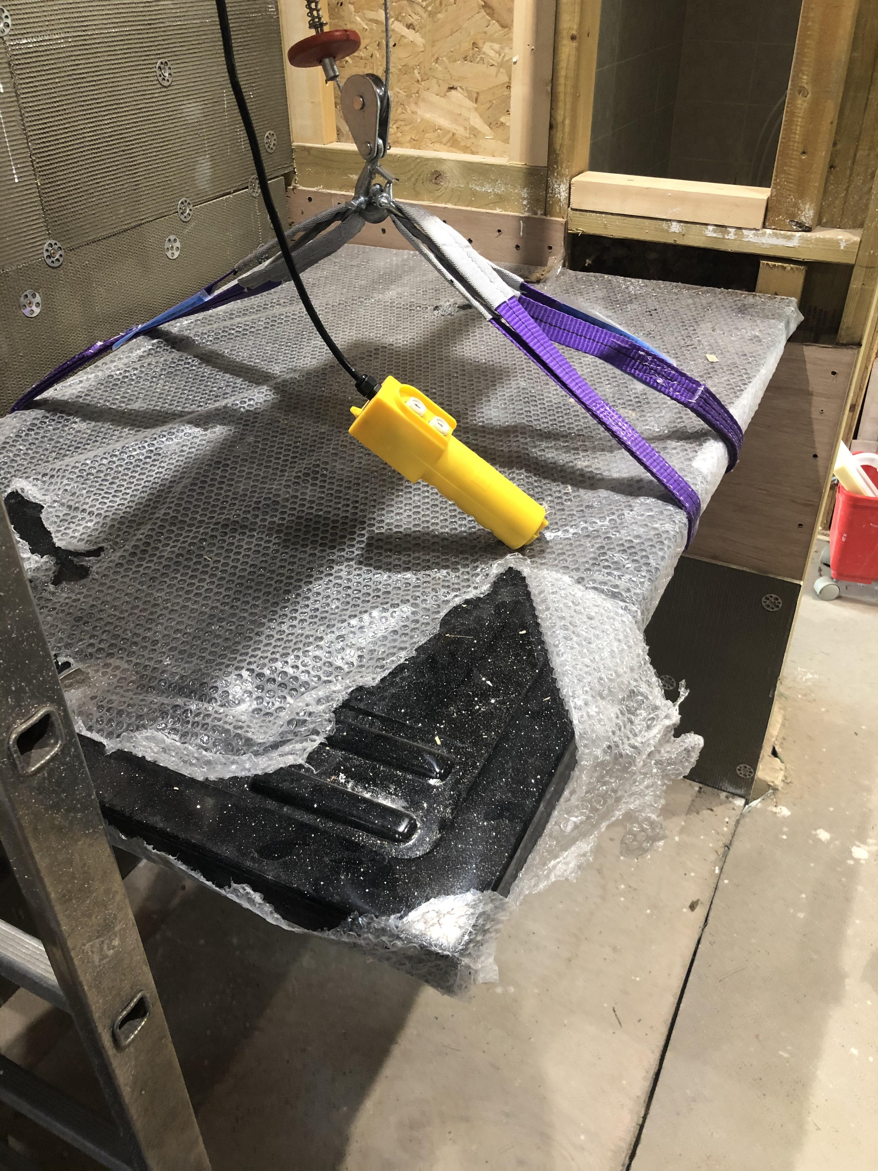

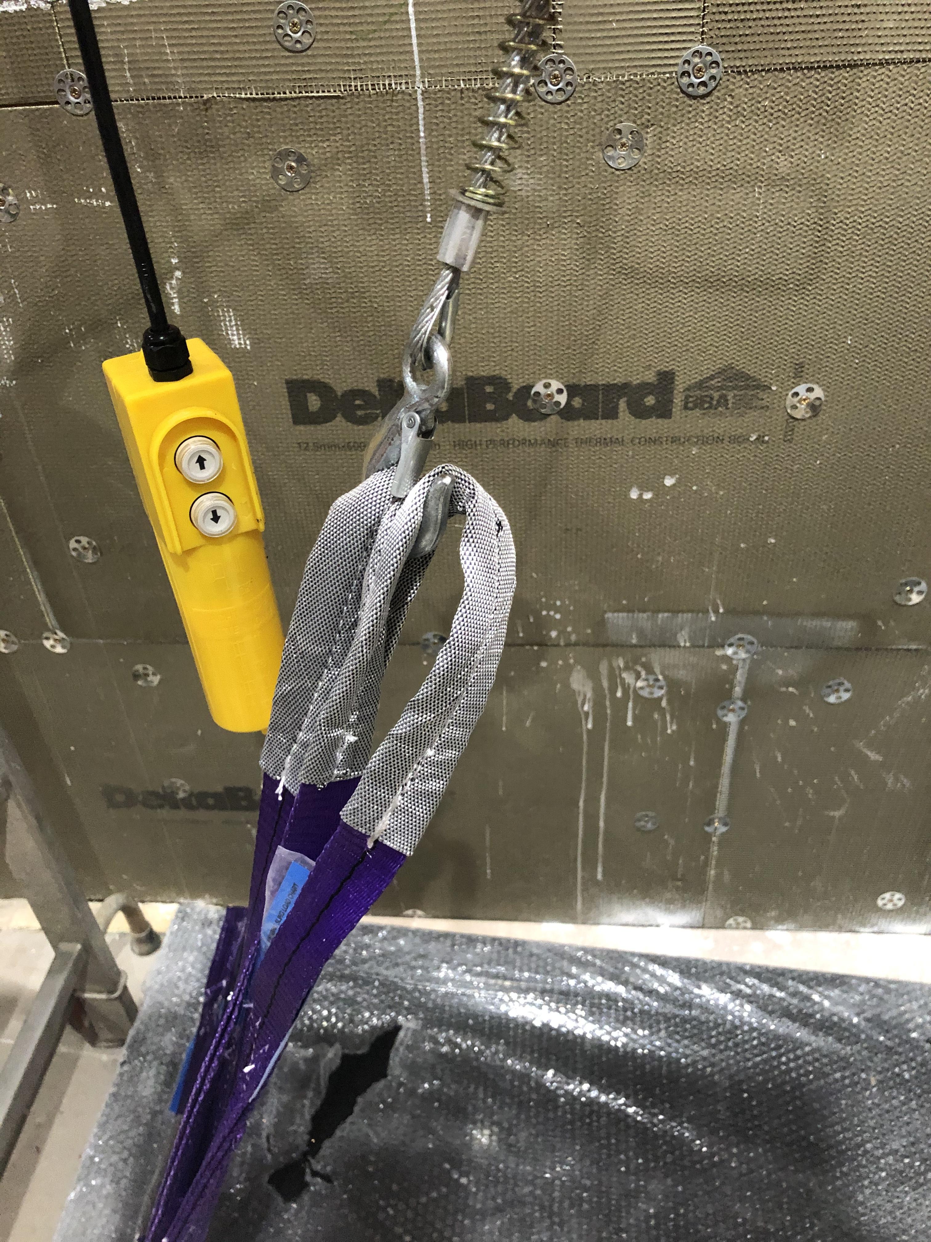

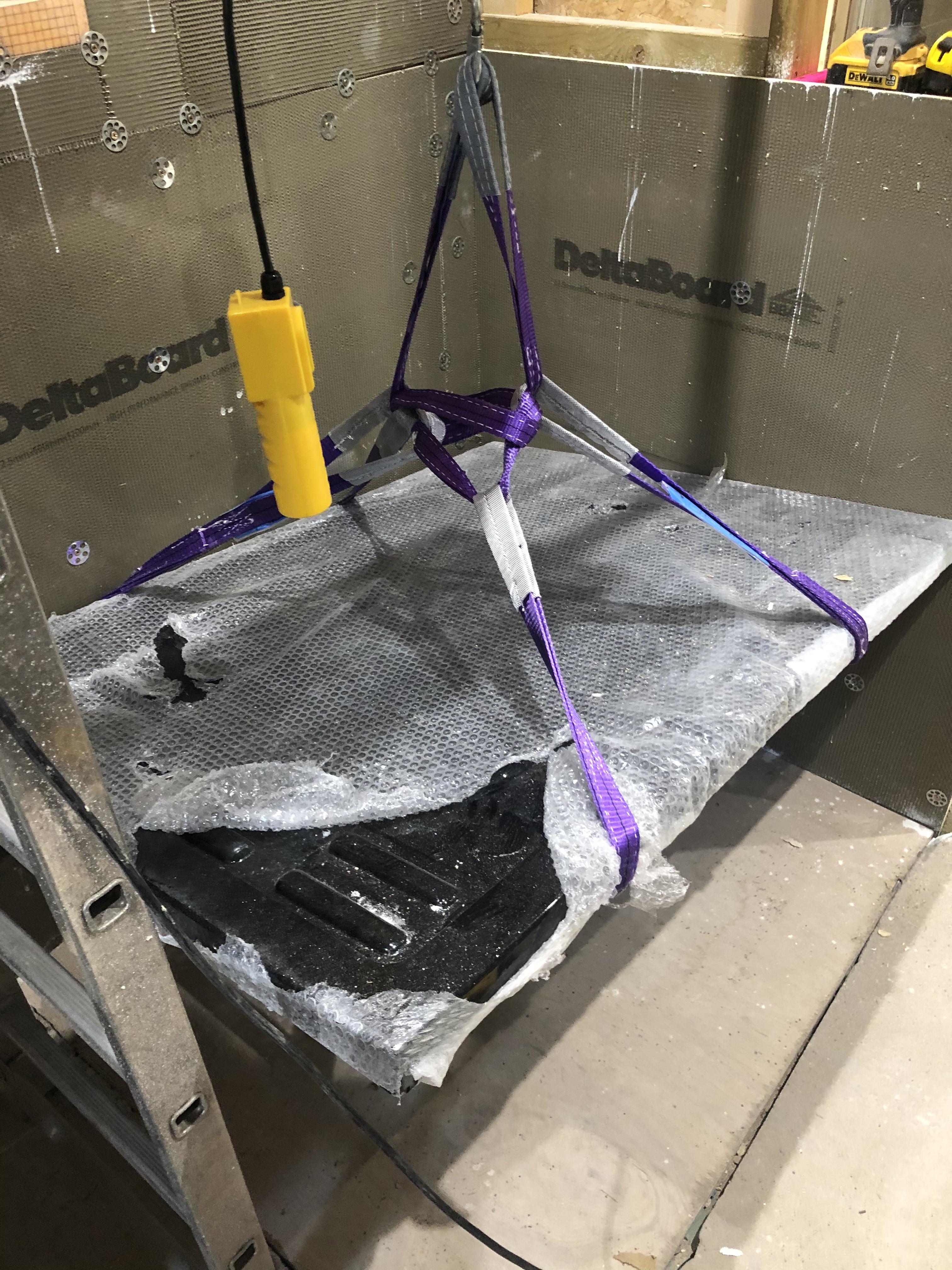

Pocster Posted September 30, 2020 Author Posted September 30, 2020 Preliminary test ! Need more straps ! Also - problem how to hook potentially 4 strap ends around the hook . Suggestions welcome !
Onoff Posted September 30, 2020 Posted September 30, 2020 D shackles or karibiners onto the single hook. 1
Pocster Posted September 30, 2020 Author Posted September 30, 2020 (edited) On 30/09/2020 at 11:35, Onoff said: D shackles or karibiners onto the single hook. Expand Ordered Also I ordered a 1 metre strap . Plan being I can then thread the other 2 straps ( 4 ends ) all onto the 1 metre one - then that to the hook Edited September 30, 2020 by pocster

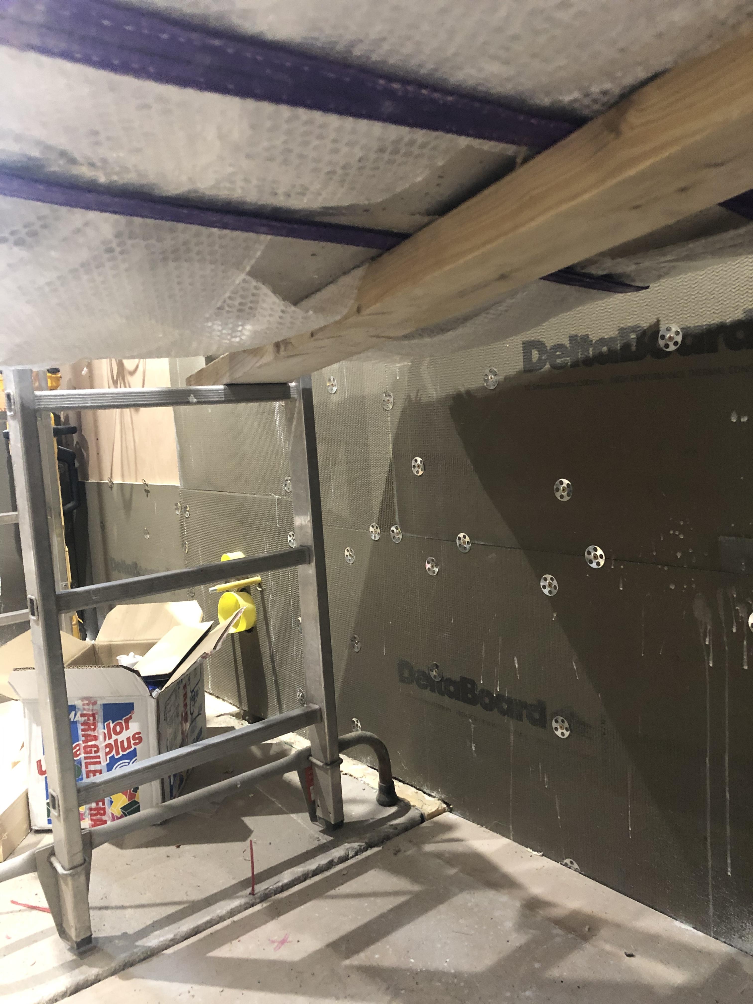

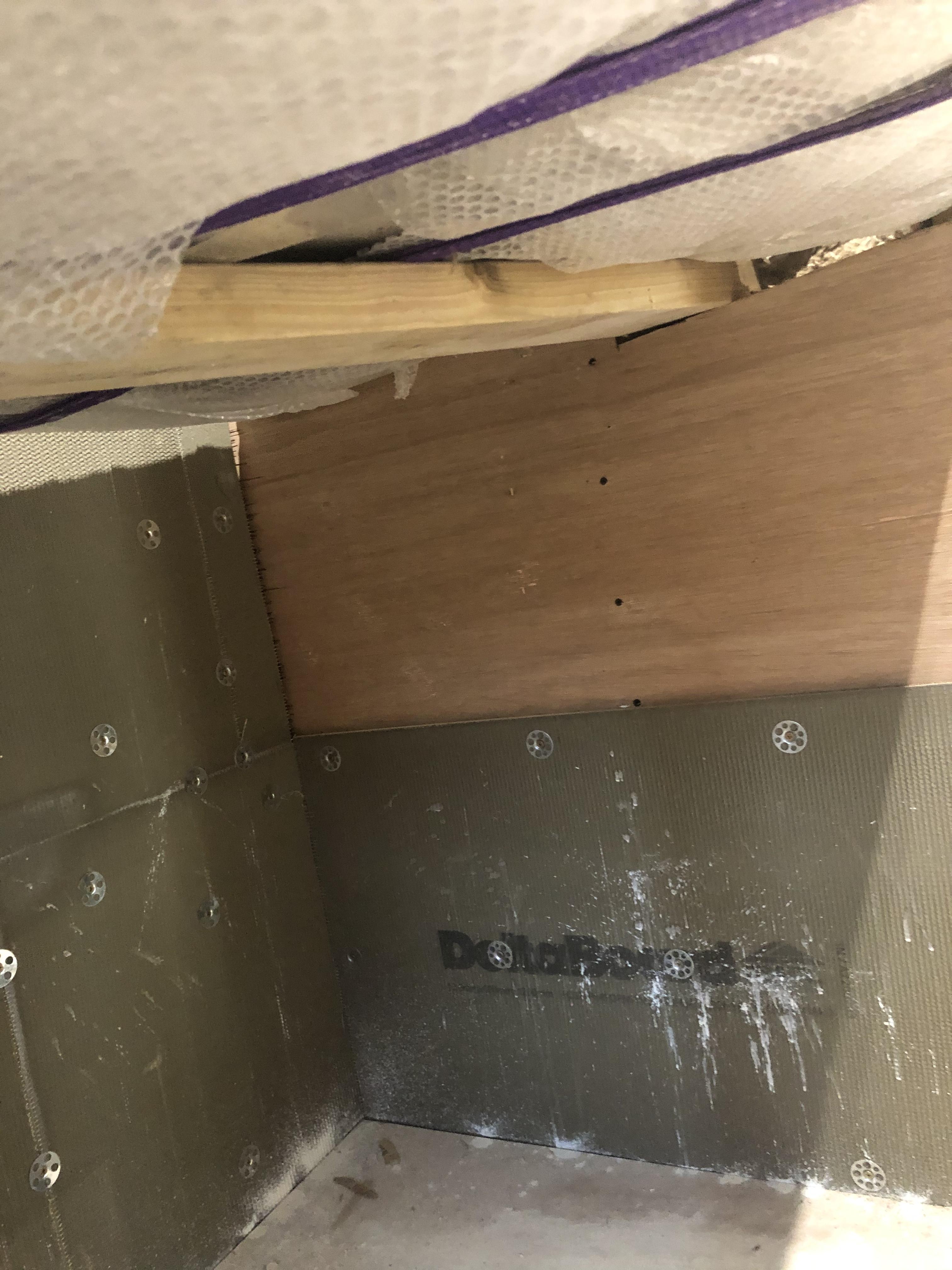

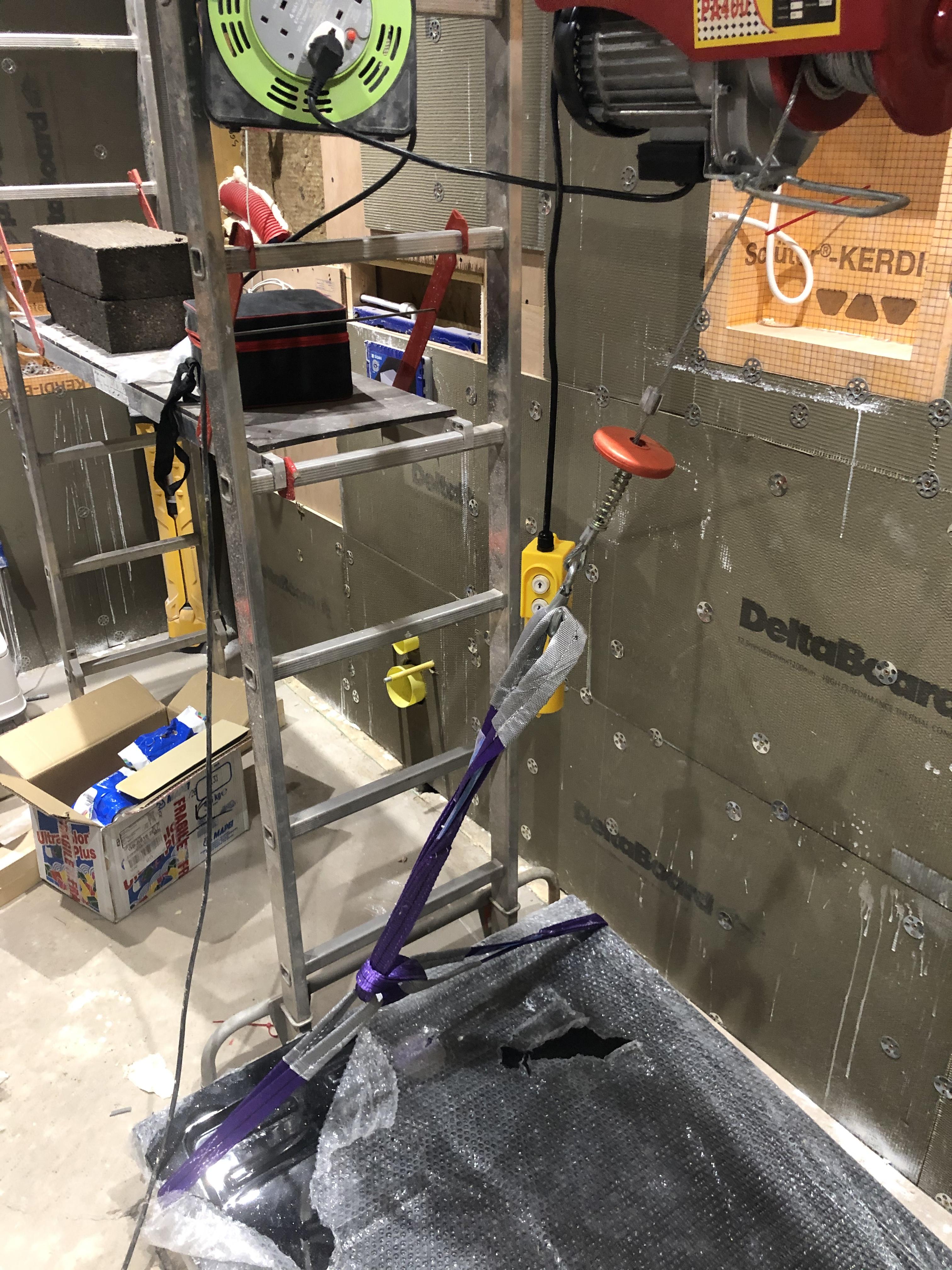

Pocster Posted October 7, 2020 Author Posted October 7, 2020 Well ! Thanks to @Onoff ‘s suggestion of those clamps . Got the tray up . Don’t trust the winch 1 inch as it grinds , spurts , stalls like it’s dying - a quality eBay purchase . Cut a hole in the opposite wall so I could get a length of timber under . Winch now taking zero of the strain . Bit low - but I couldn’t easily go higher . At least I can get under it now ?
