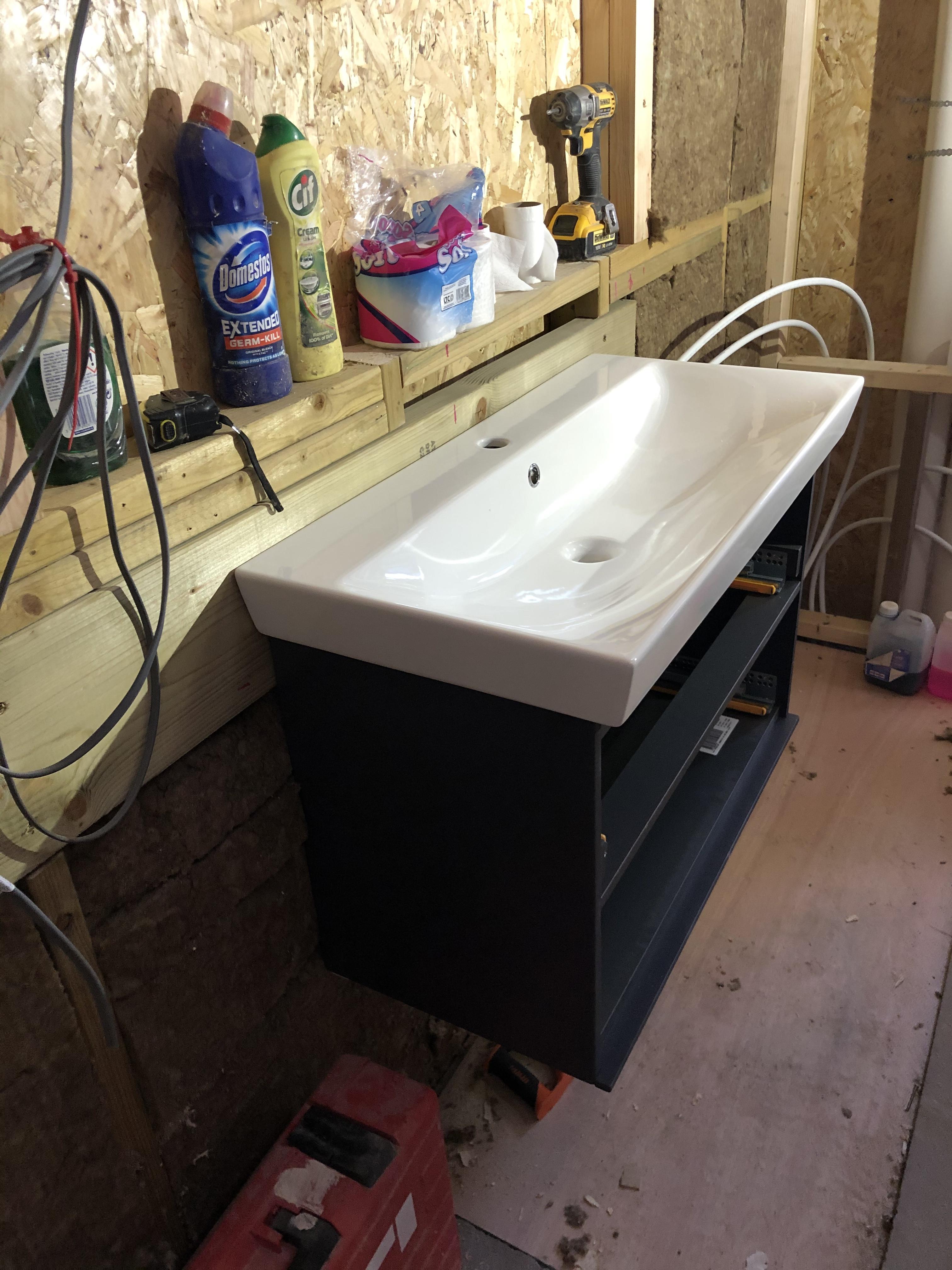

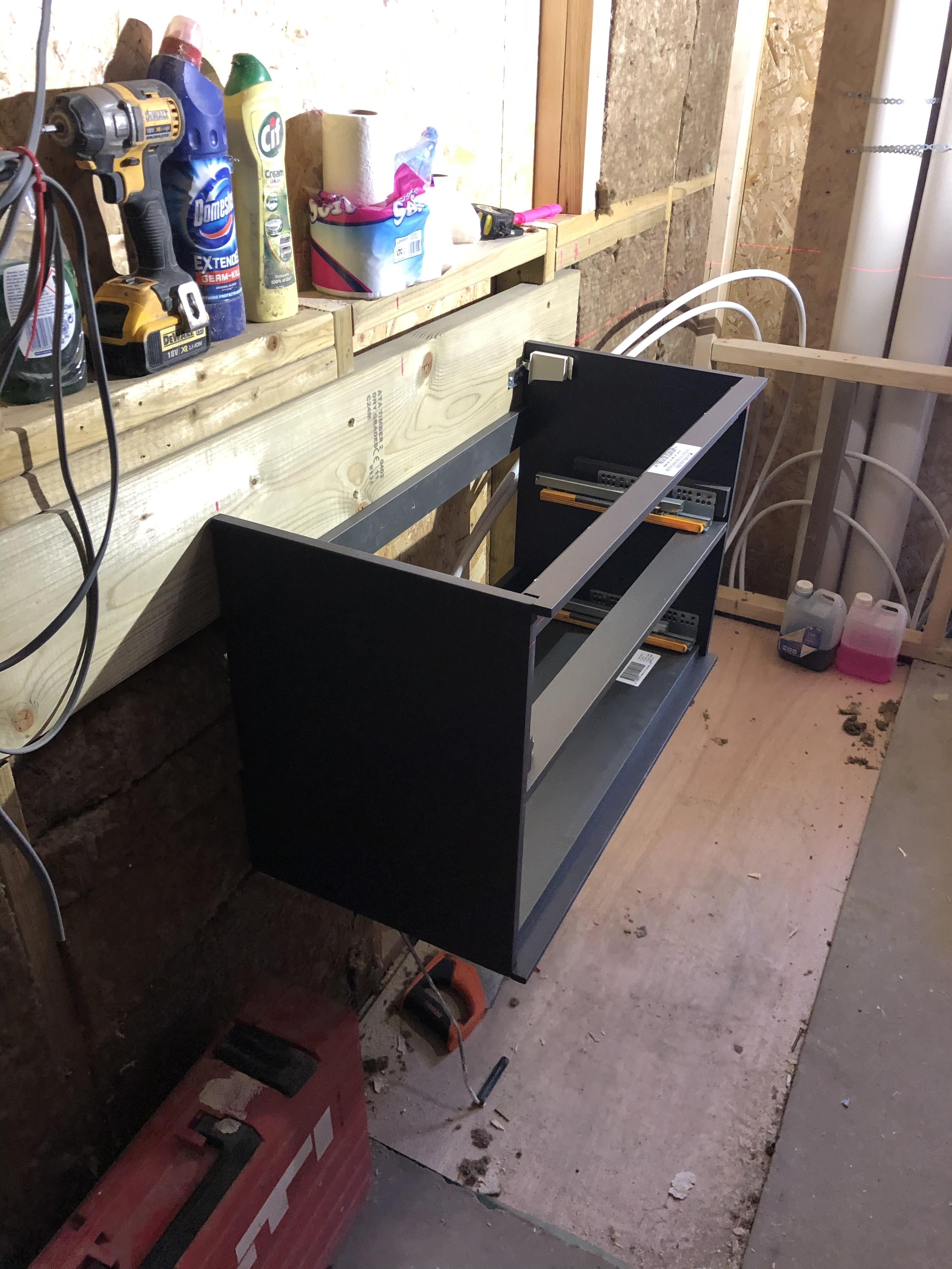

Pocster Posted March 11, 2020 Author Posted March 11, 2020 Hmmmm Floor to top of unit 87cm - sink is about another 10cm That seem too high ??
Pocster Posted March 11, 2020 Author Posted March 11, 2020 Floor to top of sink is 41” not allowing for 20mm of finished floor Too high . I think maybe 36” will be better . Anyway must go and panic buy wine and steak now
Ferdinand Posted March 11, 2020 Posted March 11, 2020 (edited) 57 minutes ago, pocster said: Floor to top of sink is 41” not allowing for 20mm of finished floor Too high . I think maybe 36” will be better . Anyway must go and panic buy wine and steak now For a sink the more important distance is to the bottom of the sink, as that is where your handses are? More importantly perhaps for SWMBO, who is usually shorter, and would not appreciate needing a beer crate to stand on in the new bathroom. Edited March 11, 2020 by Ferdinand 1
Pocster Posted March 11, 2020 Author Posted March 11, 2020 46 minutes ago, Ferdinand said: For a sink the more important distance is to the bottom of the sink, as that is where your handses are? More importantly perhaps for SWMBO, who is usually shorter, and would not appreciate needing a beer crate to stand on in the new bathroom. Yeah I know ! Just got home and measured bathroom sink and ensuite sink to floor ; both around 34” If I do the same I can’t be wrong ....
Ferdinand Posted March 11, 2020 Posted March 11, 2020 (edited) 1 hour ago, pocster said: Yeah I know ! Just got home and measured bathroom sink and ensuite sink to floor ; both around 34” If I do the same I can’t be wrong .... Just for you I measured mine. Upstairs 35" to the top of the sink. Downstairs 36" to the top of the sink. Both sinks about 5" depth. If you are concerned afterwards you can just take off the kitten heels. Ferdinand Edited March 11, 2020 by Ferdinand 1
Pocster Posted March 11, 2020 Author Posted March 11, 2020 1 minute ago, Ferdinand said: Just for you I measured mine. Upstairs 35" to the top of the sink. Downstairs 36" to the top of the sink. Both sinks about 5" depth. If you are concerned afterwards you can just take off the kitten heels. Ferdinand Yeah I didn't take into account my stilettos ...

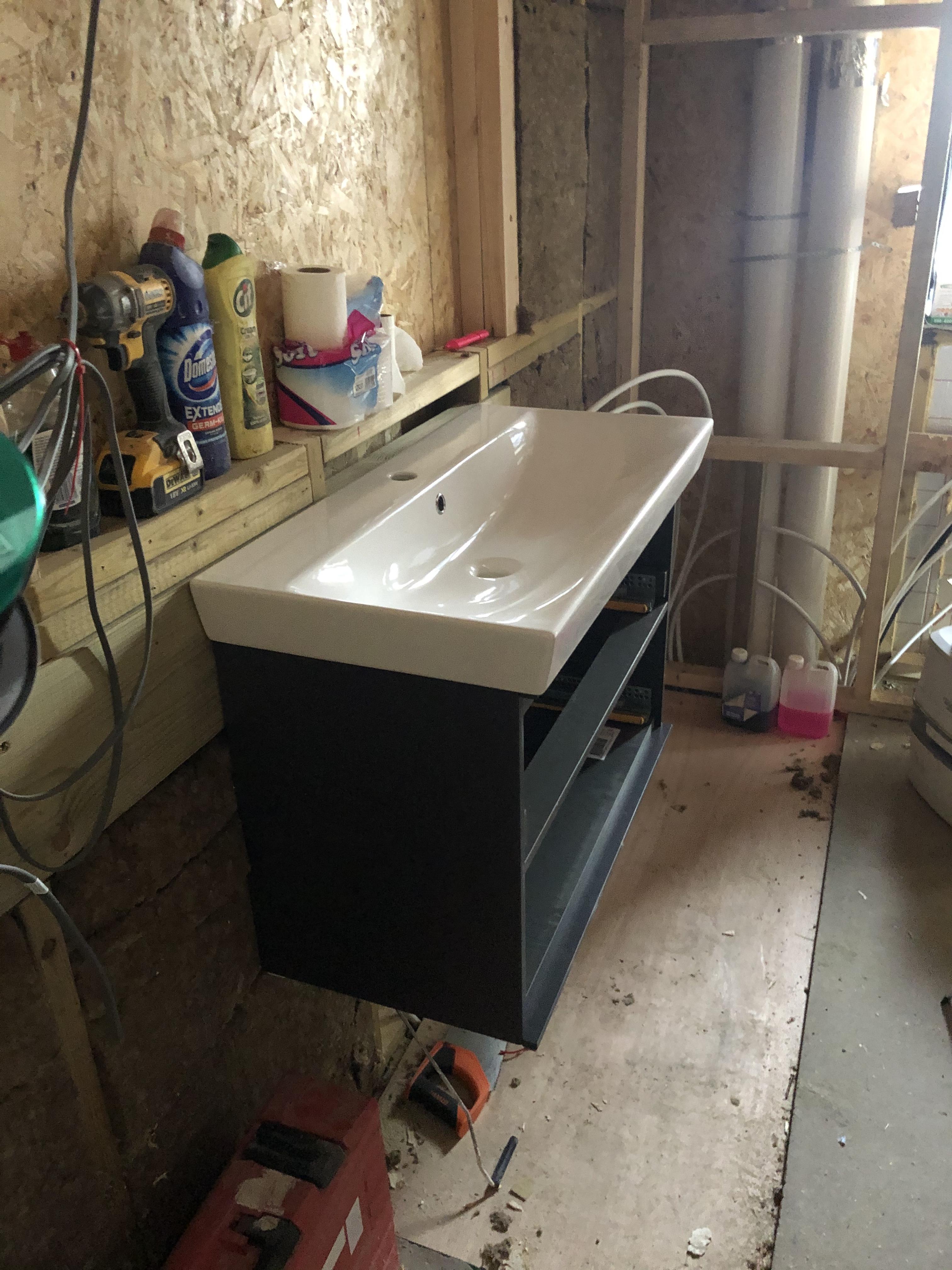

Pocster Posted March 12, 2020 Author Posted March 12, 2020 38” from finished floor to top of sink.. Cant go lower without cutting out that timber and lowering the support
Ferdinand Posted March 12, 2020 Posted March 12, 2020 (edited) 10 minutes ago, pocster said: 38” from finished floor to top of sink.. Here you go: https://www.nooshoes.co.uk/product-tag/high-heels-for-men/ Edited March 12, 2020 by Ferdinand 1
Pocster Posted March 12, 2020 Author Posted March 12, 2020 Gave in ! Lowered timber . Finished floor to top of sink around 34” ish That’s it ! Not moving it again
Ferdinand Posted March 12, 2020 Posted March 12, 2020 Did you just promise not to divorce and marry a basketball player?
MJNewton Posted March 12, 2020 Posted March 12, 2020 (edited) 2 hours ago, pocster said: 38” from finished floor to top of sink.. Cant go lower without cutting out that timber and lowering the support Be careful about inadvertently revealing expensive gear in the background. Unprotected toilet rolls on show like that are likely to attract burglars. Mods: Feel free to delete my quoted photo on security grounds if need be. Edited March 12, 2020 by MJNewton 3
Pocster Posted March 12, 2020 Author Posted March 12, 2020 (edited) 2 minutes ago, MJNewton said: Be careful about inadvertently revealing expensive gear in the background. Unprotected toilet rolls on show like that are likely to attract burglars. Mods: Feel free to delete my quoted photo on security grounds if need be. Christ you are right ! I’ve set myself up to be burgled ! . They’ll leave the sink and walk on glazing ( unfortunately) just knick the bog rolls ! Edited March 12, 2020 by pocster 1

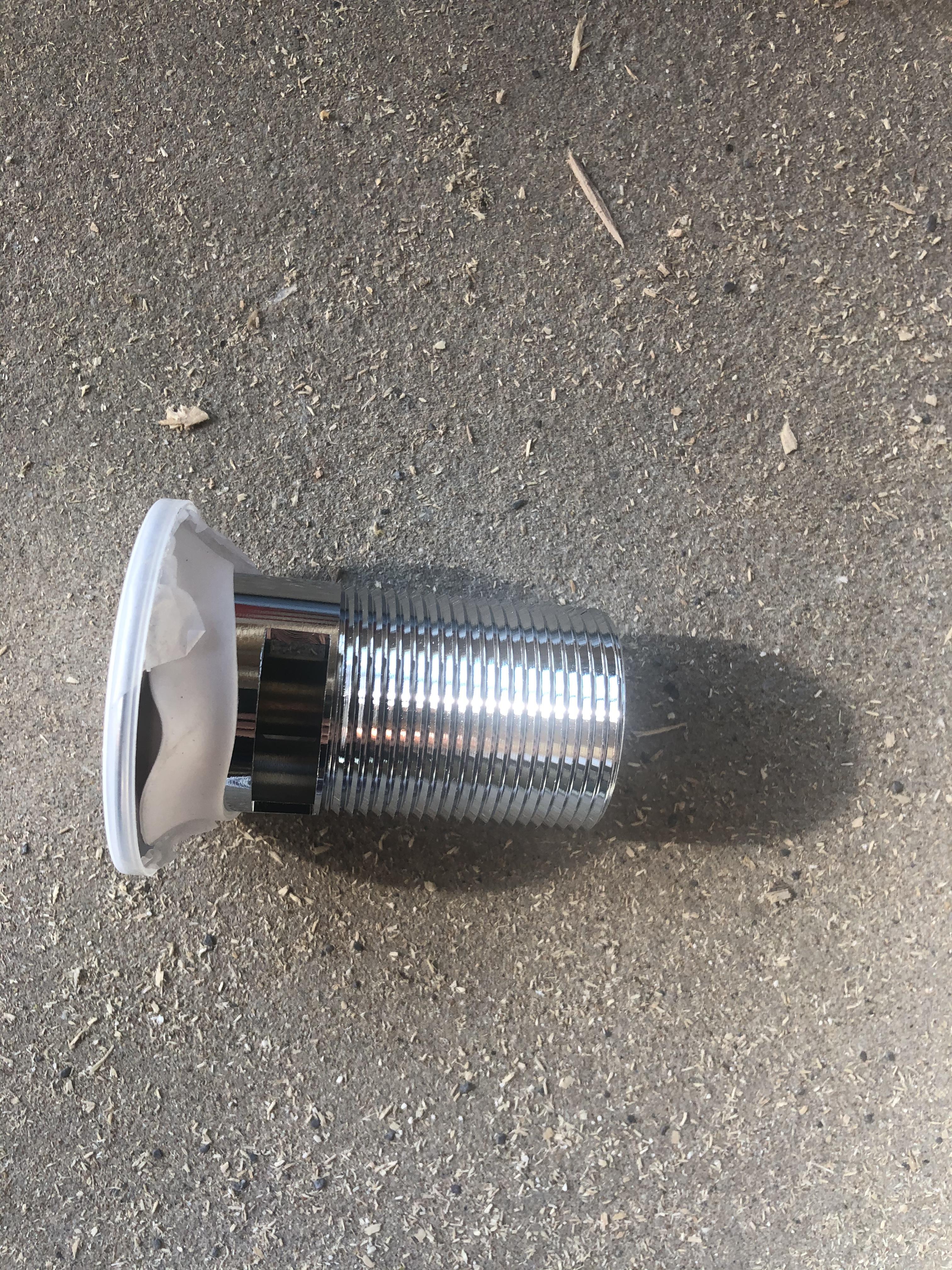

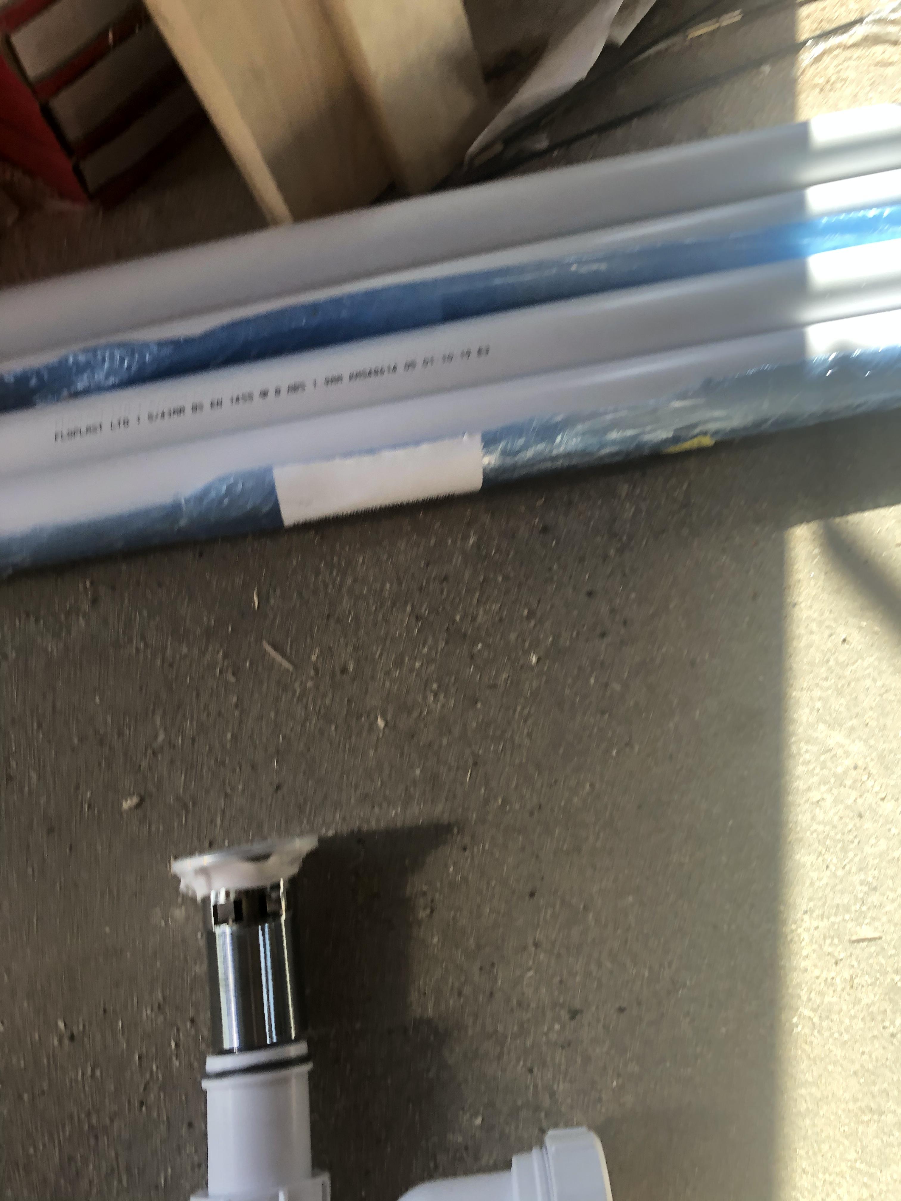

Pocster Posted March 16, 2020 Author Posted March 16, 2020 ok ; I seem to need something that lets me connect the sink plug to the waste .... ?
Onoff Posted March 16, 2020 Posted March 16, 2020 2 minutes ago, pocster said: ok ; I seem to need something that lets me connect the sink plug to the waste .... ? A bfo nut?
PeterW Posted March 16, 2020 Posted March 16, 2020 Looks like you’ve got the wrong bottle trap - that’s a 40mm and basin sinks use 32mm. Can use an adapter to take it to 40mm where required. 1 1
