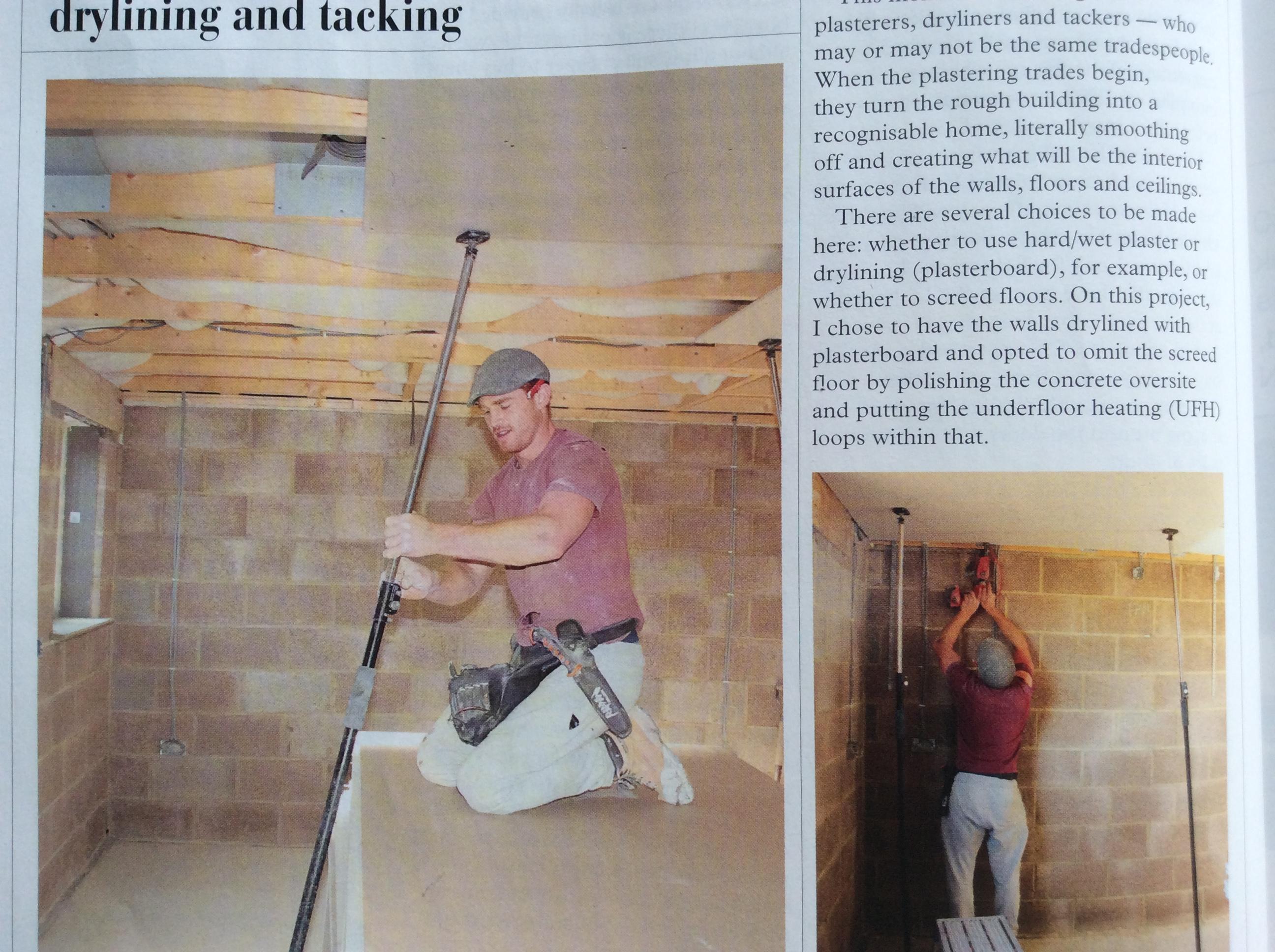

Onoff Posted March 7, 2020 Posted March 7, 2020 9 hours ago, zoothorn said: especially putting up a sheet it'll be a n'mare job never having done before Worst case you lift a board wrong or it slips and breaks over your head. Rite of passage for the DIYer! ? You can generally make use of the two broken bits somewhere! Just think how many "skills" were daunting for you when you started the kitchen. You had a go and learnt in the process with a very good looking end result. ? SQUARENESS! When you do your ceiling boards the whole room may not be 100% dead square on plan. Your plasterboards are dead square. Say you are fitting this as your first board. It can be a kick in the nuts to struggle lifting it up to find doesn't touch where it should! Then to struggle to measure how much needs to be trimmed. Two people AND some sort of support is handy. Don't underestimate how knackering it is holding a board above your head with one hand trying faff with a tape measure with the other! Pretty sure seasoned plasterers have all sorts of long term neck and shoulder issues. The idea is that first board fits tight against your double header on the long and short sides. On the left hand end the board wants to finish on the halfway line of the under side of whatever posi joist makes best use of the 2400mm long board. If it fits tight against the double headers on both sides then there's less gap for draughts etc and the subsequent wall plasterboards will support better the ceiling board. It might mean trimming both long and short sides to fit to ensure this. All depends how square the room is. This is where the board lifter "robot" as you called mine is dead handy. You could screw some wood screws horizontally into the header on the short end. Two of you then lift the board and poke the short end so as supported by the temporary screws. One then supports the board with a near fitting wooden T bar. The other measures up. Or screw a second T bar / horizontal batten to the wall studs to take the short end ... Many ways to skin next door's cat! Plenty of mad ideas on diy "dry wall" and plasterboard lifters on YouTube. I like this one. You could drive that with a cordless drill: Won't you end up though paying your electrician mate more than buying a board lifter and doing it on your own? For example: https://www.ebay.co.uk/itm/Pro-11FT-Drywall-Hoist-Lift-Plasterboard-Panel-Sheet-Board-Lifter-Tool-Jack-UK/193368916963? You can flog it afterwards and make half your money or more back.

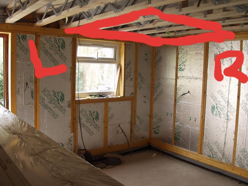

zoothorn Posted March 7, 2020 Author Posted March 7, 2020 @Onoff appreciate the info/ post as always.. Jose seems happy with his creation there, looks like my clothes horse thing: very clever I must say & maybe I could make too, except the handle mech bit seems a bit tricky. mmm.. I think maybe sensible to think on your robot one/ link & sell afterwards. Useful.. never knew of such things before (if I'd known I'd not have got builder to do top room pB + fluff @ £570 +vat.. oh well live n learn). Jose isn't using a vcl I notice: is a vcl more important to timber frame builds then? On the foil tape to seal my studs: is this the stuff to get.. https://www.screwfix.com/p/diall-insulation-board-tape-silver-45m-x-100mm/1634v
Onoff Posted March 7, 2020 Posted March 7, 2020 I can't imagine where Jose lives the temperature drops that low outside ever! ? I think his scissor lift is pretty cool. The handle mech, only a length of studding. Would need some bits of tube too and a few tack welds. That tape is fine. You don't have to vcl but I would, it's so cheap to do.
Taff Posted March 8, 2020 Posted March 8, 2020 I found these in a magazine, a couple of these wouldn’t break the bank
zoothorn Posted March 9, 2020 Author Posted March 9, 2020 On 06/03/2020 at 23:47, PeterW said: Decent plastering job will make it pretty airtight so don’t panic. I would use a cheap polythene layer for airtightness on the ceiling under the insulation in the workshop, bring it down the walls and tape it. Then board it when you’ve carefully measured and marked where your down lights will go. Hi PeterW. Thing I don't quite understand, is many of these how-to pB clips (Jose & Paddy with his timber rails).. no evidence of vcl. Surely if these two pros no have, then amateur-muggins here don't need. Saying that I might well be able to vcl both rooms' walls.. but I'd bet doing the lower ceiling is a stretch too far for me, but if I do walls & find it easy, then I poss could try ceiling (but not upper room one: pB is job done I'm afraid/ I know its far from ideal). @Declan52 cheers for the clip/ only just seen this reply. I notice Paddy here his downlights temp in: how much room would he have created in the PIR above each downlight? my spark wants a considerable area of my Frametherm 35 fluff (yet to buy) cleared around each he says.. urgh I say, surely the bigger the space (5x downlights) the more cold ^ up to my bedroom above via these 'burrows'. appreciated chaps- zoot.

zoothorn Posted March 9, 2020 Author Posted March 9, 2020 Ok one step at a time: at the moment I've got my 100mm foil tape ready to do (over the studs). Is there any tips on how or not/ just whack it on? I'm not finding any clips to help.. or any www info. I read that it can cut you up pretty good.
PeterW Posted March 9, 2020 Posted March 9, 2020 2 minutes ago, zoothorn said: with regard to my downlights. I can't get my head around the lights.. how they're worked into the equation, being in a dividing floor/ how are they even put in -? you put the cable in the right place, tack it out of the way and make sure there is plenty of slack then measure from the walls and make a map of where they go Then board the ceiling, get it skimmed and then the sparky comes along with a hole saw, marks the centres from the “map” and then you cut the holes. Cable is fished out, lamps wired and then fitted back into the ceiling. Job done.
PeterW Posted March 9, 2020 Posted March 9, 2020 Just now, zoothorn said: Ok one step at a time: at the moment I've got my 100mm foil tape ready to do (over the studs). Is there any tips on how or not/ just whack it on? I'm not finding any clips to help.. or any www info. I read that it can cut you up pretty good. It sticks to everything ... and it sticks to itself even better ..! Cut to length, doesn’t have to be the whole length, peel off the backing at the top and position it then slowly pull the backing off as you stick it down. Pretty easy to realign, and short bits can be easier than long lengths.
