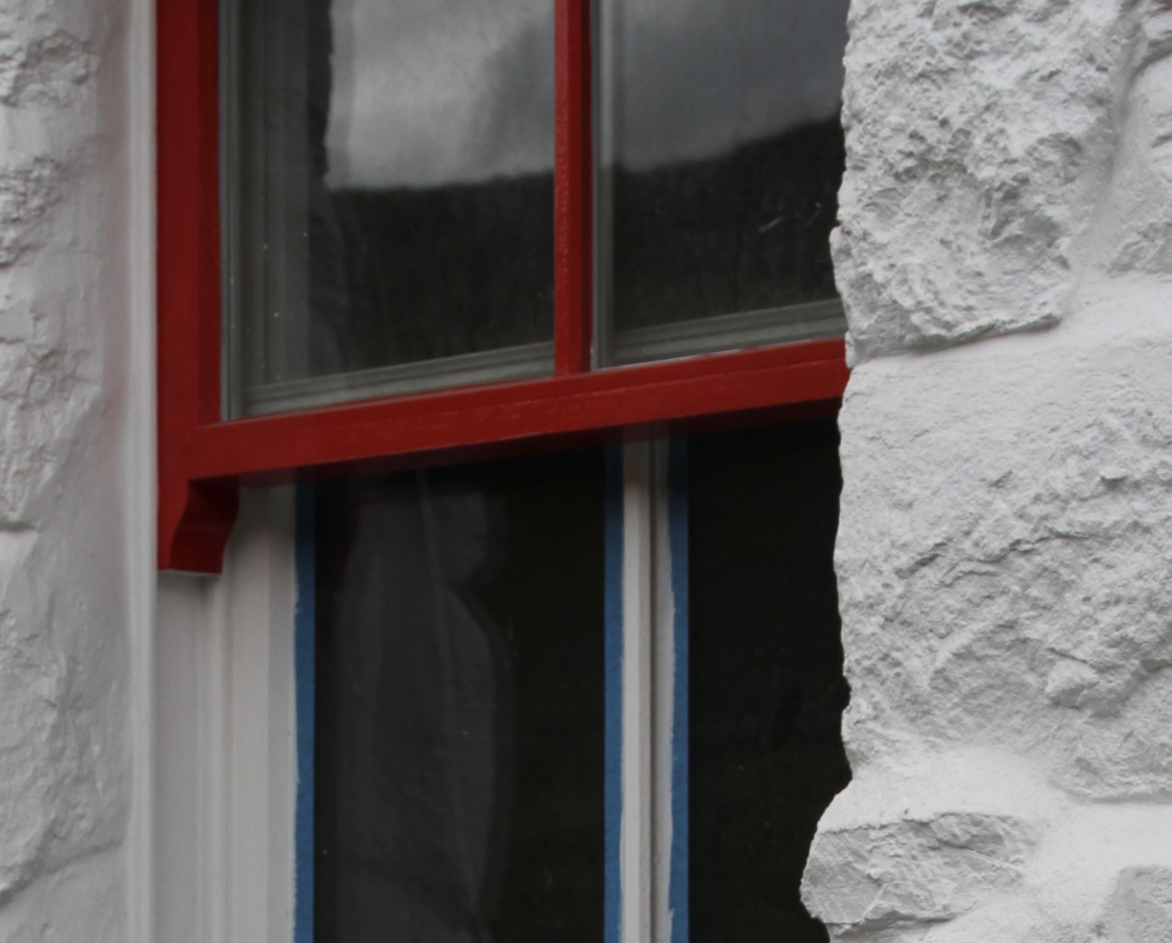

H F Posted February 18, 2020 Posted February 18, 2020 Just painting the master bathroom and got to the window and saw a few small signs of damp. I looked outside the window and have found small gaps in the mortar around the window frame. with these and storms water has obviously made its way in. is the solution remortaring in the summer or is there a chemical compound we can use?

Cpd Posted February 18, 2020 Posted February 18, 2020 (edited) Is it just the one small area ? Edited February 18, 2020 by Cpd
ToughButterCup Posted February 18, 2020 Posted February 18, 2020 You call those cracks ....... thats fair wear and tear ?

Ferdinand Posted February 18, 2020 Posted February 18, 2020 (edited) 1 hour ago, Home Farm said: No idea why these photos are upside down when I’ve uploaded them Stood on your feet not the head next time :-). Looks like an opportunity to learn repointing, but on an old house it is just wear and tear. Edited February 18, 2020 by Ferdinand
H F Posted February 18, 2020 Author Posted February 18, 2020 1 hour ago, AnonymousBosch said: You call those cracks ....... thats fair wear and tear ? Yeah, it is but still allowing water in. How can I block it?

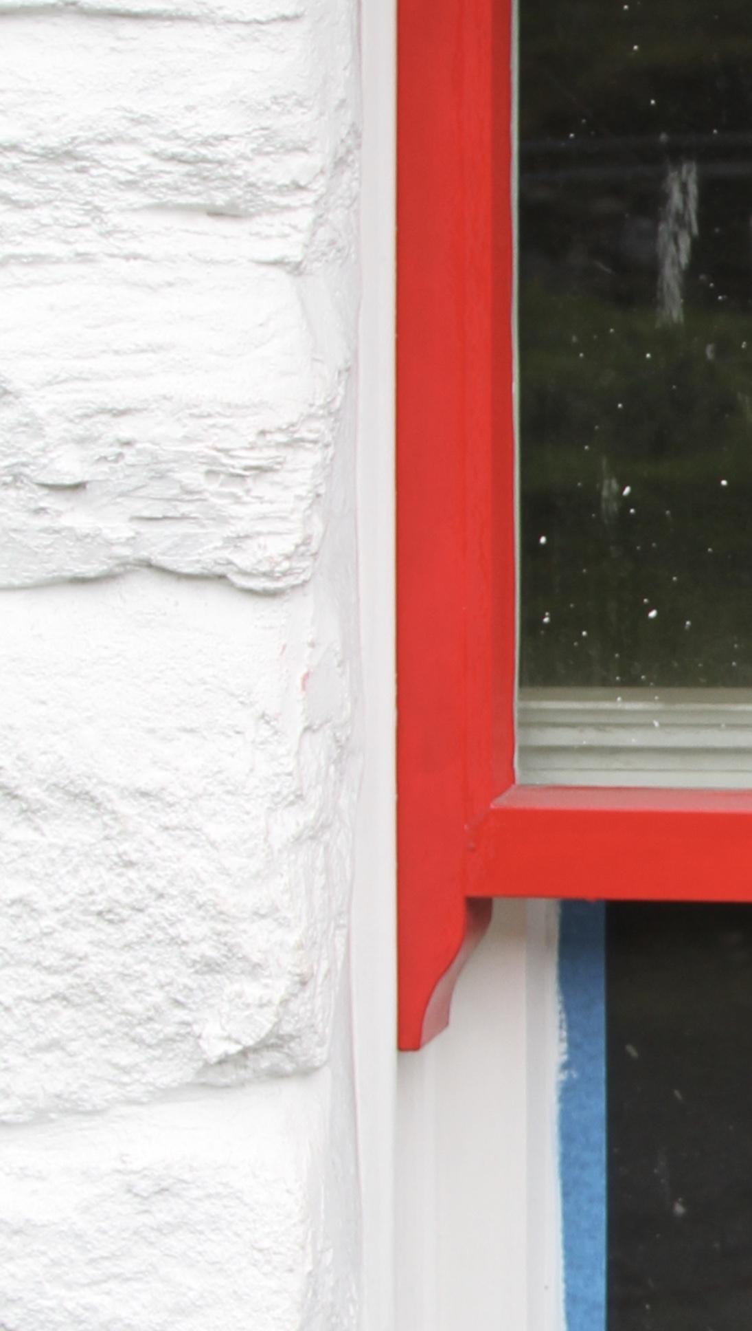

H F Posted February 18, 2020 Author Posted February 18, 2020 (edited) 2 hours ago, PeterW said: You mean the holes in the sealant ..?? Yes, but there are also gaps in the mortar. Edited February 18, 2020 by Home Farm
Russell griffiths Posted February 18, 2020 Posted February 18, 2020 Have you a better pic, it looks to me that this is not a window in an original location, if you look at the brickwork you would not end up with a mortar joint up against the frame. Looking at the terrible silicon I think it has been patched up previously i think it is probably a job for the spring where you will need to cut out all the manky stuff and work out where it is getting in. It is probably just penetrating through the jamb around the frame is it solid brickwork ?
Cpd Posted February 18, 2020 Posted February 18, 2020 The mortar has come away because the sealant has not provided enough of a backing for it and it’s just broken away from the brick, yes it’s just general wear and tear but exasperated in this location. For a quick fix just rake it out and make up a week mix of sand cement and lime and fill it back up again. As @Russell griffiths says come spring it would be a good idea to do a proper job, cut out all the shite and any loose mortar or bits of brick and have it redone properly.
Cpd Posted February 18, 2020 Posted February 18, 2020 28 minutes ago, Home Farm said: I take it you don’t typically use sealant? Yes? No? I have no idea. I think most people would use an expandable strip to seal round the windows (someone will know it’s name....) and then either silicone or some other covering to hide this. I used expanding foam round the edge of the frames, ct1 silicon between the stonework and the front of the frame and then made a Week lime, cement, sand mix and took this up to the wood as the frames were fitted from the inside. It was then painted and nothing has cracked or moved or leaked in the last 6+ years. My frames are hardwood and made by a friend of a friend. Probably not the proper way but I was just following my instincts.......
Simplysimon Posted February 18, 2020 Posted February 18, 2020 definately an opening cut out of a wall, bottom of last pic shows about 10mm after the joint where it's been cut. a repoint and seal should sort it.
