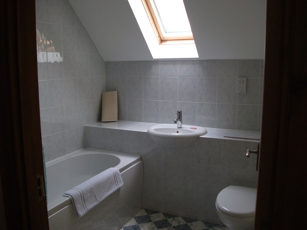

55 minutes ago, Stones said:
This is what we did in our last house and will be doing in the one currently being built. Works really well.
If it is *really* waterproof you could seal the door and have a plunge spa through the loft hatch.
Or an alligator tank.
