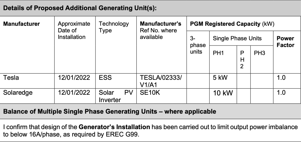

Marvin Posted August 12, 2022 Posted August 12, 2022 On 11/08/2022 at 08:49, Dillsue said: If the batteries are AC coupled then they have the potential to feed into the grid in addition to the 6kw PV you have approval to export. If your batteries can push out 5kw and your PV push out 6kw then your DNO will want to assess you potential export as 11kw. Thanks. This has pointed me in the right direction for my set up: If I am right, 6kW Hybrid Inverter (same kW as existing inverter )with DC battery connection so no need to be reassessed. 1
Dillsue Posted August 12, 2022 Posted August 12, 2022 56 minutes ago, Marvin said: Thanks. This has pointed me in the right direction for my set up: If I am right, 6kW Hybrid Inverter (same kW as existing inverter )with DC battery connection so no need to be reassessed. Spot on. If DC connected, the inverter does the overall limiting whether its from PV, batteries or both. Technically you should tell the DNO about the change of inverter and if the new and old have the same limited output and have a manufacturers cert on the ENA database there'd be no issue 1
Marvin Posted August 12, 2022 Posted August 12, 2022 1 hour ago, Dillsue said: Spot on. If DC connected, the inverter does the overall limiting whether its from PV, batteries or both. Technically you should tell the DNO about the change of inverter and if the new and old have the same limited output and have a manufacturers cert on the ENA database there'd be no issue Yes guessed as much. Thanks.
