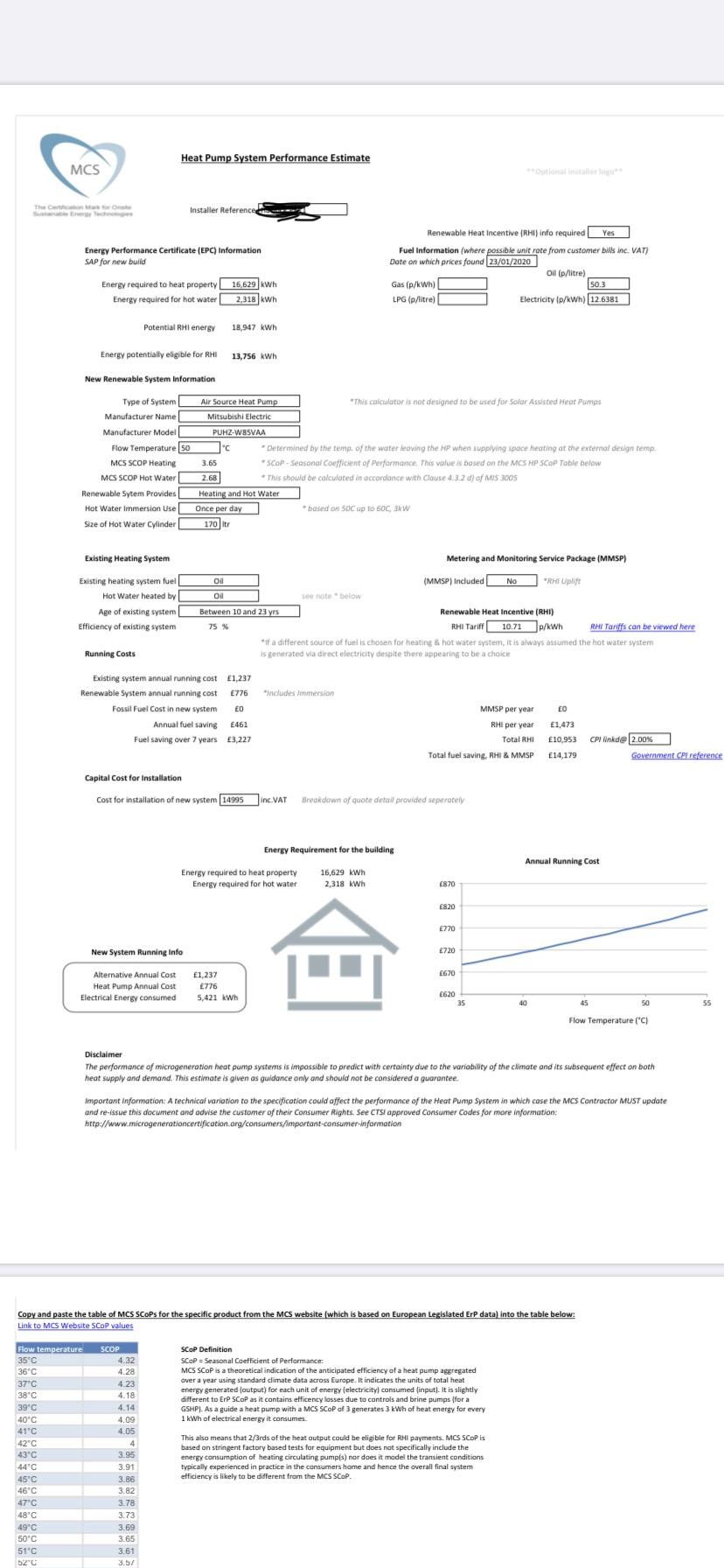

56 minutes ago, Benrh said:
 adding metering onto this system got me an extra £1600 so I’m now looking at a total of £12500k rhi.
Have you actually been on the rhi website and used the payment calculator yourself? Rather than just listen to the salesman?
I hope you havent gone for metering for payment? Or is it the performamce metering you have gone for?

If you have a recent EPC then you can do the calculation yourself  https://www.gov.uk/renewable-heat-incentive-calculator
Dont forget that the total KWH required to provide DHW and space heating will reduce after the ASHP is installed, and you need to get a post instillation EPC completed
Thank you for this I did the calculation and comes out at around £4500 based on my EPC from 18 months ago. I will send this on querying their figures
Honestly I’m not 100% Im waiting on this addition in writing however I believe it is the RHI Metering and monitor package
