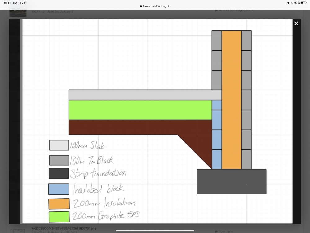

K78 Posted January 8, 2020 Author Share Posted January 8, 2020 (edited) 11 hours ago, PeterStarck said: @K78 Looking at your pictures I can understand your concern about possible breakout with ICF and how you could install bracing to counter that. I like your idea of using the lego blocks and hope that you are able to complete your build using them. It's nice to see different construction techniques being used rather than the same old methods. Good luck with the project. Thanks mate. In theory this should be the most simple. If the first course are spot on everything stays straight due to their Lego interlocking design. Having built a wall on a 10 degree incline with much bigger blocks, I’m really confident in our ability to quickly stack a house. Everything will be checked 10 times and signed off. Thanks for the encouragement. 11 hours ago, Cpd said: ^^^^^^ totally agree with @PeterStarck sounds like In This situation it (could) work. Again really looking forward to seeing a hubber pioneering new build methods. Triple check everything before putting your order in ! Edited January 8, 2020 by K78 Link to comment Share on other sites More sharing options...

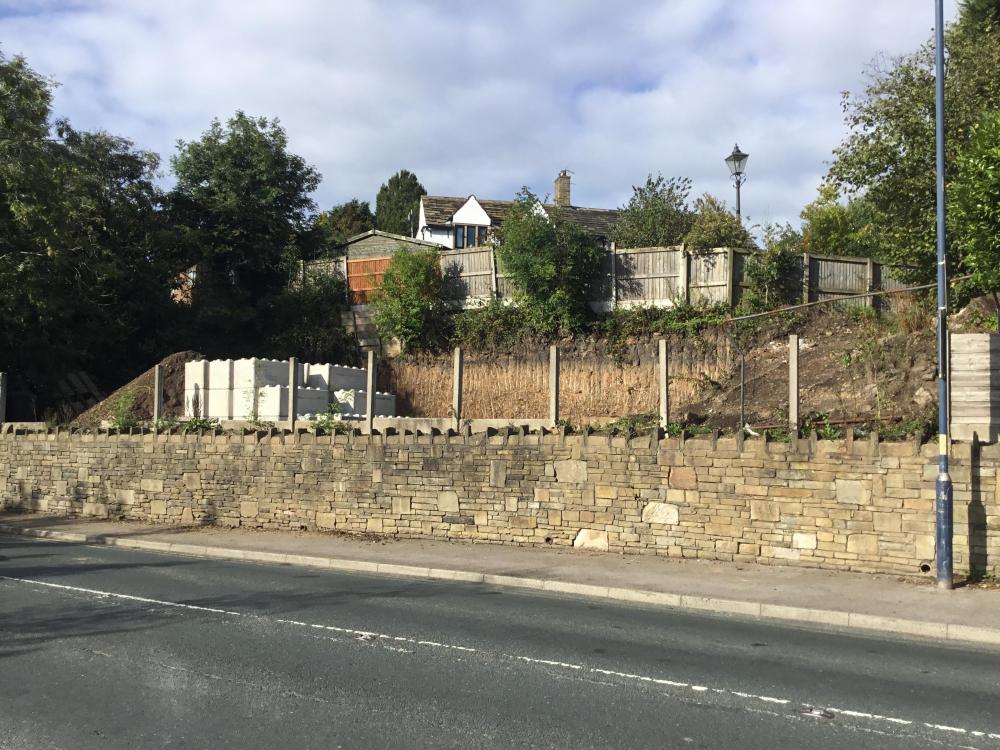

K78 Posted January 10, 2020 Author Share Posted January 10, 2020 (edited) On 07/01/2020 at 08:20, Russell griffiths said: Can you explain the risk with ICF not really with you, and what is the risk on your site ? if I look at the Lego blocks you are talking about I can think of so many reasons NOT to use them, and that is without trying. What are you going to do regarding block length? Will you be limited to building to block sizes, if you cut a block will the next row lock on top or not. How can icf be 3 times more expensive are you really adding up all the elements correctly lets say you have built your block structure with no problems, then what? you then need to add insulation to the outside to the whole structure, how?? you then need to cover the insulation, again how by the time you have brought your insulation and fixed it on you will be wishing you had never started. Not as far as I’m concerned you will need a structural engineer willing to sign off on it to design the lintels. What about foundation design, how heavy will it be. What about gable walls how will you cut them. The only reason icf would be considerably more expensive for myself, is that I would need a lot of extra bracing to make it safe. The only viable option would be to employ isotex or Durisol to build the house and I haven’t got the budget for it. If I had, I would instruct Jamie (Isotex) tomorrow to save myself the stress. If the lego walls are stacked in 2 days my labour cost including the machine would be £360. The same farmer with digger would do my strip foundations. There are many insulation cladding systems using wood or fibre cement over eps. They are not that expensive, easy to diy and I have 2 joiners assisting me with everything once the walls are up. The photo that i posted in a earlier reply clearly shows the danger specific to my site. It would be a public danger. Sometimes posts on forums can be read/interpreted differently from how they are intended. If I had a regular plot I’d buy isotex and enjoy building my own house. I am not for one minute saying concrete Lego is the future, and that everyone should go and buy it for a second. I’m just trying to explain why it suits my situation. No doubt it’s dangerous too. I nearly lost a finger stacking that wall. I really appreciate everyone’s opinions and advice as I’ve previously said. It’s all taken on board and considered. Edited January 10, 2020 by K78 Link to comment Share on other sites More sharing options...
K78 Posted January 12, 2020 Author Share Posted January 12, 2020 (edited) I can find many examples of dry stacked buildings likes this. Surely with a adequate strip foundation, thin set adhesive and EWI they would be fine for a house? I will get a answer from the supplier on Monday when he’s back from a extended Xmas break. Edited January 12, 2020 by K78 Link to comment Share on other sites More sharing options...

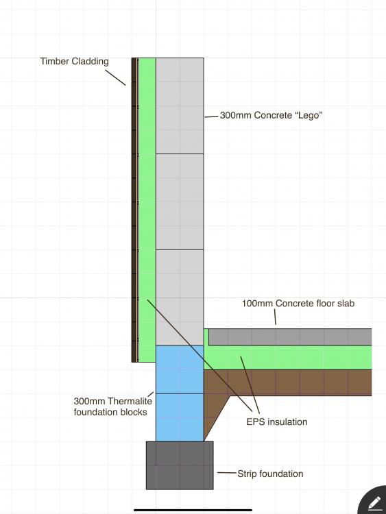

K78 Posted January 13, 2020 Author Share Posted January 13, 2020 Got a positive response today. They have built everything but a house (barns, underground bunkers, swimming pools, warehouses etc). They do sizes all they way down to 300x300x300. Lintels are blocks with reinforced steel cages inside. Currently go up to 1.8m long but could do 2.4, if there was demand. His concern with BR was insulation. He wasn’t really familiar with EWI systems. He is a concrete guy after all. They are bonded with a 2 pack resin which is suitable for industrial applications and swimming pools, so I can’t see it being a issue with a house? They let us build houses out of osb polystyrene sandwiches if we want to after all. ? Im also not the first crazy person to do this. He is sending me details of a house in Holland that was built from 300mm concrete Lego. 1 1 Link to comment Share on other sites More sharing options...
willbish Posted January 13, 2020 Share Posted January 13, 2020 @K78 sounds like you might be onto something. If you can get all your structural openings to marry with the size of the lego blocks so you don't have any cutting onsite it would be an easy build. One thing I think you may have missed when it comes to ICF is that when using the larger blocks (200mm EPS on outside skin) the chance of a blow out is zero. With my build I added additional strapping on the outside for the first pour (up to 2.8m) but was told this was totally unnecessary. For the second pour I put nothing on the outside at all. The inside was obviously fully braced and strapped. No blowouts, no bulges, no movement on the outside skin in the slightest. If you think about it a 200mm block of EPS sandwiched in on all sides cannot twist or deform enough to blow. Different story for the 70mm inside skin where I do have a couple minor bulges in places where the bracing was not sufficient. Might be another option to consider if the Lego doesn't stack 1 Link to comment Share on other sites More sharing options...
