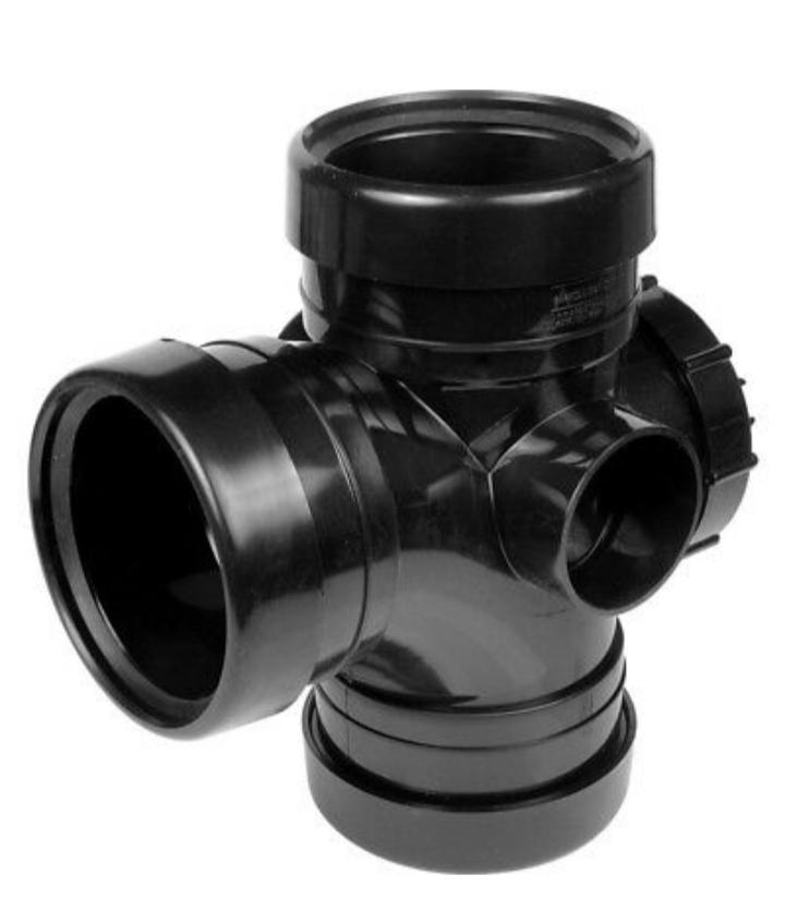

dpmiller Posted January 6, 2020 Share Posted January 6, 2020 41 minutes ago, Onoff said: The branch has a screwed on access cap like this: I fitted it as I was worried about future access to the near horizontal wc waste pipe from the new, wall hung wc downstairs. That should give great access. However, I unscrewed the cap last night for the first time, in the dark and it looks like I need to take a Starrett to it to open it up? Maybe there's a close fitting, push fit plug I didn't see under the screw cap? yep, pretty sure there's an insert under the cap. 1 Link to comment Share on other sites More sharing options...
LA3222 Posted January 6, 2020 Share Posted January 6, 2020 16 minutes ago, dpmiller said: yep, pretty sure there's an insert under the cap. There is...I have this very same fitting on the foul pipe I put in for the static caravan. The lid unscrews and then there is a plastic insert underneath which just pulls out. 1 Link to comment Share on other sites More sharing options...

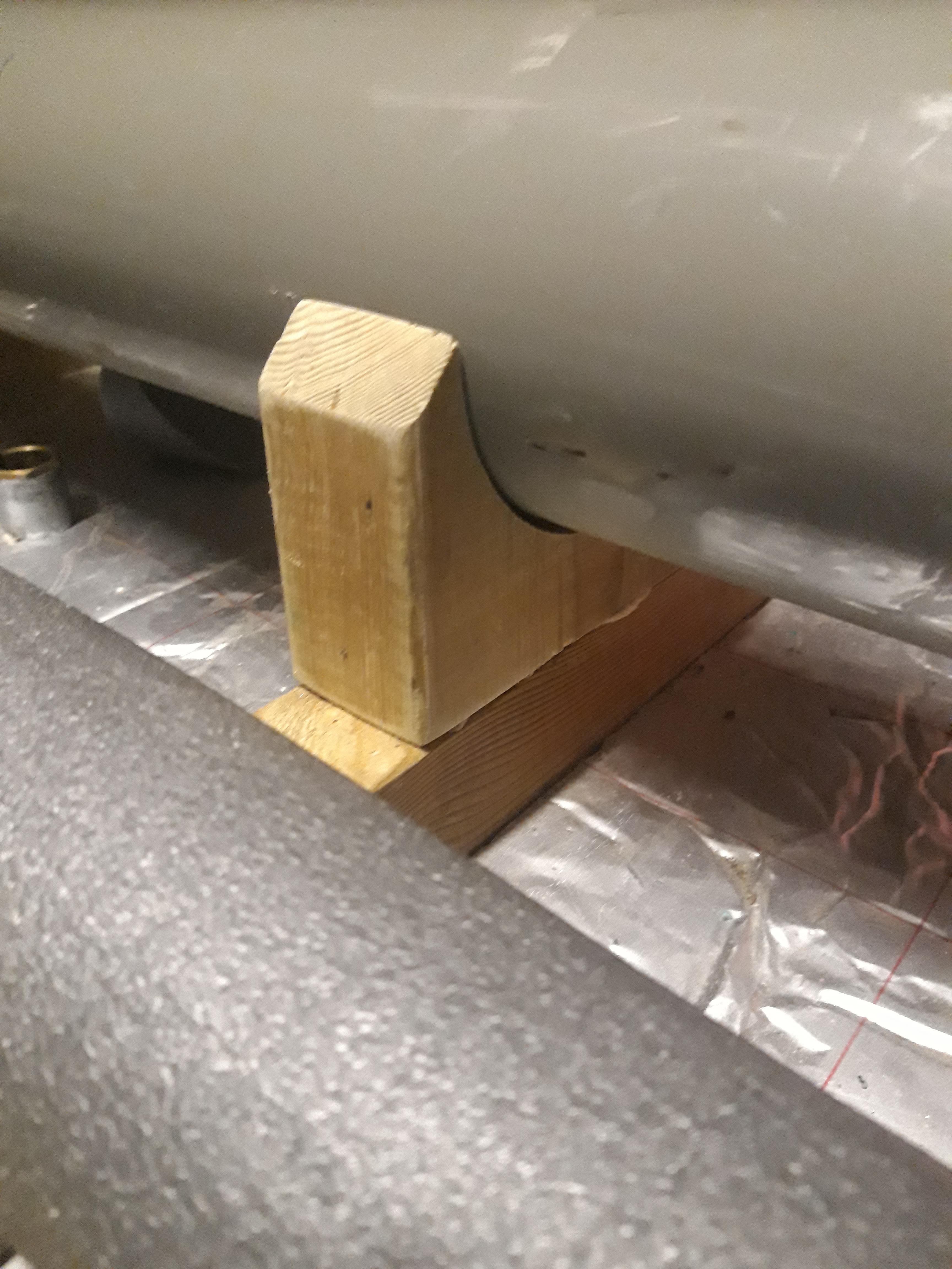

Jeremy Harris Posted January 6, 2020 Share Posted January 6, 2020 In my experience, the usual cause for soft blockages like this is a build up of stuff (often partially dissolved toilet paper) on the walls of fairly flat runs of pipe, inside the house. I think what happens is that a few bits get stuck, then dry out partially and stay stuck, then more bits stick to them, until such time as the restriction is enough to trap a "wodge" of stuff coming down the pipe. At that point the liquid slowly filters through, leaving solids behind. Things gradually get worse, as more and more solids build up, and toilet paper, which usually breaks down into fine fibres fairly quickly, ends up not being in enough liquid to do so where the blockage is. The advantage of using strong sodium hydroxide (caustic soda) is that it aggressively breaks down organic matter, including paper. This fragments the blockage and allows it to be flushed away. The first house we bought had the foul drain run relocated, when the house went onto main drainage, and this resulted in a run across the back of the house that had very little fall. It used to regularly block, and at first I used to borrow rods, poke hoses down it, and generally get covered in muck clearing the blockage. Someone gave me the tip about using sodium hydroxide and I've never had to rod a drain clear since. A strong enough dose of sodium hydroxide solution, ideally as hot as a bucket can withstand, will generally work its way through any blockage within an hour, often less. This will also clear rainwater pipes etc that are blocked with dead leaves, as it will dissolve them just as well. On the shelf behind me I have six1 kg packs of sodium hydroxide, left over from the last time I had to do this job. I think there may well be another couple of 1kg packs tucked away in one of the cupboards. Link to comment Share on other sites More sharing options...
Onoff Posted January 6, 2020 Author Share Posted January 6, 2020 7 minutes ago, Carrerahill said: OK having seen the rest of the images and read your additional info and as mentioned by someone else above, the blockage could not have been backing up too high or else your ground floor pan would have overflowed. If you knock the soil pipe in the loft, or even try to slightly lift it by hand does it feel heavy like that whole horizontal section is full? I think if if that was me I would get a piece of garden hose (perhaps a bit you are happy to bin afterwards) and some gloves on and shove it down the access point and round that bend from the loft. If it doesn't clear by the time you get to the horizontal section (i.e. passed via the 2 No. 45°'s) then I would abandon ship there and try it from outside. Get the camera on the tripod first. Vertical black stack outside is empty as in it "tapped" hollow. You can anyway feel its empty just by wobbling it. I removed the screw on cap and the push fit plug. Clean as a whistle and I could see right along the horizontal waste to the downstairs bathroom wc. Now the weird bit: Up in the loft I started tap, tapping on the pipe with an off cut of 15mm copper. It sounds hollow from where it exits at the eaves back to about halfway along the horizontal pipe. From the half way point back to the two grey branch arrangement sounds solid and "full". I put a straight edge on the pipe and there's maybe a very slight dip in the middle. I meant to but never finished, cut ever decreasing height supports thus theres only one like this cut and glued to a ceiling joist: 500ml of that cleaner @jamiehamysuggested but I think the blockage is too far down. Just awaiting Amazon for the drilly, twisty unblocker thing. Link to comment Share on other sites More sharing options...
Jeremy Harris Posted January 6, 2020 Share Posted January 6, 2020 Mirrors my experience of always getting soft blockages in a fairly flat run of pipe. It may be that very slight variations in the fall along the pipe create enough flow variation to cause some "stuff" to just start to stick and build up on the pipe at that point. Link to comment Share on other sites More sharing options...
joe90 Posted January 6, 2020 Share Posted January 6, 2020 19 minutes ago, Jeremy Harris said: Mirrors my experience of always getting soft blockages in a fairly flat run of pipe. It may be that very slight variations in the fall along the pipe create enough flow variation to cause some "stuff" to just start to stick and build up on the pipe at that point. which is why I was careful to support my drain runs located under floors where access was not possible and a min diameter of 50mm. I have found that pipes that exit hot water (baths basins and showers) can sag quite a lot over time causing just such a problem. 1 Link to comment Share on other sites More sharing options...
ProDave Posted January 6, 2020 Share Posted January 6, 2020 I often wonder how this one will fair in the long term. Dead flat run between the joists. Out of shot it then turns right to the en-suite with not much fall on it. Far too many places for a blockage to occur imho and nowhere for rodding access. It was done by a plumber. 1 1 Link to comment Share on other sites More sharing options...
