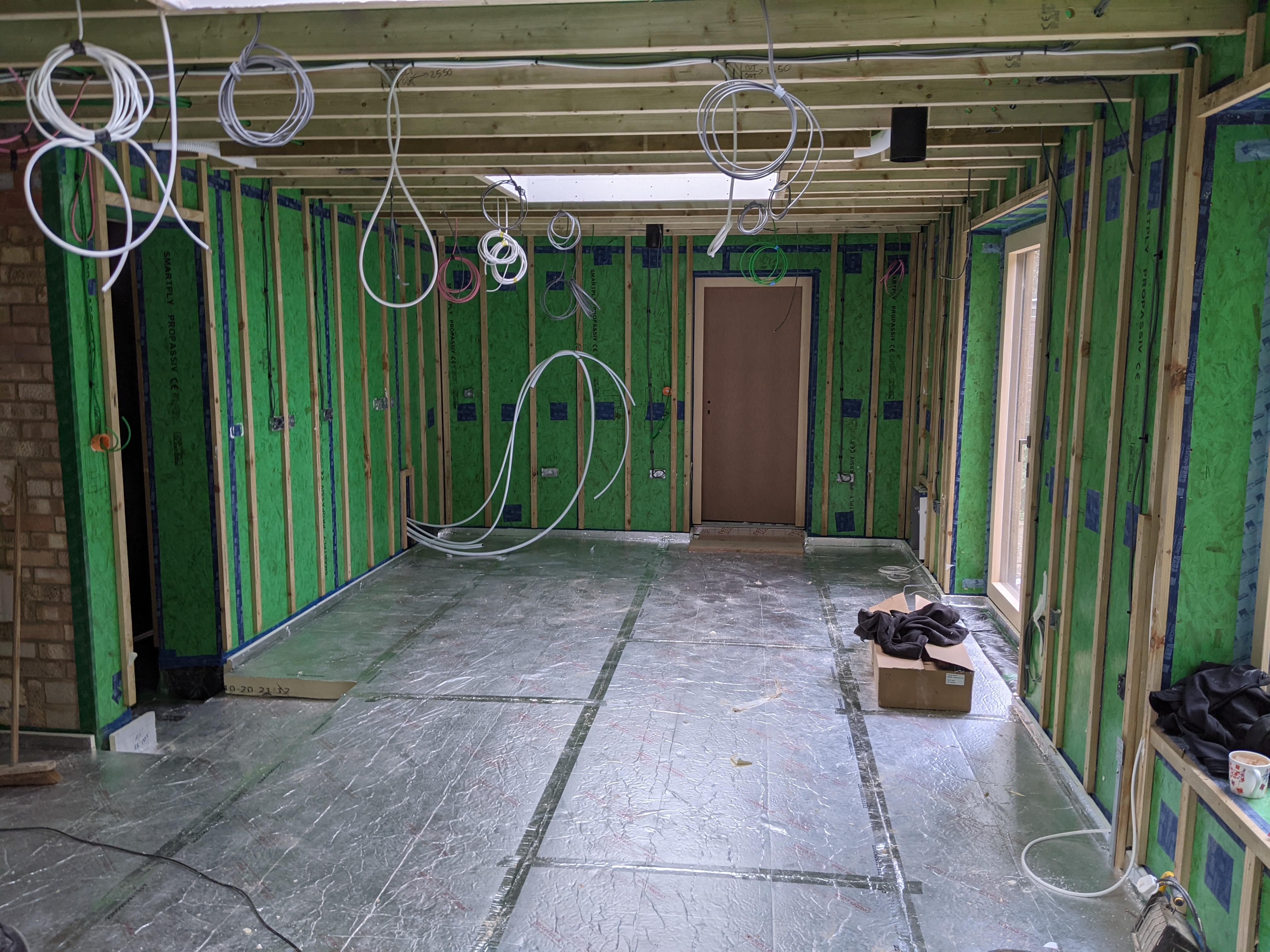

joth Posted October 22, 2020 Posted October 22, 2020 (edited) 19 hours ago, tanneja said: @joth, my apologies if you have answered this in another thread, but did you end up going down this route? Did you find anything more economical? Many thanks Yes we did, from Lathams. There was a bit of a last minute flub up with it. I thought it comes in inward opening only, but when ordering our contractor saw it has outward opening too which is more convenient to use so we swapped to that (with out PH designer's blessing). But ... this means the airtightness boundary has to pass under and through the threshold to the seal on the outside face rather than being on the inside, which our joiner was really unimpressed by and called the whole door a piece of overpriced rubbish which obviously smarts a bit after putting that much down on it. (Same feelings with the cost:quality of the petwalk door, for slightly different design shortcoming reasons). So anyway if doing this again I'd keep with the inward opening door. I now really understand why passive houses prefer inward doors. It's all about the thresholds, stupid. (Well, I guess houses with airtightness boundary on the outside of the walls would prefer outward doors?) 18 hours ago, Dan F said: 68mm Ferro Firesafe EI30 (assuming you need 30min fire door). U-value I was quoted for the whole doorset was 1.02 vs. 0.76 for the passive version. Getting an insulated fire proof door is easy: just glue a shedload of cellotex to a cheap FD60 door and have your thermal consultant knock up an installed U-value for the result. Seen a couple houses do that. The key thing about the Moralt passive rated door is the airtightness rating. Does Ferro Firesafe have that? But also, see my comments above..... :-/ 2 hours ago, tanneja said: If those kind of prices are not just for the blank but for the frame and other bits of kit (as stated as an offered package on the german manufacturer website) that is interesting. Yeah.... it is a full doorset. It doesn't have a the eurolock cylinder nor door handle, again to my joiner's disgust, and the lock mechanism that came with it is currently removed as he was struggling to get the spring to fire reliably. I'm like sure, "add it to the snagging list". Attached is the only photo I have of it. Edited October 22, 2020 by joth 1
tanneja Posted October 22, 2020 Posted October 22, 2020 @joth i really do appreciate you sharing your experience, and am disappointed for you by the issues you have faced. Sincerely hope the house ends up as good as the progress picture implies it will be. Builder is emailing Lathams tonight. Would like to retrofit strip wood to the front of it to have the porch be a strip wood facade. Hopefully all doable. 1

joth Posted July 30, 2021 Posted July 30, 2021 On 22/10/2020 at 18:53, tanneja said: @joth i really do appreciate you sharing your experience, and am disappointed for you by the issues you have faced. Sincerely hope the house ends up as good as the progress picture implies it will be. Builder is emailing Lathams tonight. Would like to retrofit strip wood to the front of it to have the porch be a strip wood facade. Hopefully all doable. Bit more disappointment to throw on the Moralt bombfire this week 1/ The final air-test came back at 0.6ACH. Borderline for Passive house but still bloody excellent for a retrofit like us, but down on the 0.5 we had before 1st fix. The new leaks are the shitty-smelling low profile ground floor shower trap, and the threshold of the damn Moralt door 2/ Final BC sign off is delayed because of... 2 issues with the Moralt door: no auto-closer, and no intumescent strips. Now, the fact it's PH certified airtight _should_ make the intumescent redundant, but UK BC don't know that, our plans called for intumescent strips, and my contractor has misplaced the manufacturer manuals/certs that might have stated otherwise. 3/ A friend pointed out that a lot of house insurance small print require a deadlock from house to garage. The silly lock mech in the Moral door is latch only, absolutely no way to deadlock it. Yeah it's all very liveable/solvable, but having spent so much on this damn door it's sad to be repeatedly so disappointed by it. 2
