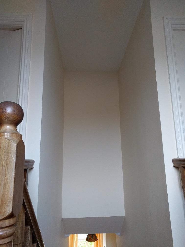

mike2016 Posted December 21, 2019 Posted December 21, 2019 I've been looking at retrofitting a Brink MVHR unit into my 3 bed semi detached property - 2 story. The unit/system won't fit in the hot press, attic or utility room. I got the idea of trying to see if it would fit above the stairwell (with the manifolds in the attic) but wanted to check if anyone knows of any buildings regulations that would prevent this? Fire etc? If this is possible, I'll need to find a way to secure the 37 Kg unit (Flair 325). There are just stud partitions all around that area and I don't want to suspend it from the roof trusses above which are not designed to take a downward load. Any ideas? Would the studs be safe to secure this load to? Thanks!
joe90 Posted December 21, 2019 Posted December 21, 2019 I don’t see why not, I am sure the studs can take a compressive load as long as good fixings are used (bolts?). My only worry would be noise, make sure it’s mounted on good rubber mounts and surrounded with sound deadening material. Mine is hung from roof trusses rather than sitting on ceiling joists and no noise can be heard at all. 1

mike2016 Posted December 21, 2019 Author Posted December 21, 2019 Thanks Declan - considered monkey bars but will probably install a telescopic ladder or some such means to reach the front of the unit, or mission impossible rapel down from above?! The brink units look a breeze (apologies) to swap in and out filters. I just don't want the unit falling on my head one day....!
