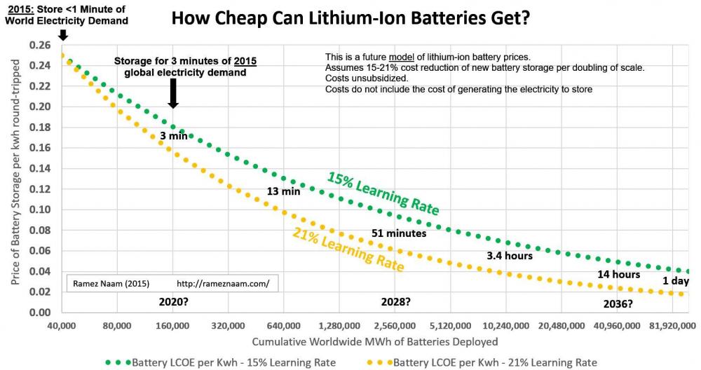

Carrerahill Posted December 5, 2019 Author Posted December 5, 2019 1 minute ago, AnonymousBosch said: Common sense always spoils a good story dunnit? It does, but prices have to fall and the story will sound sweet again. Look at USB sticks, I remember it was over £100 for 64Mb. Now they give away 2Gb sticks for free and a good quality 64Gb stick is £15.00
Ed Davies Posted December 5, 2019 Posted December 5, 2019 Also electricity prices (at least at peak times) have to go up.
SteamyTea Posted December 5, 2019 Posted December 5, 2019 (edited) 13 minutes ago, Carrerahill said: Look at USB sticks, I remember it was over £100 for 64Mb. Now they give away 2Gb sticks for free and a good quality 64Gb stick is £15.00 Not really comparing the same technology. The difference in price on my E7 tariff is about 12p/kWh. I consistently use less than 2 kWh during the peak rate period during the day. But the important thing is how much power can the inverter deliver. It would have to be around 6 kW to be any real use. 6 kW is the kettle and cooking lunch. No good saving up power but still having to import for a normal daily activity. Edited December 5, 2019 by SteamyTea
MikeGrahamT21 Posted December 5, 2019 Posted December 5, 2019 51 minutes ago, SteamyTea said: Not really comparing the same technology. The difference in price on my E7 tariff is about 12p/kWh. I consistently use less than 2 kWh during the peak rate period during the day. But the important thing is how much power can the inverter deliver. It would have to be around 6 kW to be any real use. 6 kW is the kettle and cooking lunch. No good saving up power but still having to import for a normal daily activity. Cook your lunch first, and then make a cuppa afterwards ? Agreed though, going to be a long time before battery tech will be going in my house, if ever, if current electric prices prevail.
Carrerahill Posted December 5, 2019 Author Posted December 5, 2019 50 minutes ago, SteamyTea said: Not really comparing the same technology. The difference in price on my E7 tariff is about 12p/kWh. I consistently use less than 2 kWh during the peak rate period during the day. But the important thing is how much power can the inverter deliver. It would have to be around 6 kW to be any real use. 6 kW is the kettle and cooking lunch. No good saving up power but still having to import for a normal daily activity. It is just the principle, I think all will agree, tech is tech - the costs always do the same thing. Pick anything from TV's, a TV was over a years average salary, or mobile "car" phones, SSD drives. I am not going to defend a product I was only mentioning and posting on the forum for discussions sake, I didn't make it, I didn't buy one and I think at the price point it is not going to be a particularly good investment or money saving device. Regarding the inverter I will ask the rep when I email him for the PDF literature, although I sure it will be in the tech spec. I am looking at this battery for a commercial project of ours where if it all adds up it will save our customer about £3K system costs for his needs.

SteamyTea Posted December 5, 2019 Posted December 5, 2019 1 hour ago, Carrerahill said: tech is tech I seem to remember a quote from, or about Bill Gates. Went something along the lines that if cars were computers they would travel at 1000 MPH, do 500 MPG and cost $10. (here was a reply that all the controls would be in different places each time there was an update). I think our @Ed Davieslooked into comparing the price of PV modules and double glazed windows a few years back. Seem to remember that they were about the same price per square metre. Bricks are technology, why do they not cost a penny each.
Carrerahill Posted December 5, 2019 Author Posted December 5, 2019 (edited) 1 hour ago, SteamyTea said: I seem to remember a quote from, or about Bill Gates. Went something along the lines that if cars were computers they would travel at 1000 MPH, do 500 MPG and cost $10. (here was a reply that all the controls would be in different places each time there was an update). I think our @Ed Davieslooked into comparing the price of PV modules and double glazed windows a few years back. Seem to remember that they were about the same price per square metre. Bricks are technology, why do they not cost a penny each. You are trying to transpose the logic too linearly, you accused me of not comparing similar tech and now we are comparing Tesla batteries to computers & cars, but you, in your discussion found that it was a comparison worth making so at some level you believe that the principle of tech pricing is the same and it is. We could compare mobile phones to Tesla batteries, or central heating boilers or cordless power tools. There is a minimum price point of any product, that true price is often only known by a producer/manufacturer who controls the whole production/manufacturing process which is rare. For example, just how much is a barrel of crude oil, really, and I don't mean daily barrel price - about $55-60 today. We know that is just an average price, some oil, North Sea, is more expensive to extract that the Texas land oil fields using nodding donkeys. Gold extraction, again only really the operators who actually run that operation on their claim/lease will know what it actually costs them per oz. they will always suggest more. So all these manufacturers need "x" for their commodity or product and each has a minimum margin they need to make, so something like a car will never cost $10 - what Gate's would have been better providing is the % cost reduction and applying that to a car and actually it may be comparable given that in today's money the first car cost $95K. You probably couldn't cast the engine block for $10 - so there will always be a minimum price. A brick probably does only cost about a penny, a common is about 17p from my local merchant, but how much of that is profit margin and transport? You load them onto a wagon at the factory and they go to a depot, then another wagon takes them to a merchant, or B&Q and each time that brick moves, due to size and weight, it accrues more cost and transport for that type of load is expensive. How many people had a TV in their living room in say 1960? How many people have a TV in each lounge, bedroom and maybe kitchen and a few spare disused ones in the loft in 2019? The same will go for the Tesla battery, once every street in the UK has at least 1 Tesla battery, the price will fall. So the price will fall, and then it will be affordable and ROI's will be acceptable. Edited December 5, 2019 by Carrerahill
