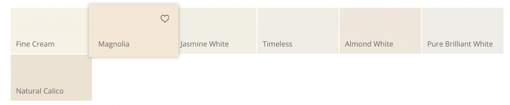

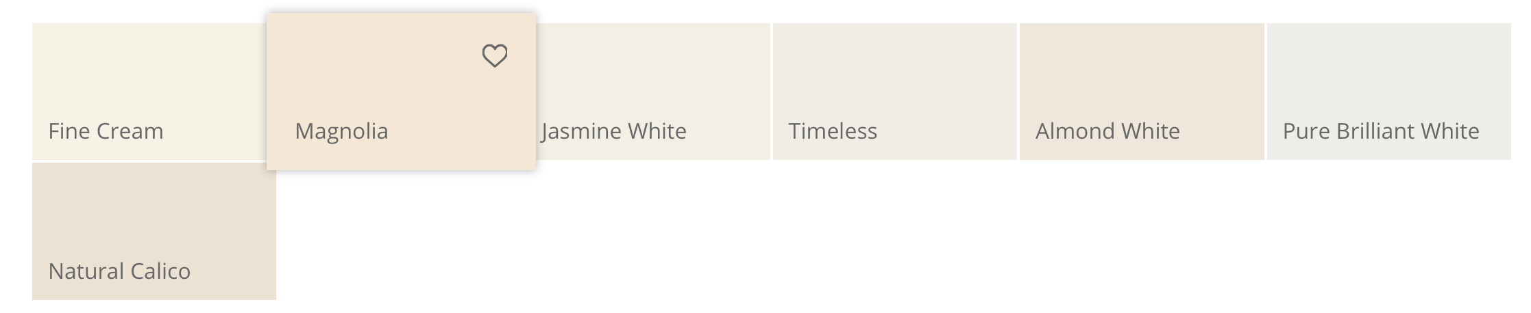

Conor Posted December 3, 2019 Share Posted December 3, 2019 (edited) 9 minutes ago, Dreadnaught said: I also like the idea of using a wipe-clean gloss paint in the area around the vent itself. Good idea @Conor. Dulux endurance kitchen paint. Have it behind our current hob instead of a splashback. Very easy to wipe down and surprisingly durable so far. Edited December 3, 2019 by Conor Link to comment Share on other sites More sharing options...

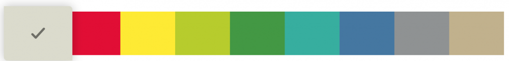

Dreadnaught Posted December 3, 2019 Author Share Posted December 3, 2019 3 minutes ago, Conor said: Dulux endurance kitchen paint Good recommendation. Thanks. I see it comes in matt too and "Dulux Easycare Kitchen paint is an exceptionally tough grease resistant paint.": The colour choice, however, looks a little bit primary but the may just be my screen: Link to comment Share on other sites More sharing options...
Dreadnaught Posted December 3, 2019 Author Share Posted December 3, 2019 Oh no, that was just a website tool. The colour palettes seems to be: … much less Laurence Llewelyn-Bowen. Link to comment Share on other sites More sharing options...
