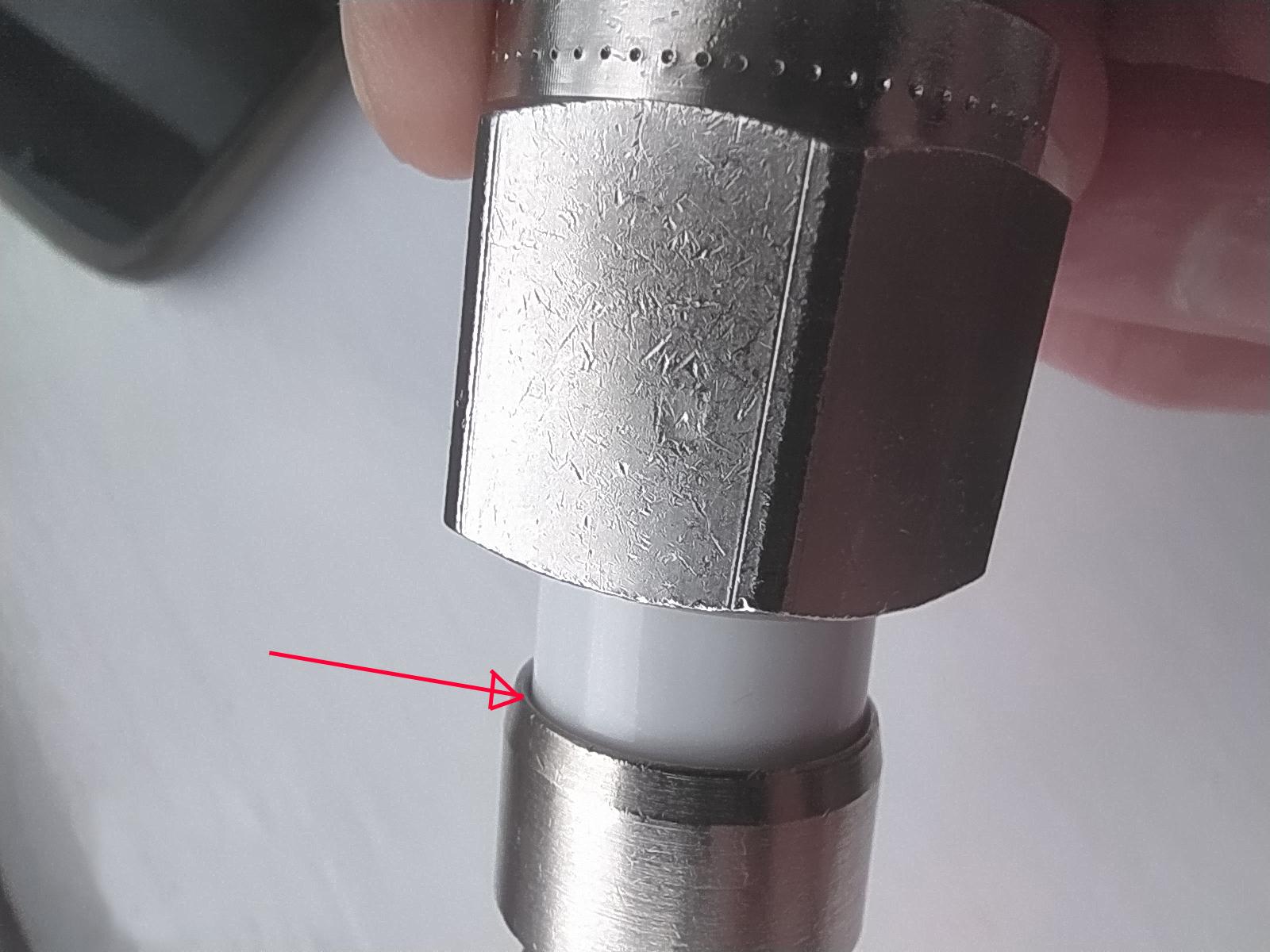

dpmiller Posted May 20, 2022 Share Posted May 20, 2022 @WillCram just check the length of the bits- is there any chance the adaptor crimps down onto the pipe as it's tightened? Link to comment Share on other sites More sharing options...

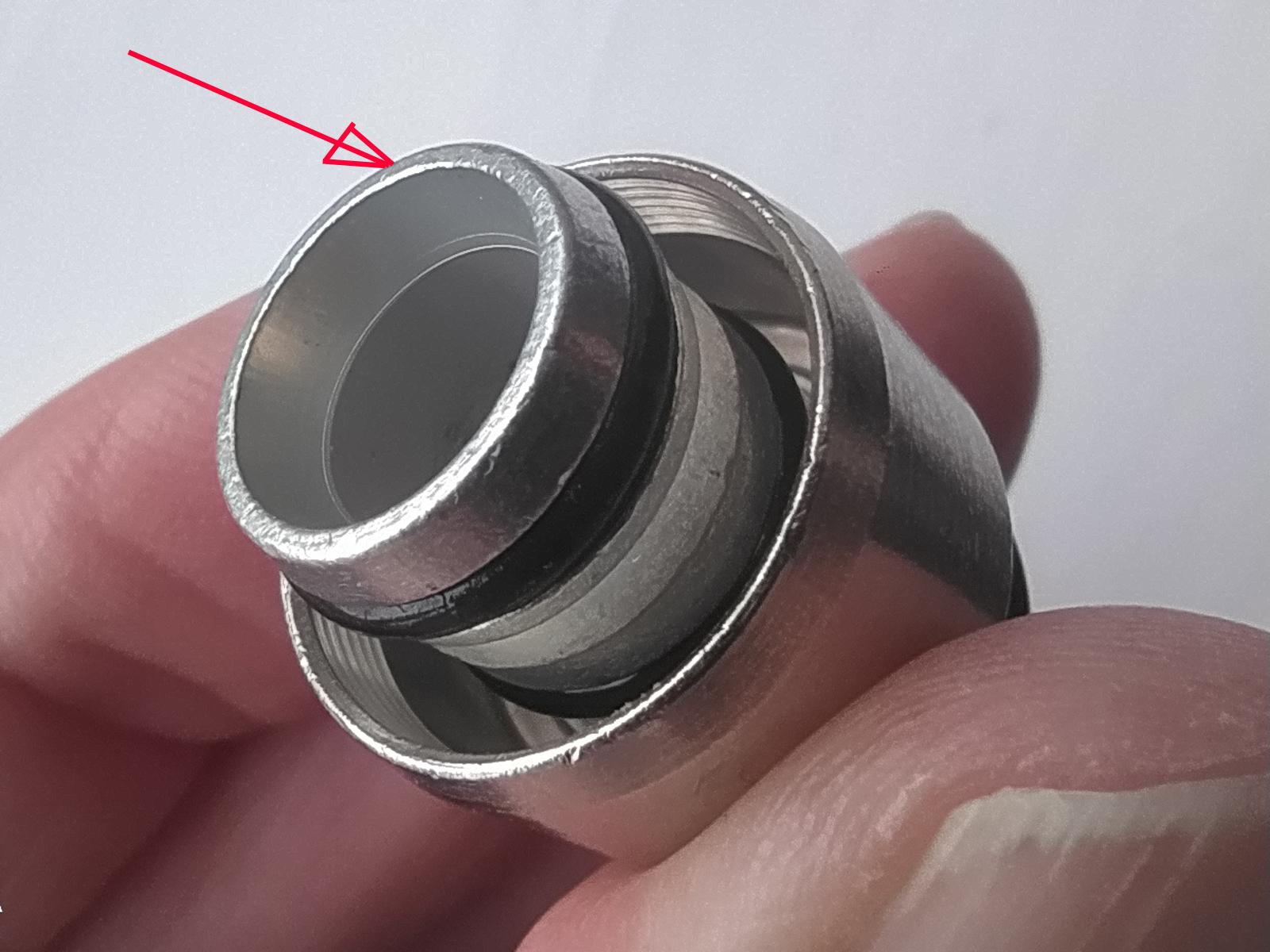

WillCram Posted May 20, 2022 Share Posted May 20, 2022 On 20/05/2022 at 16:18, dpmiller said: @WillCram just check the length of the bits- is there any chance the adaptor crimps down onto the pipe as it's tightened? Expand Hi, I was wondering that, but the compression 'edge' seems a bit too thick to be effectively compressed, especially when comparing it to a typical olive (See attached pics). I take your point though. The split olive, when fitted, doesn't actually allow the nut to bite the thread of the opposing part, so clearly (it now occurs to me) that the olive is not required. I guess there's only one way to find out. I'll have to try and tighten it up and see what happens! I'm a few days away from doing that though, so was just really ensuring I understood things before I got to that point. Cheers, WIll. Link to comment Share on other sites More sharing options...
WillCram Posted May 20, 2022 Share Posted May 20, 2022 On 20/05/2022 at 17:01, WillCram said: Hi, I was wondering that, but the compression 'edge' seems a bit too thick to be effectively compressed, especially when comparing it to a typical olive (See attached pics). I take your point though. The split olive, when fitted, doesn't actually allow the nut to bite the thread of the opposing part, so clearly (it now occurs to me) that the olive is not required. I guess there's only one way to find out. I'll have to try and tighten it up and see what happens! I'm a few days away from doing that though, so was just really ensuring I understood things before I got to that point. Cheers, WIll. Expand Sorry, just realised that I've pointed out the wrong surface in the first pic. It is of course the 'rim' that's closest to my fingers. This may in fact compress as the nut is tightened. Link to comment Share on other sites More sharing options...
WillCram Posted May 20, 2022 Share Posted May 20, 2022 On 20/05/2022 at 17:06, WillCram said: Sorry, just realised that I've pointed out the wrong surface in the first pic. It is of course the 'rim' that's closest to my fingers. This may in fact compress as the nut is tightened. Expand Yep, Im sure you're right now actually! Thank you. Link to comment Share on other sites More sharing options...
HughF Posted May 24, 2022 Share Posted May 24, 2022 Uponor eurocone adapters, as pictured in this post above, do not require the olive. I've used them at 7 bar with no issue. The cheaper ones do require a split olive and will come with one if required. Link to comment Share on other sites More sharing options...
Alexphd1 Posted June 16, 2022 Share Posted June 16, 2022 No olive needed with your fittings! Link to comment Share on other sites More sharing options...
