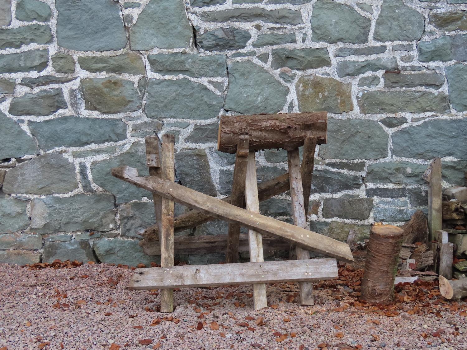

Temp Posted November 25, 2019 Posted November 25, 2019 (edited) Every hour sounds about right to me. Just a heads up.. Avoid cutting through a log into the ground. Dirt/soil really blunts chainsaw blades quickly. Edited November 25, 2019 by Temp

H F Posted November 25, 2019 Author Posted November 25, 2019 10 minutes ago, Temp said: Every hour sounds about right to me. Just a heads up.. Avoid cutting through a log into the ground. Dirt/soil really blunts chainsaw blades quickly. Agreed. That’s why I built my own sawbuck. It’s also a lot safer now. 1

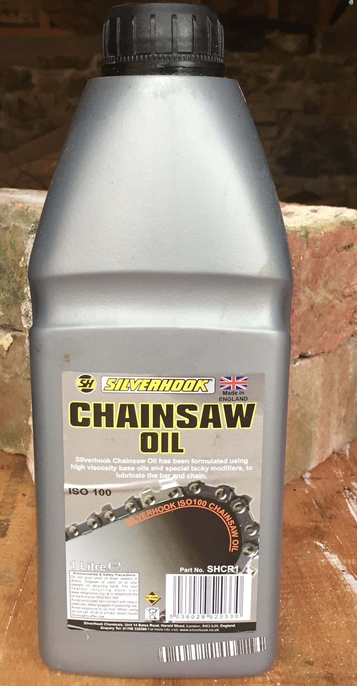

H F Posted November 26, 2019 Author Posted November 26, 2019 96 decibels on the chainsaw... in memory serves me correctly. I have a face guard/grill. I’ll start using that. This is my chainsaw oil I’ve been using. It was sold to us with the saw. It’s done now.
