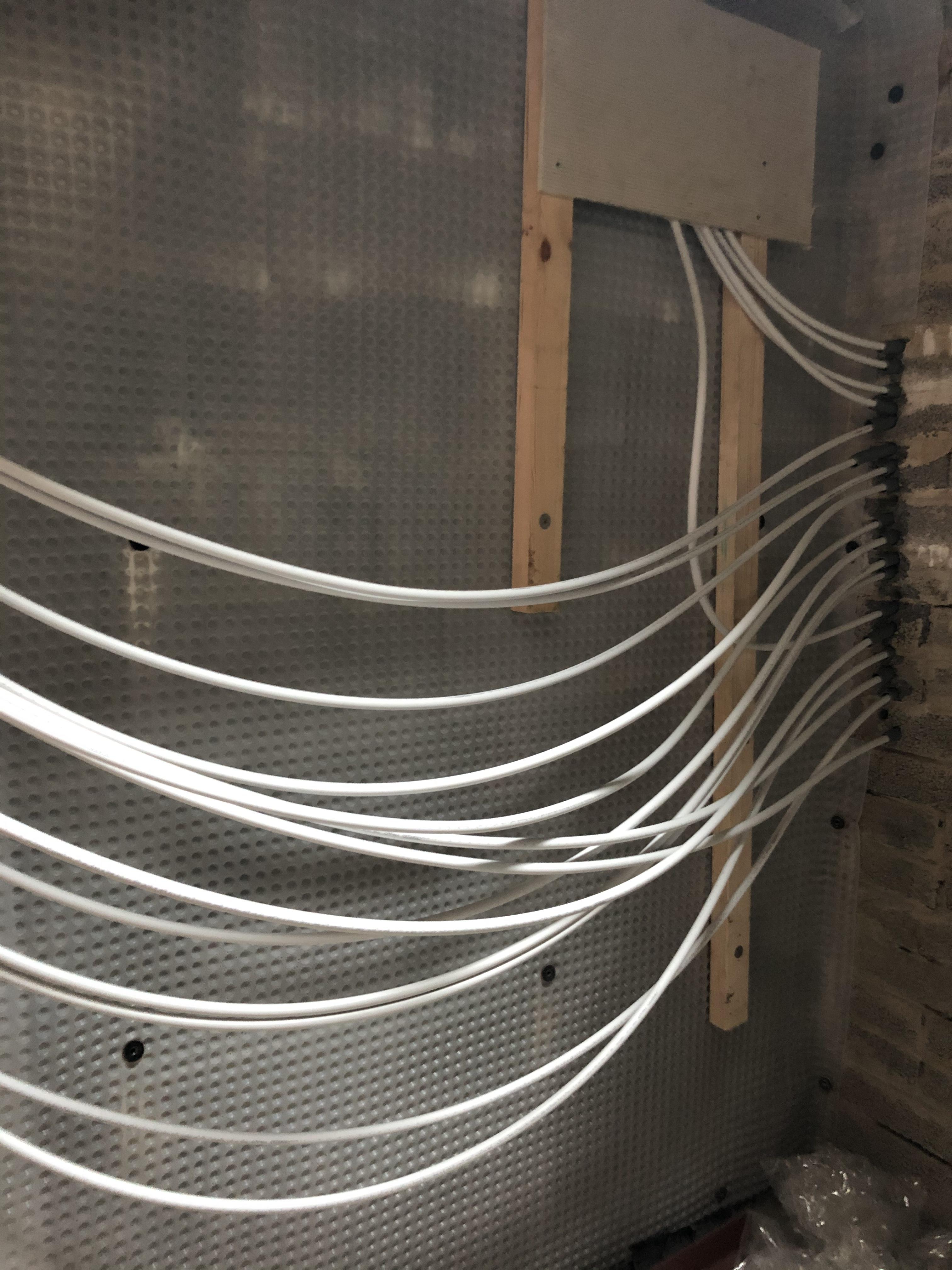

Onoff Posted November 19, 2019 Posted November 19, 2019 What's the norm for keeping pipe insulation in place, duct tape silver tape etc? I can't see cable ties being any use as they would cut in over time. Thanks.
MJNewton Posted November 19, 2019 Posted November 19, 2019 I've always found the longevity of woven duct tape to be limited, particularly in exposed environments or heat. Aluminium duct tape ought to last longer, or at least I would hope so given the reliance on it for gap sealing etc, and so I tend to use that. 1
Roundtuit Posted November 19, 2019 Posted November 19, 2019 I use cable ties, but just pulled up tight enough to grip without cutting in, and aluminium tape around the joints (not sure there's much of a benefit to that, but it makes me feel better!) 1
Onoff Posted November 19, 2019 Author Posted November 19, 2019 Aluminium tape it is then. It'll drive me nuts if it creases! ? 1
Big Jimbo Posted November 19, 2019 Posted November 19, 2019 Those pics show an area that is so tidy. I love it. You could always empty the contents of the hoover over the area to make a few of us feel better. Go on, i dare you. 1
PeterW Posted November 19, 2019 Posted November 19, 2019 I use 3M electrical tape and it stays put better than duct tape or anything else.
Onoff Posted November 19, 2019 Author Posted November 19, 2019 21 minutes ago, PeterW said: I use 3M electrical tape and it stays put better than duct tape or anything else. I think that'll be more forgiving and enable a neater job tbh. Finding it tricky to squeeze the gap closed over the bubble bend especially.
PeterW Posted November 19, 2019 Posted November 19, 2019 You need to do a crocodile cut in the back of the insulation. Take thin wedges out of the inside of the curve to make it conform to the bend. 1
JFDIY Posted November 20, 2019 Posted November 20, 2019 Or put it on then twist it so the slit is at 90 degrees to the bends, stops the pipe trying to poke out.
Onoff Posted November 20, 2019 Author Posted November 20, 2019 2 hours ago, JFDIY said: Or put it on then twist it so the slit is at 90 degrees to the bends, stops the pipe trying to poke out. I'm doing that but this thick walled stuff is a bugger to get around the formed bend I'm finding.
Cpd Posted November 20, 2019 Posted November 20, 2019 10 hours ago, PeterW said: You need to do a crocodile cut in the back of the insulation. Take thin wedges out of the inside of the curve to make it conform to the bend. this is the way I do it, quick work with a sharp knife.
PeterW Posted November 20, 2019 Posted November 20, 2019 3 hours ago, Onoff said: I'm doing that but this thick walled stuff is a bugger to get around the formed bend I'm finding. it won’t sit properly unless you cut it
Jeremy Harris Posted November 20, 2019 Posted November 20, 2019 I opted to use armaflex pipe insulation primarily because it goes around bends easily and generally doesn't need taping in place much. The only downside with it (apart from the price) is that it can be fiddly to remove the backing from the self-adhesive areas in tight spots. The adhesive seems incredibly sticky, too, so you don't want to remove the backing until the stuff is neatly in place.
